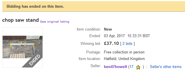

Well I missed this bugger...

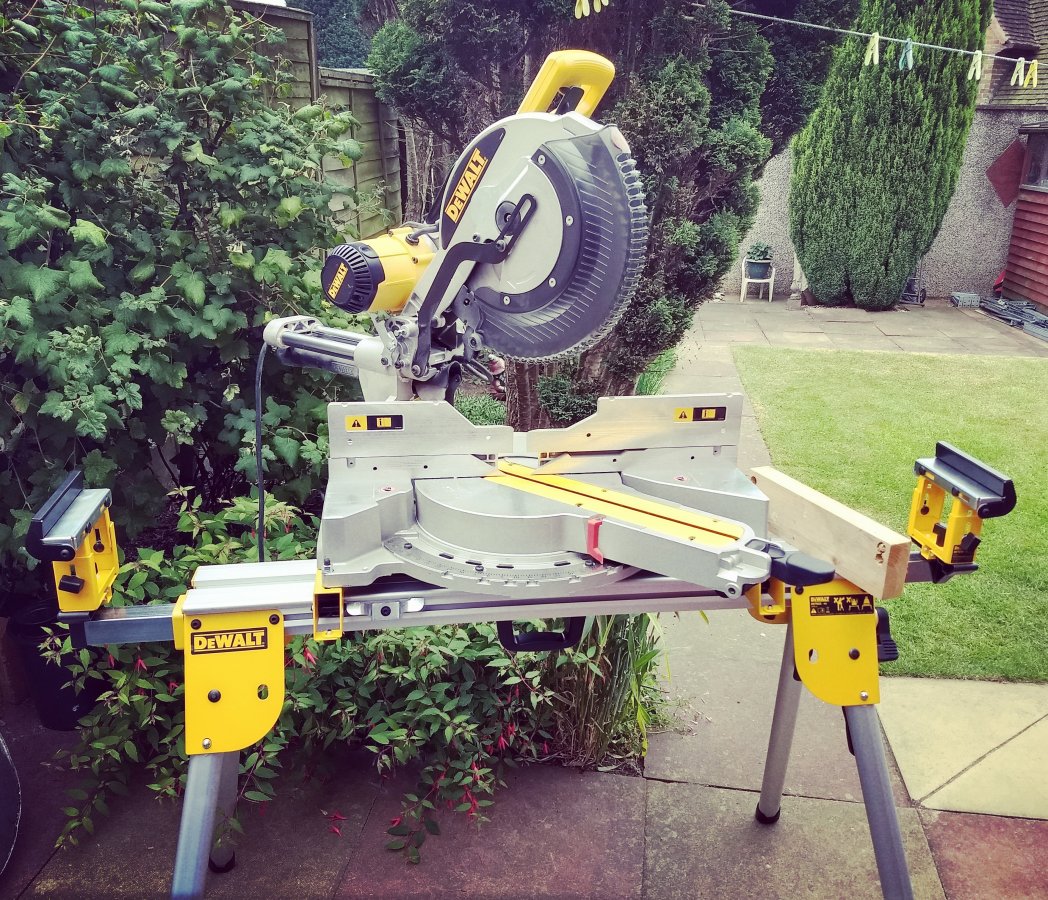

Finally got around to getting myself a DE7033 after looking at cheaper alternatives I thought at £119 can't really say no... and even my 780 fits!
