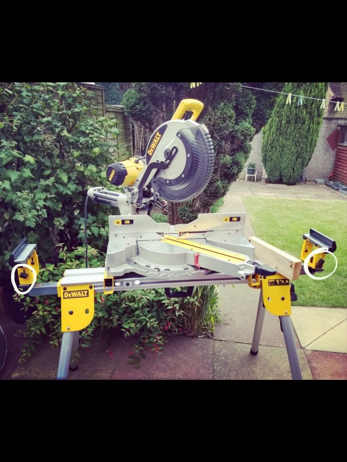

I've got the longer one and it is quite heavy but needs must as they say, it's a great sturdy stand and I doubt you'll be disappointed, the only thing to watch out for and it certainly kept happening on mine was the thumb screws for the height adjustment for the end stops kept coming loose while in transit, no matter how hard I tightened by hand they would always work loose to the point I lost 3 screws and ended up buying some other type

So I dug out the luggage scales out of curiosity and my saw with the mounting brackets for the stand weighed just shy of 30Kg and the stand was just shy of 14Kg. I think the dodgey estimate I gave might be down to how cumbersome it is. It's not easy to manoeuvre through door ways or up and down stairs so that might be where the bias lies.

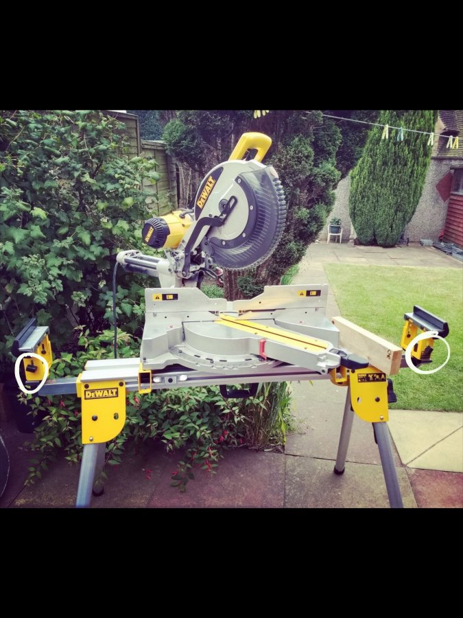

I'll bare that in mind, cheers. I did think about replacing them or at least getting some of the wide roller bed attachments for when I eventually get some mounts for my metal cut off saw; but for all of them I thought about replacing the standard thumb wing screw for a bolt and nylock nut. Once the height is right it shouldn't really need to be changed anyway.
