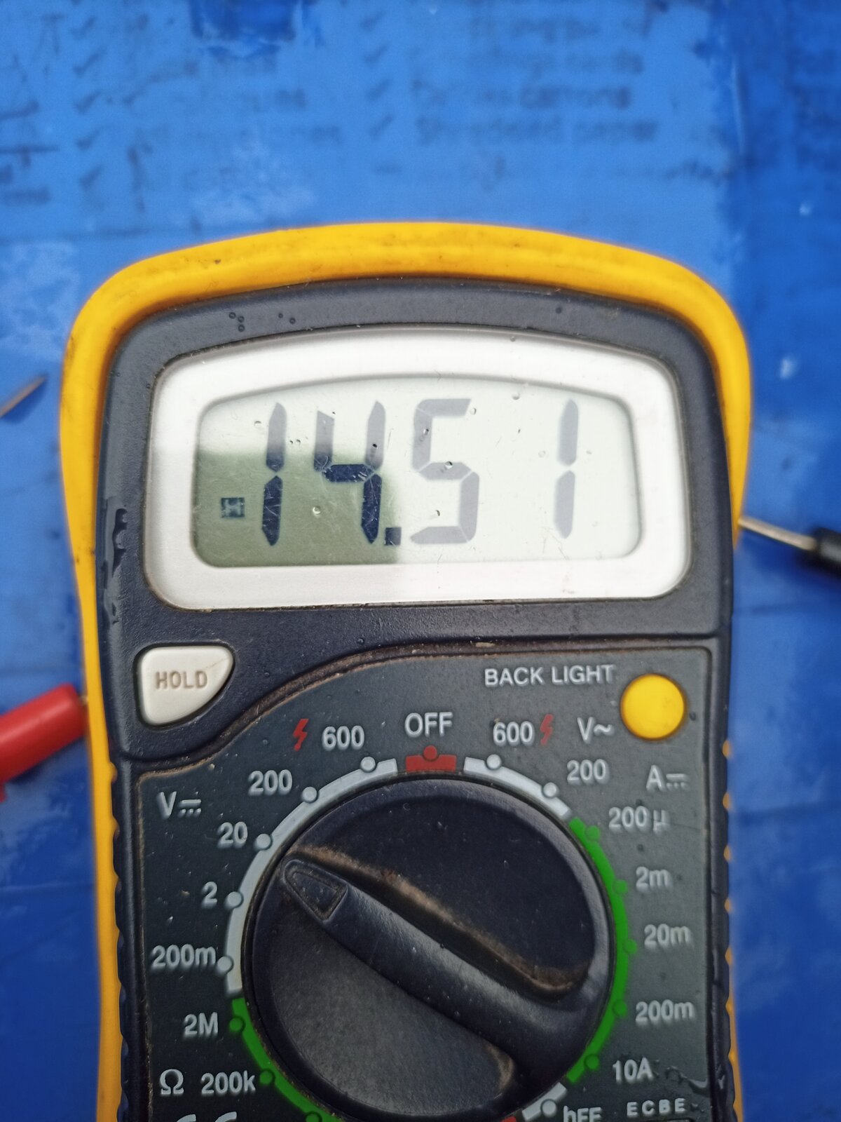

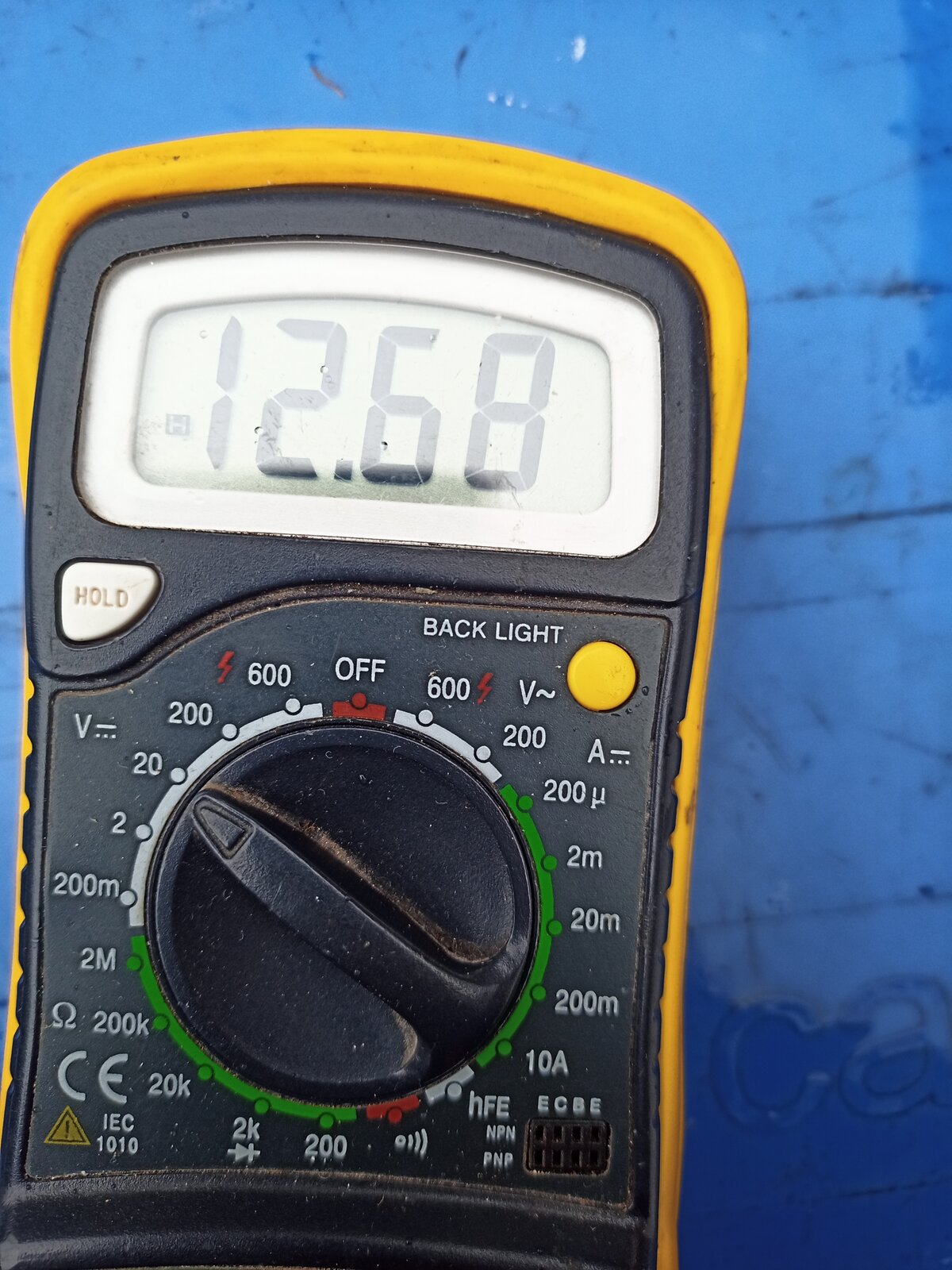

Have you checked the voltage across the battery with the engine running?
John :)
Left it till this morning.
The first was after a night on the drive, car not used since 1700 yesterday.
The second was 2 mins after starting the car.

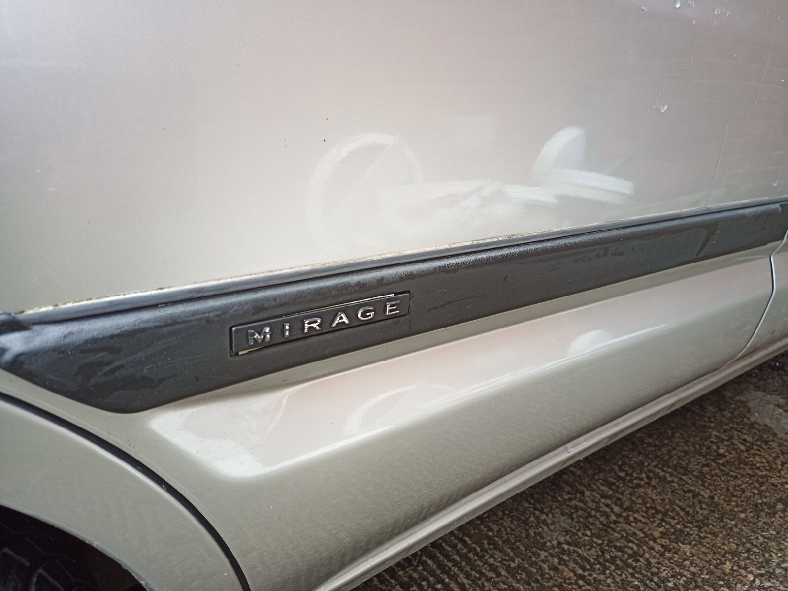

Just thought I'd post a pic of the reassembled and installed rubbing strip.
Nice to see the paintwork is so glossy after 17.5 years that it reflects the pile of garbage on the drive.....:oops:
Those voltage readings are spot on, and it shouldn't fall much below 11v when cranking.
That sure is a well built vehicle, and worth hanging on to - you've sorted it well!
John :)
