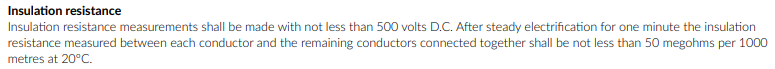

I've just looked at lot of specification/data sheets for CW1308 / CW1308B cables and somewhat surprisingly (perhaps because of the intended application), I have found no explicit mentions of 'voltage rating'. However, I did find this ...
Those criteria would be regarded as a 'pass' for any cable carrying LV in an electrical installation - so, if that is typical/true of all CW1308 cables, we are perhaps discussing a non-problem?

That would seem to provide suitable for mixed use, however the test figure and the specified figure are not the same thing.
One only has to compare with climbing and lifting equpment and the required test methods and figures.
That said it's a very different safety margin requirement.
Agreed - but, as I said, the specifications / data sheets seem uniformly consistent in not 'specifying' any figure for 'voltage rating'. In the absence of that, I think all one can do is draw one's own conclusions from the test which at least one 'specification' says that the cable has to pass.
