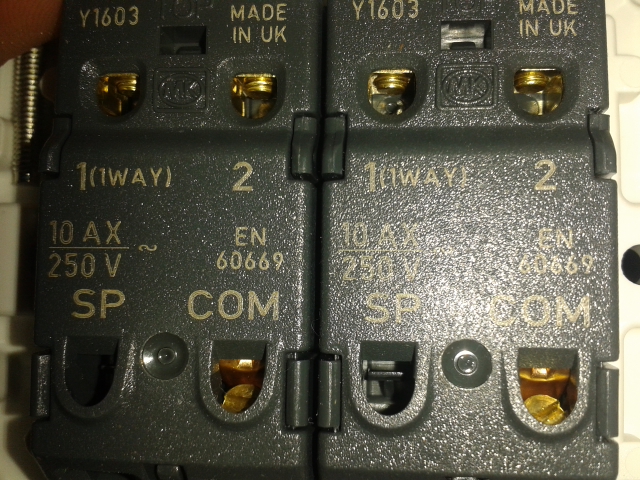

Hi running a mk double 2 way switch to a socket.
Sswitch has 4 terminals at each side. (8 in total).
Each bank has a com . Sp ( no terminal inside). 1 (way), 2.

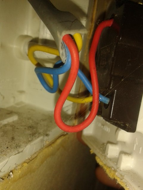

My old light switch has 3 wires. Blue. Brown. Yellow. And is in room that has two light switches to one fluorescent light.. .
On the new switch I presume the yellow (switch)goes in the 2. blue (1) and brown (com).

Switch has 4 terminals at each side. (8 in total).

Red, Blue and Yellow.
The relevant Com will be the one OPPOSITE the 1 and 2; not the one on the same side.
It should be wired the same as the other switch which operates the same light.
The other side will be used to run a 5amp socket.
That's not possible. The black wire is not a Neutral. It is being used to send power to the light - a switched live.
Neutral is the name given to the conductor which completes the circuit from a load back to the supply.
It is not simply a name for any Black or Blue wire.

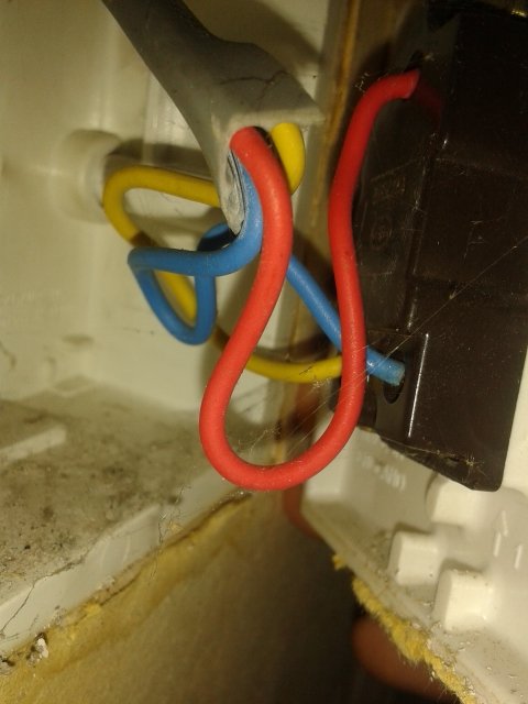

Yes red yellow and blue. And taking the neutral and earth from the fcu.
Heres a pic of wires .
And one of double switch .

Connect 2 gang way switch to existing one gang switch. Contains 3 wires red.blue and yellow (see pic in previous post).
I assume Red is hot, blue switch and yellow for two way switching. ( got two switches in room to control one light).

Hot is an American term. We call it Line.
All three are hot some of time.
I want to run a socket from the other switch. Take power spured from socket to 5a fcu. Then run a 1mm cable up to switch . But join the neutral and earth together , then run to socket
You cannot. There is no neutral (see answers in previous post).

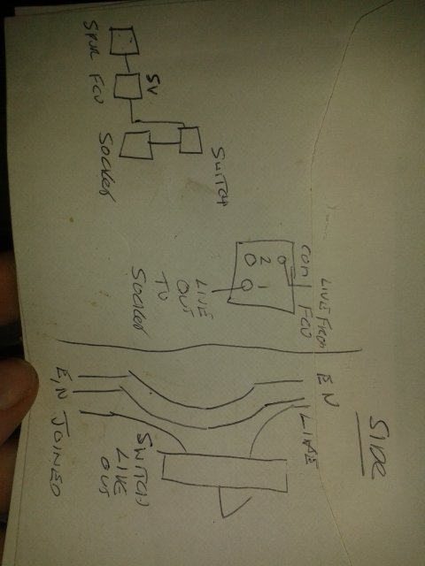

Thanks for answer . I was going to just switch the live through the switch and take the neutral and earth from the fcu that will be powering .the switch
Join the neutral and earth to the cable leaving box
So when it gets to the socket l, n, and e will be connected to socket.

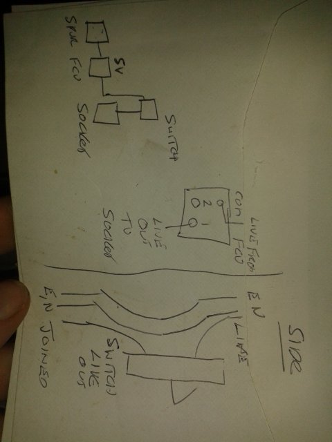

Picture of proposed wiring.
As you can see the earth and neutral from both cables are joined together in box.
The switch is to switch the live.
So cable from fcu to switch com (only live connected, ). And cable from l1 only live connected.
Then all 3 wires connected to socket.
Please excuse the rough drawing .
Ah, so the others were right.
Yes, that would work but -
the socket that you call a spur - if it is actually already a spur from the ring circuit then not technically correct without another FCU (13A) before it, or you could replace it with your 5A FCU.
If, though, it is a socket on the ring circuit or a radial circuit then it's fine.
Cable should be run horizontally or vertically from accessories.
