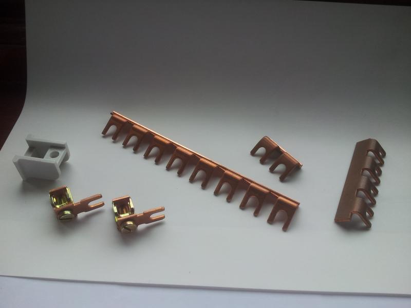

MK LN Bus Bar
The fork ones above are the first generation sentry, made by siemens and the other bits are part of a retrofit kit to connect the second generation finger busbar sentry mcbs into the older fork busbar units , there is a third generation since then, possibly even a fourth
forget LN parts they are the range after yours
the bar you want looks like a second generation mk5590s
Ps Its not the same as a K5590

If the screws line up you can possible install a generic forked busbar thus. This was on a Wylex board to accept a Wylex fuse carrier, which could be attached by no other means.
View media item 65328 View media item 65330
This photo isn't of the fuse carrier btw, but shows how the two Wylex breaker types (new and old) line up, and therefore may be bussed using the same method.
View media item 65329

In the bottom pic of the Mcbs; is the one on the left an NHX?

The 1996 catalogue cleary shows a 5590s as the L shaped bar you want.
The mains finger prong is set for mk and other makes are unlikely to be the same.
what is the part number of the board or the mcbs currently fitted

The MCB part numbers start 59 and rcbos 69
I think the board is from 2001
Yes there the second generation range, before the "K prefixed ones.
They were alsothe same mould as merlin gerin C60 range
i quess its just a case of trying to locate old stock im afraid
Yes it is, that's the bit I couldn't remember!
The busbar is just a generic bar from the internet, rated at 80A. The fingers fit fine on a range of breakers - there's not too much different between manufacturers when it comes to specifying screw size.

I am after a short busbar (twin finger) as described by Sureitsoff. Does any one have any off cuts I could purchase.

Thanks MFarrow for you suggestion. I am in the process of contacting the ebay seller to see if his item is a match.
Unfortunately that busbar from ebay was not MK and he wanted a lot in delivery charges.
If any one else has a busbar llike these below - let me know.

I've got a forked busbar in the van, but it's straight, not bent at the bottom.
Like the single phase one on this link.
If you think it might fit I can measure it
