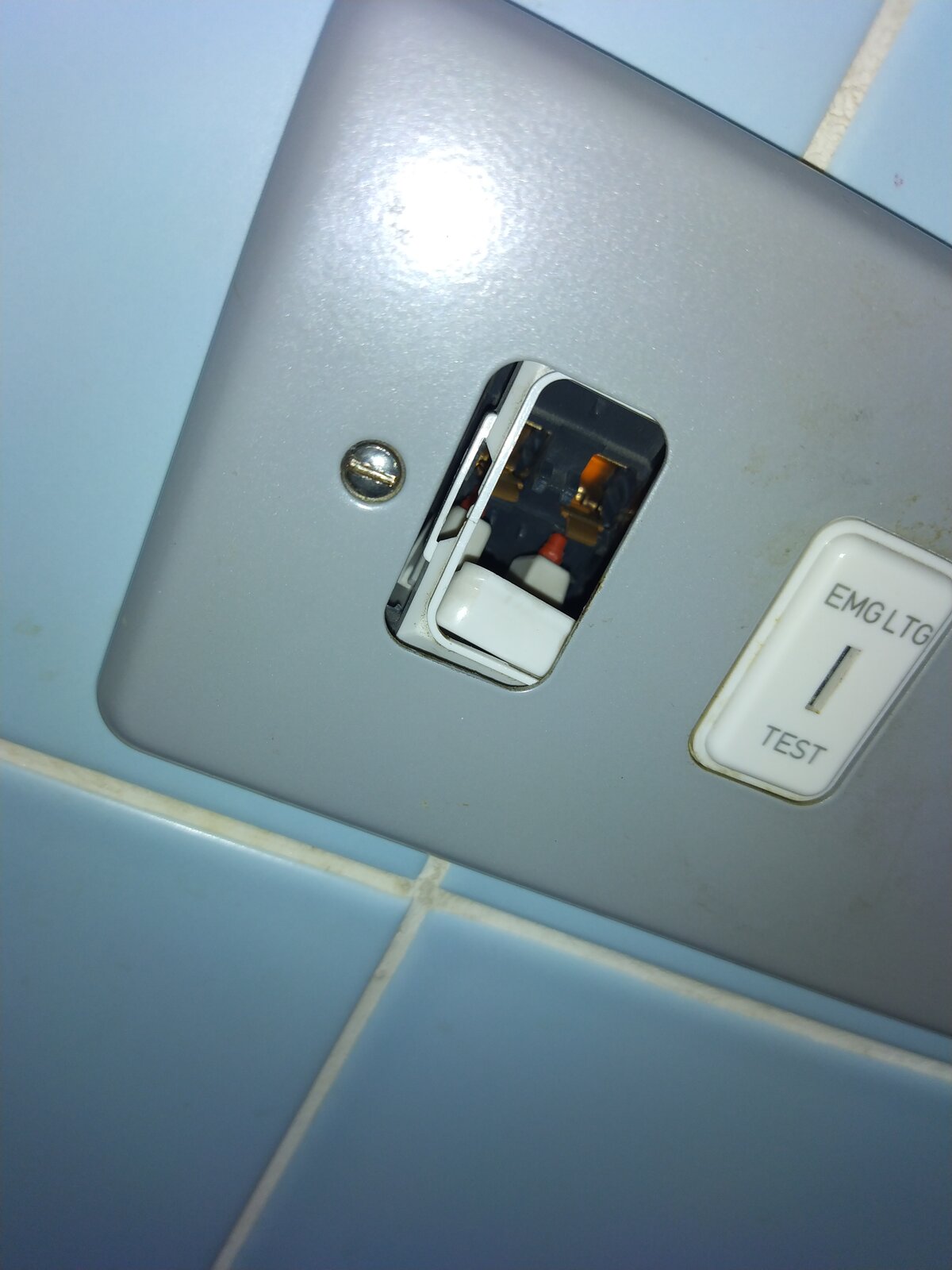

I have a dim view of MK Grid stuff. Working in a high school where most of our accessories are MK Grid metal clad my experience is that they can't withstand much abuse at all. With a relatively small amount of force the clips break and they get pushed inwards out of the frame.
We've also had an unfathomable amount of the momentary push grid switches fail including one where the whole plastic rocker part popped out of the module and exposed live parts! And that was in a staff toilet, so no deliberate abuse by students.
The key grid switches have a high failure rate for us too, including the white plastic top parts which seem to just crack and disintegrate for no reason.
Because of my own experiences MK is never on my list of brands to purchase if I ever need to buy something. Expensive garbage and I can't believe people keep buying it.

I too spend lots of time replacing MK grid switches in a school
Found an old photo I took of the switch in question before it was replaced.
So the rocker didn't pop out as I thought, it sort of 'fell in'.
But as you can see, quite a dramatic failure from a switch sold by a company that probably regard themselves as market leaders.
