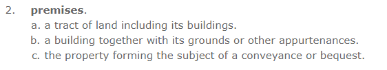

I suppose the dictionary definition BAS has found might strengthen the suggestion that it is meant to.
That depends how you read it.
Does that not mean 'premises' only applies to buildings occupied by a business?
However, this definition is clearer and does state out buildings are included.
Although - that does not mean it was the intention as per my comment about the London FB and cowsheds and also the wording of domestic (household) premises.
Would the (household) insertion exempt sheds?
That depends how you read it. ... Does that not mean 'premises' only applies to buildings occupied by a business?
I initially thought that, and therefore wondered whether "domestic premises" was an oxymoron, therefore invalidating the regulation in question.
However, since that would make no sense, I then noticed the last bit of that definition, which says "... OR considered in an official context" and suspected that we were talking about an 'official context', which would therefore include domestic.

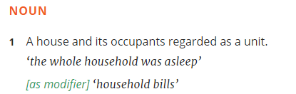

Ok. To both of you. What about household? ...
That sounds about right, - but, when used as a 'modifier' as they call it (how does that differ from an adjective?) to the word "premises", does that result in a different meaning from when "premises" is qualified by "domestic"?
Kind Regards, John
Doesn't matter.
As soon as you include the word "premises" you extend the scope to the land and outbuildings
Doesn't matter. As soon as you include the word "premises" you extend the scope to the land and outbuildings
Provided that it is "in an official context". Otherwise, the presence of the word "premises" seemingly would, per the definition you're quoting, preclude it (including it's land/outbuildings) from being anything other than commercial.
