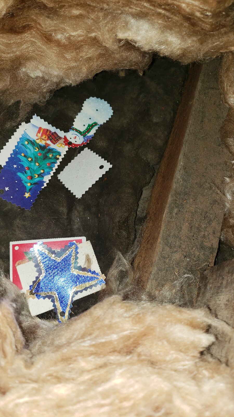

More condensation after vents
maybe should have taken a better photo seems like only about 2 inches on the 1st layer of insulation.

To the OP, I think the main goal is stopping any house air getting through to the loft. A bit of surface condensation will dry out, but it shouldn't be building up anywhere (ie dripping anywhere or soaking through)
yeah its not affecting the insulation as far as I can tell. I'm still seeing it on the nails last night.
The 1st layer on insulation seems to only be about 2 inches thick. there is a top layer too. maybe its inadequate now?

Just for clarity, you need to seal the ceiling to make sure no air can get through "air/vapour barrier", however, counterintuitively, the less actual insulation you have, the better for condensation, as the warmth will dry out the loft a bit.
Concentrate on the sealing around holes, gaps and hatches, and worry less about the insulation itself.
