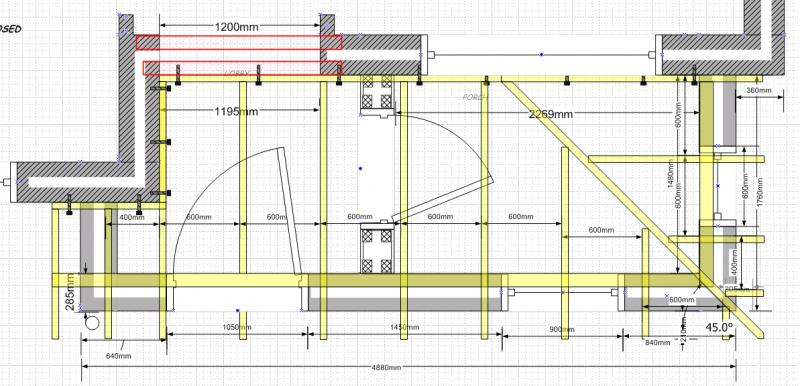

This is the plan view. As you can see the porch is set into a dog-leg in the front wall, and therefore it has a hip end on one end, and a tiny gable end on the other.
You'll see that my commons are spaced at 400mm centres which I've now discovered is over the top!
Gary

In the meantime revise yer roof plan. Yer hip rafter as shown is running about 38degrees and it should be at 45degrees. What you have now is unequal pitch. Will cause you shed load of problems. Have your comic right at the start and you can’t go wrong.
Dare say you had your reasons to hip end, but you have made a lot of work as against straight gable. Plus it may not look balanced.
When drawing revised, delete existing drawing and put new up. Will give me something to look at when putting things together for you.
old un.
Exactly what i was about to comment on.. your adding more complications for yourself
The hip end was purely an asthetic decision to match the existing house roof (semi with hip ends) The mini gable end should measure less than a metre and be covered with creeping plants so I'm hoping it'll look good :)
This is the revised plan - with tidied up 45 degree hip rafter, and revised spacing to 600mm centres.
Another question - would you use any kind of special hanger for the hip rafter, or just nail it in?

Where the hip rafter lands on the corner of the wall plate you will need to cut the wall plate so that it gives you a 45 degree abutment so that the rafter plumb cut can sit snug against it. Even some of the masonry below may need a chop depending how deep the hip rafter is.
