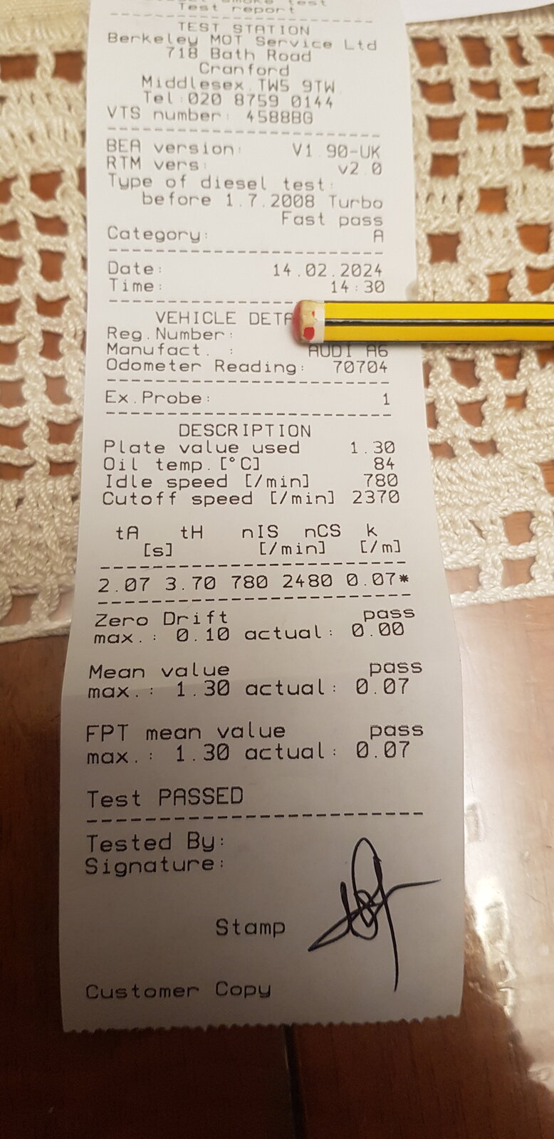

Had MOT done yesterday and, forgive me if I am not very good with numbers, but the limit of my diesel test is 1.30.
My "dirty" car has spat out 0.07.
I used 3 search engines and 1.30 seems to be a number a lot bigger than 0.07.
I find this strange.
Should I trust the internet?
Also, I asked my engineer friend and on top of his head he said my car is almost 95% cleaner than the limit set at factory (limit taken from chassis plate).
He's probably just making it up.
How come do I have to keep my car under a cover hoping for the emperor of Londinstan to fall?

I find this rather confusing. Is the 1.30 limit a value assigned to the vehicle's NOx emission? If so, your readings seem to be nearer to those of petrol (see below) - 0.07 is around 5.5% of 1.30. If that was genuine presumably you could claim your Euro 4 vehicle to be ULEZ compliant? Just one other concern: The list of readings seem to have been provided on what appears to be a supermarket receipt - is this what customers now have to accept. Usually all of the technical details were provided on a couple of sheets of A4.

Nothing to do with any of the emissions readings. All the diesel test does is measure the particles of smoke emitted. A petrol engine is tested with an emissions tester, a diesel engine is tested using a smoke meter.

Don't know, what I know is that 0.07 is 95% smaller than 1.30 and despite this the emperor of Londinstan keeps my car off the road.

It means that even with faults and a badly worn engine, it still has a good chance of getting through the emissions part of the mot test.
The test is set at a low bar

Power of the vehicle isn’t relevant for ULEZ. My mate has a 2003 Ferrari 360 and that is compliant. Mot testing doesn't test HC, PM or NOx emission readings for diesels. It just gives a smoke reading so is of no use for compliance purposes. Euro 4 and mot limits are not comparable.

Car is perfect.
Engine is barely at the beginning of its life, see the mileage on that emission test.

This is a long and complex topic.
When your car is type approved, it has to do an emissions test. That's a long and complicated test, done on a rolling road, so that the engine is under load, and with very expensive equipment. Probably costs about £5k to do the test. They measure unburned hydrocarbons (HC), carbon monoxide (CO), oxides of nitrogen (NOx), particulates and carbon dioxide (CO2). Few cars, after about 5 years old, no matter how well-maintained, would be likely to pass their type approval emissions test again.
The MOT test, is a cheap & cheerful test, with a MUCH lower bar. (It has been said that if the type approval test is like checking for the presence of a grain of sand in a black bin bag, the MOT test is checking for a house brick in a bin bag)!
Your printout is (as others have said), the result of the diesel smoke test. The meter is looking for visible smoke particles and remember, the engine isn't under any real load at the time the test is done. The type approval test measures grammes per kilometre of particulates that come out of the tailpipe during the car is on the rolling road. (In fact, current type approval emissions tests are now down to counting the actual NUMBER of individual particles that come out per km, never mind the weight)! By the time there are enough particles of smoke for the smoke meter to "see", you would have massively failed a Euro 6 emissions type approval test. In fact, any diesel that is Euro 5 or later, should read "zero" on an MOT smoke meter, because the particulate filter should catch them.
The units for the smoke test, are a rather bizarre "per metre" unit. You obviously can't use the grammes per km units in an MOT emissions test, because the car doesn't cover any distance during the test. This makes the two numbers impossible to compare directly, but whilst your car is well within the limit for its age, that really just means the limit is an incredibly low bar. If you took it for a current type approval emissions test, you would break the gas analyser! (Well, you wouldn't, but you would clog its sampling system up within the first few hundred yards)!
