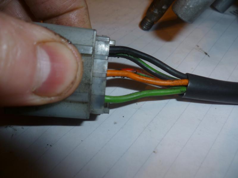

Images of motor
On the first image left-right
1) Two wires=Brown and Green
2) One wire=Orange
3) One wire=Black
4) Two wires=Red and Green and Black stripes
5) Two wires=Green and Green and Red stripes
Second image
where we have brown, red and green cables at the head of the rotor
Third Image, connector from motor top-bottom
1) Two wires=Black and Green and Black stripes
2) Two wires=Orange and Green and Red stirpes
3) One wire= Green
Looking at the commutator the negative will be the brown, low speed red, high speed green.
Looking at the connector the negative is green, low speed pos black/gn, high speed pos green/red
The other two are likely going to be something to do with the parking mechanism.
