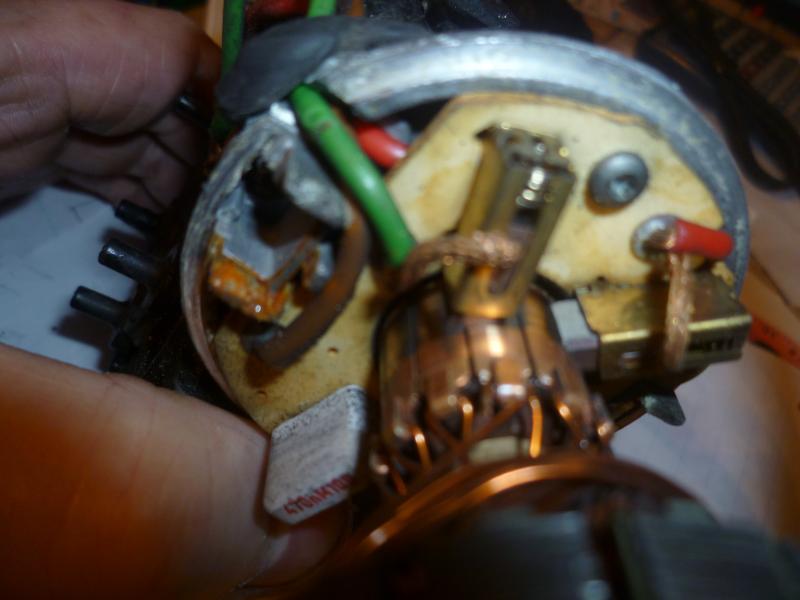

As already said, earth (negative) brown (on the first image). Red or green to positive should give you motion, but will be bypassing the auto park switch, which may well be your peoblem

Test carried otu:
Neutral/Earth to Brown core and Live to Green-Green/Red wiper turned
Neutral/Earth to Brown core and Live to Red-Green/Black fuse popped
Sorry, where are you getting the multicolored wires, Red/Green/Black?
Just noticed, what I thought was a brush is a capacitor or similar, where does the brown wire connect in the motor?
There are three carbon brushes, one is out of shot, behind the capacitor.
On photo red and green cables are terminated at brush points.
The brown disappears as shown in photo, this is the only place it is visible.
Sorry about that, I didn't see the green/black wire at the back. So you have a short either in the red circuit or in the green/black circuit. Or in the switch gear under the black cover.
The above picture shows the red wire as it goes into the brush very close to the head of what looks like a rivet? Is that rivet earthed or insulated?
If you have a multimeter measure for resistance between terminal 4 and the body of the motor, I would imagine it will be almost 0 Ohms = Short.
If you wanted to disconnect the wires from terminal 4 and see if the short is in the wires or in the switch gear under the black plastic cover, try to narrow down the problem.

But I have now convinced myself that the winding is shorting and managed to get hold of a used motor for £20. Picking it up tomorrow, so will see then, hopefully I are right.
