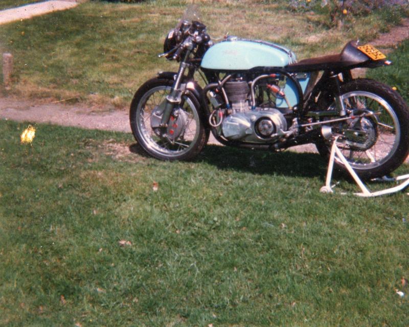

The weslake bitza
NRE 750 8 valve twin engine . Triumph gear box with a 5 speed CR cluster . Norton Wideline frame . primary belt drive . trident oil cooler. Interspan ignition.
Grimeca 4LS front brake. scitzu rev counter.
she ended up in Sweden
yes it was actually built to go classic racing , but it never happened . So I registered it for the road on a Q plate :)
The ignition system which was total loss would give u approx' 1 hour road time . Not that u would want to ride it that long.
The engine was built for me by Dave Degens (Dresda) I had a full fairing for it as well .
In the context of what it actually was , she was very quick ;) I got involved in other things (kit car) so I advertised it and got stacks of calls from abroad
Ist fella who called was from Sweden , he sent a lorry over & she ended up there. Like to beleive that some swede is waking up on a sunday summers morning in some quiet Swedish town , and shattering the silence as he guns her through the high street :)
almost straight through pipes when it went to Sweden. I do regret selling it & it took me a couple of years to build it.
look on the oil tank out let and there will be a 10mm gas tap , wet sumping was always an issue so I would turn the oil off . big noticed on the rev counter said
"OIL ON " to remind me :)

10/10 for producing such a magnificent beast mate!
Did you use Amal TT carbs on this?

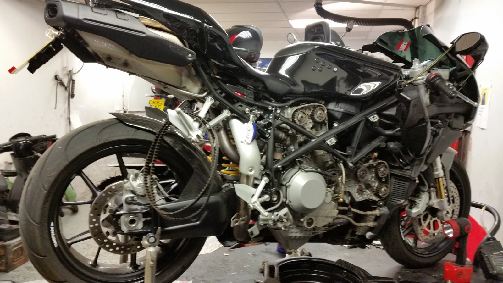

Keithmac looking at them pics and the seemingly complicated engines ect (to me)
I wonder how my old 1971 Norton actually runs :)
jeez us I look under the bonnets of modern day cars and at bikes and think were the hell would I start ?? :)
whats that black bike a V some thing ???

Got to be a Ducati, I guess with a motor like that!

no just concentrics on that one.
Think u can still buy the weslake NRE engines (at a price) they go all the way up to a 1000cc .
Dave Nourish bought the rights to the weslake twins way back and renamed them Nourish Racing Engines (NRE) used to do kits for converting Triumph engines to 8 valvers. pretty certain Dave retired way back and sold out . ?? assuming he is still around ??
There used to be a fella called Gary Bryan who raced the RGB weslake in the battle of the twins . It was a unit triumph engine with a 900 cc nre conversion in his own frame .He said it made 100bhp at the rear wheel ?? suffered gear box issues though the triumph cluster was not up to that amount of sustained power or so he said ??

The black one is a Ducati 749, yes it is a twin V.
Some of the superbikes now are hellishly complicated, fly by wire throttles, traction control, active suspension. You've got no chance without proper diagnostics unfortunately.
I get quite a bit of Italian stuff through, people seem scared to work on them for some reason?, just another bike at the end of the day..
