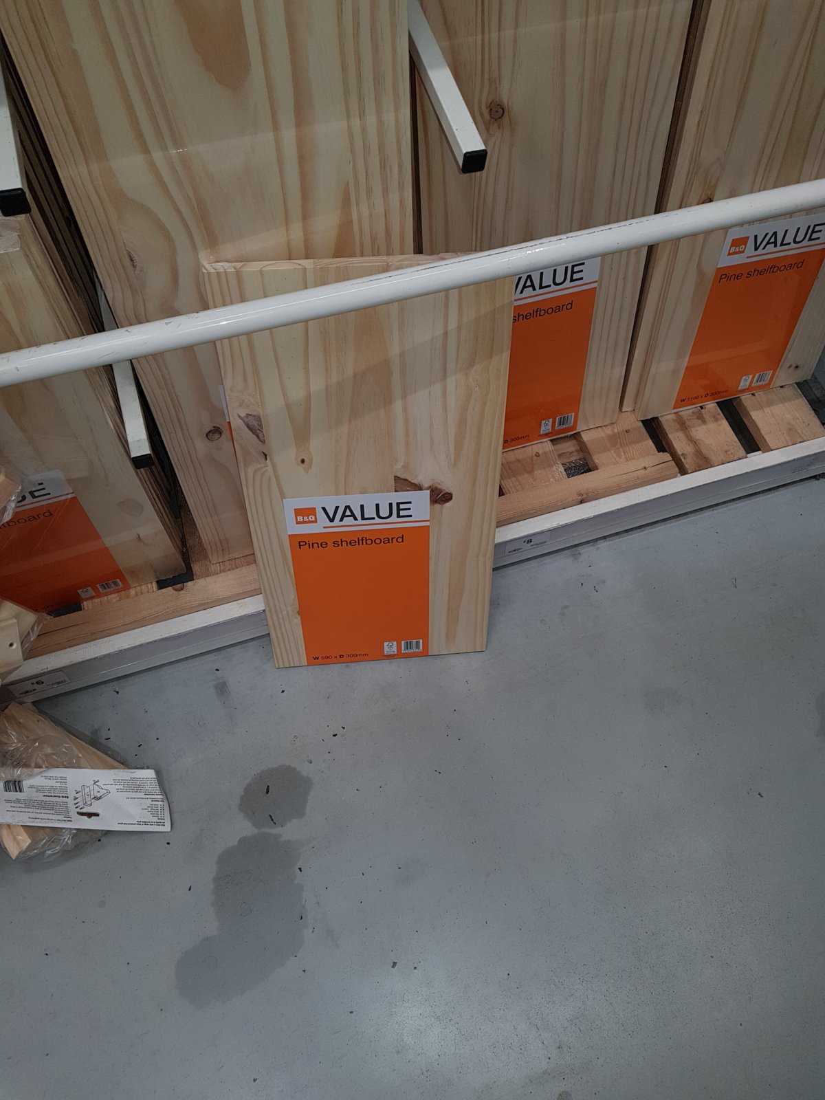

Is this stuff strong enough to attach to ceiling and hold a 17kg projector. Its only 16 mm thick though
i’d be tempted to use grip fix as well as screws. That’s how i did mine. I just painted the marine ply white to match the ceiling and put as many screws in as i could within reason.
I would definitely use ply and not shelf board - some of those boards can be of dubious quality.
