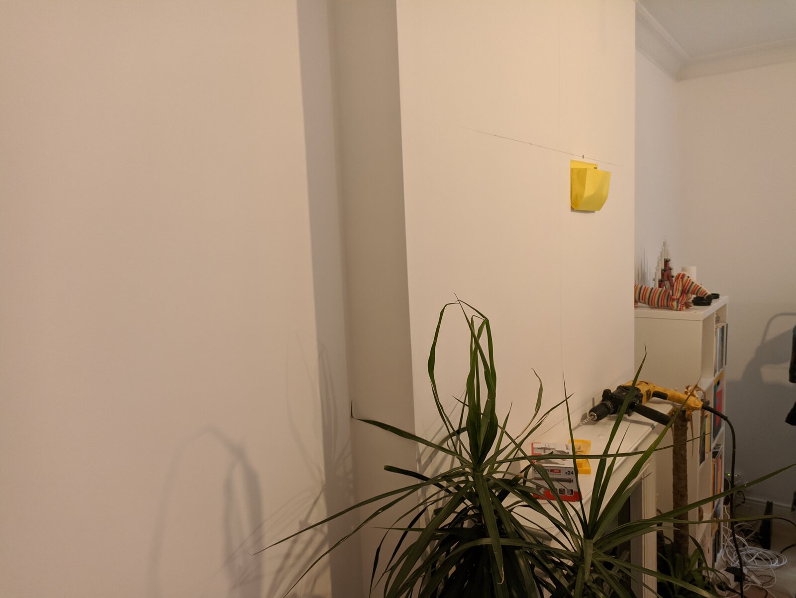

I am aware of people's dislike of above fireplace mounting, this is what the wife wants so I'll make it happen.
For some reason I thought my chimney breast was dot n dab so I went for the corefix solution.
Drilling into it however I find it is completely empty, so likely plasterboard followed by nothing (15-20 cm) and then presumably another plasterboard and brick?
There are no wooden studs or anything I think the corners are held together with metal studs.
Is there any solution here that doesn't involve me rebuilding the false chimney breast?
Could I attach some structural timber to the back wall that the TV (65" 20kg) could then mount onto?

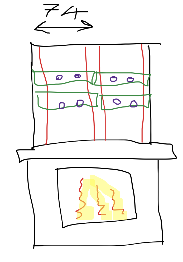

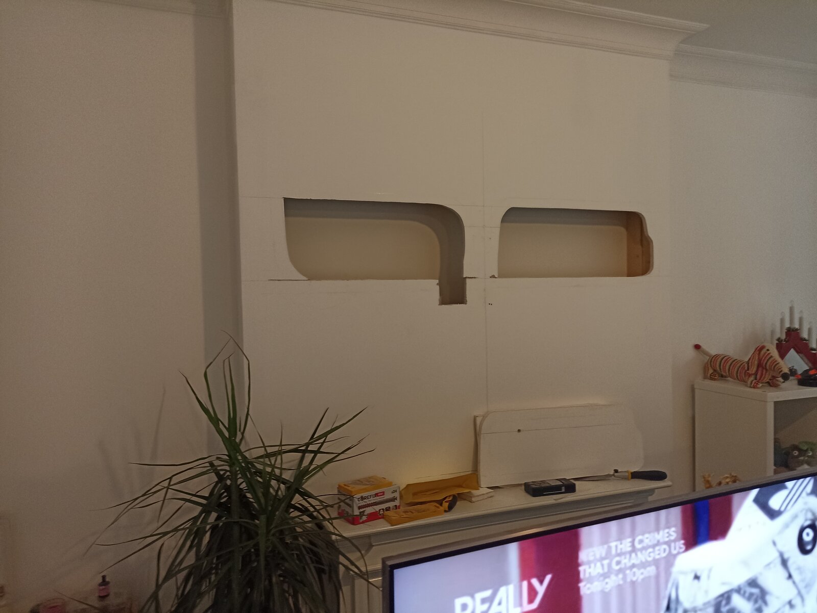

Ok I got impatient and opened it up.
There's a stud (red) in the middle and on the two edges (74 cm apart).
Would attaching two (or 4) battens, single or double (green) to this work?
This would leave 8 mounting holes.
I guess corefix wouldn't be good for this as there's no cavity , would I just use the supplied screws and plugs since I can have the batten flush to the plasterboard?

Yes, that's more than adequate.
Went for 4 battens, pretty sure each of them can hold half of my mate so we'll see tomorrow how it goes!

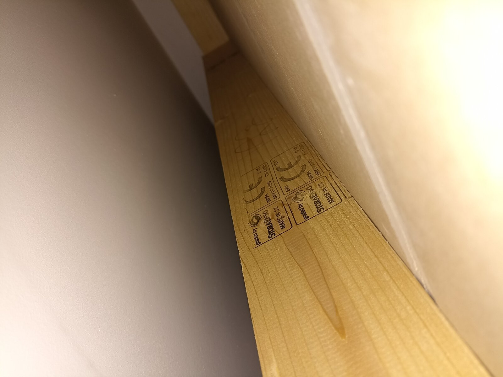

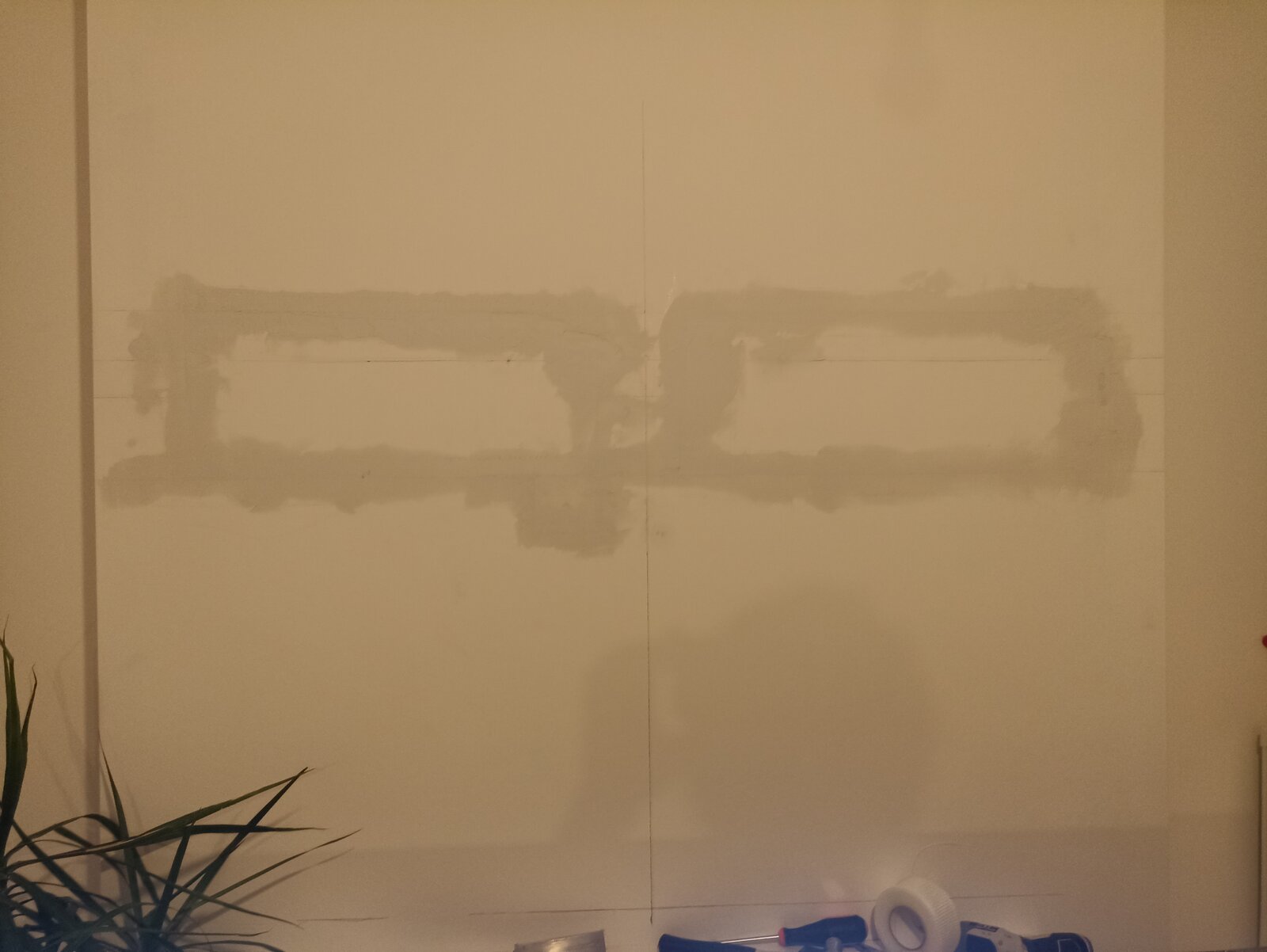

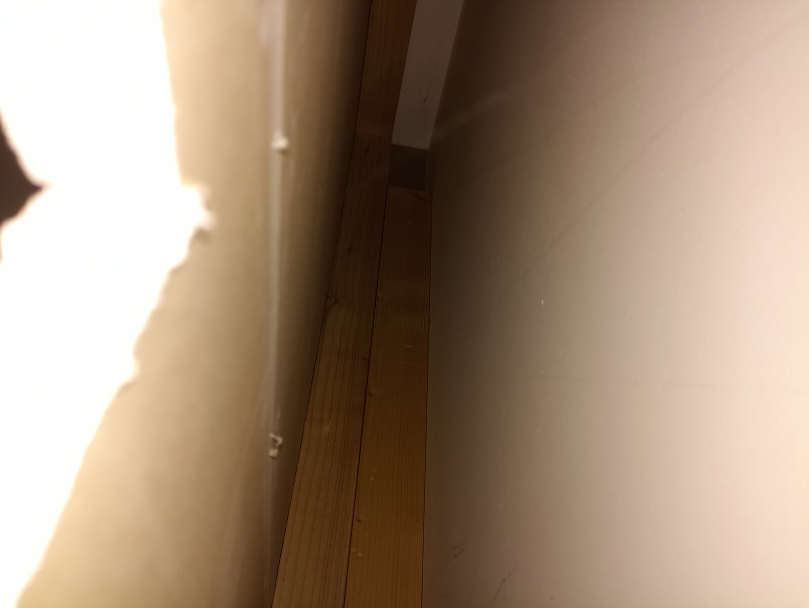

For future reference if anyone is trying to do the same.
Used 38x63mm battens (2.4m £4 from B&Q) and 80mm turbodrive screws (2 on each side of each batten).
Should have made the plasterboard hole bigger for better access to attach the screws or potentially removed a whole section, but this worked in the end.
