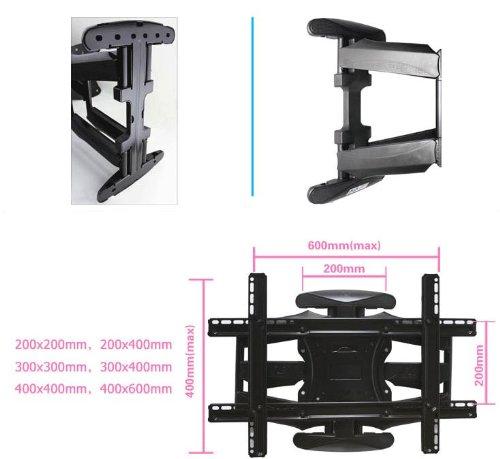

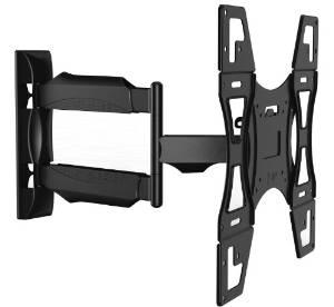

I would like to mount a 30Kg tv to a single stud on a platerboard stud wall. Its a new wall so no bricks or anything behind it.
I wanted to use this bracket.
The mount is quite narrow, so do you think this could be safe enough on single 2 inch stud?
I suppose the obvious answer is that if the makers say so, it should be okay.
Provided of course the stud it's mounted to isn't likely to fall over with 30kg of telly hanging off it!
The support bracket will sag when extended with a 30kg load.
The screw bracket is likely to pull away from the stud because it's not long enough to spread the load. In addition, the single stud probably won't take the load. Ideally, you should make a plywood plate to span at least two studs.
If you really must try it, use something inexpensive that weighs 30kg to test it.
The studs are about 14 inches apart, and have fireblocks between. Its a solid structure but how solid I dont know.
The snaptoggle fittings say they can hold over 100kg on a plasterboard wall.
This image shows its quite a span, in terms of height.

Or
This one, has a wide span. Can use the center 2/3 holes to mount to studs and the remaining 4 (top) and 2 (bottom) use snaptoggles (rated to hold over 100kg).
Snap Toggles might well be rated for 100kg. That's not the issue. The problem is that
a) there's 30kg of weight hanging off an extension arm that is, at a guess, about half a metre out from the wall. So that's about 15kg of torque trying to rip the plasterboard off the nails holding it on to the studs. That's as well as the effect of the weight of bracket and TV.
and b) the load isn't static. You'll be applying additional force (and stress) each time you move the TV.
Plasterboard is basically chalk and cardboard. It's up to you, but I wouldn't rely on fixings direct in to plasterboard and nothing else for an anglepoise bracket even for a small TV. There will be studs running floor to ceiling to form the framework to which the plasterboard is fixed. As Sam Gange said, span that with something solid, then use whatever fixings you like.
@Lucid - got it, though in the wider bracket I showed a picture of above, the center two holes will be screwed into a stud using these possibly. The remaining holes, 2 either side of the center two, will be attached to plasterboard with snaptoggles or other plasterboard fixing.
Will this make a difference?
It will help, certainly. If you're relying on just two fixings then you need to make sure you hit the mid line of the stud and pre-drill pilot holes to prevent it splitting as the coach bolts drive home.
Just bear in mind that the wall fixing plate will still want to follow any movement in the bracket. So as you swing the TV on the bracket left or right, then the wall plate will want to rotate in the same direction. It will be pushing and pulling on the plasterboard via the attachments at each corner of the bracket. The plasterboard might be strong enough to withstand that for some time, but plasterboard isn't stronger than steel.
In the end it comes down to this - and this isn't aimed at you specifically but it's a general observation of all people coming asking questions about the DIY mounting of TVs on walls - you just want the 'least effort' solution. That's understandable. No one wants to go what they think is OTT. What we'd argue here though is based on the benefit of hindsight. Those of us in the trade know what happens when a job is left half done. It comes back to bite you in the ass. That's why we don't mess about telling you what you want to hear. We just go straight to the correct answer - no detours - a direct route - BAM! We give you what you need to hear. In the end though it's your TV, your wall and your choice.
You've got a solution based on doing what we in the trade would consider to be a risky solution. I wouldn't be happy leaving a client's home with a TV installed that way. But you might be happy with the risk.

Thanks Lucid. So my idea was to place a wooden frame with 2x4 inside the wall that is what the drawing is demonstrating. Think of it as additional fireblocks into which the tv bracket will affix as well as the main stud, with 1 screw not two as in my drawing, as you suggested. But your saying just have plywood across 3 studs. Both ways mean cutting a large hole into the plasterboard. Surely what I'm suggesting can handle more weight?
And this is the new bracket, more weight distribution.
Look at your design. You're basically creating 4 cranks which will want to rotate around the off-centre fixing points, which are 3 screws. Most of your fixing strength comes from the 4 screws in the single centre stud, but the arrangement of those screws side-by-side weakens timber because it almost cuts it in half if they don't miss-align and poke out of the side walls. Now contrast that with the large ply wall plate anchored by glue and (at a guess) 15 screws (5 per) spreading the load across not one but three studs.
It's up to you. Do what you feel works. I've given you the benefit of about £80 in consultancy plus you've had Sam Gangee's assistance. He's another seasoned professional with more than 40 years commercial and domestic install experience. If you feel you have the right solution then go with your gut.
Ive amended the design slightly [see above]. Now the weight is more evenly distributed. What I'm saying is to use plywood AND a frame, the plywood will be flush against the wall and attached to the three studs and the tv bolted to the center stud and the wood frame behind the plywood... this is now solid right?
