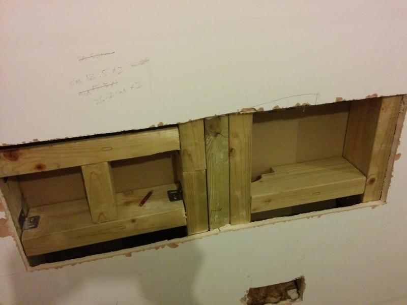

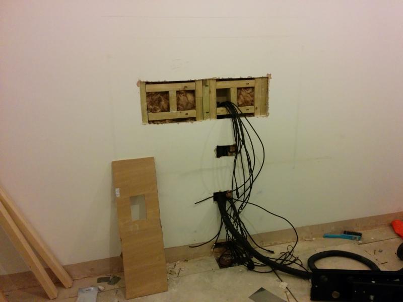

This is my checklist atm
Timber 95mm by 47mm - 4 @14 inches for the horizontal sections.
6 @ 220 minus the top and bottom (47*2) 126mm vertical studs between the top and bottom horizontal sections
8 @ 10 inches vertical to go either side of the top and bottom sections for extra weight distribution
100mm wood screws -
M8 lag bolts 90mm x10 for the bracket
12mm plywood @ 18 inches x 10 inches
And maybe smaller 6mm lag bolts to attach the plywood to the 3 studs.

The solution I am going for is more structurally solid, that is what you suggested. Its not your solution of just plywood across 3 studs. Mine includes that and a wooden frame for additional support. Not sure your problem. Also I appreciate the help you've already provided but you may not know, this is the internet and we're part of a forum where people expel advice for "free" its the whole point. Yet its seems you'd like money for your "consultancy". Again, I've taken on your advice about the bracket and changed that and taken on your advice about the structural load, and I've taken that on board!

The advice given of just screwing a sheet of ply to all 3 studs is quite sufficient. If you want to hide the ply, then chisel out the studs and set it flush (they will be stronger than before once the ply is in, if you do a neat job, especially if you glue it as well. If you are not practiced with a chisel, do not do this.).

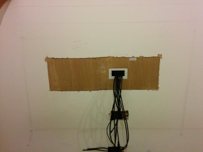

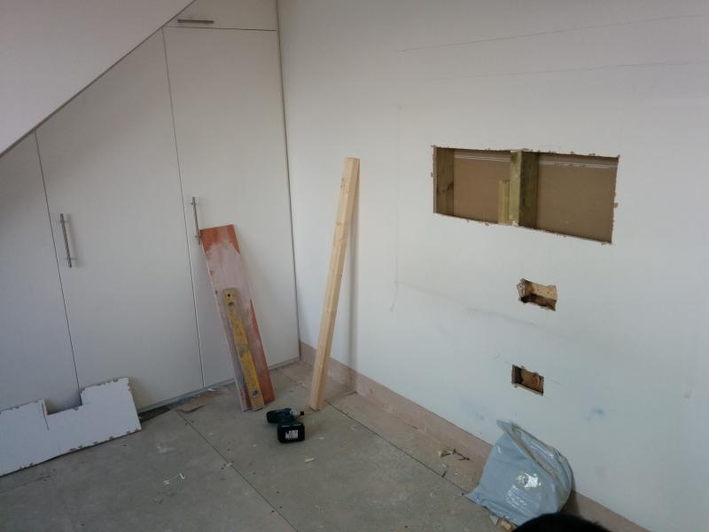

I'll be replacing the the plasterboard thats on the wall currently with the ply and so it will be flush with the wall. The idea here is to make the bracket unmovable since its only a single stud that will contain 2 lag bolts, top and bottom, and the suggestion is to use other fittings like intersects in ply (ply attached to 3 studs).
However I want 5 or 6 lag bolts into plywood (across 3 studs) and timber frame and middle stud holding the cantilever full motion bracket, which itself is 10kg and 27kg tv.

I've not ignored it, I've added to the brilliant advice from Lucid and Sam! I will be doing exactly as they suggested! But with the addition of a timber frame for the additional lag bolts I want to hold the 10kg full motion bracket and 27kg tv!

i am with the others 12mm ply across 3 studs is all you need
if you want a bit off extra then 3x2 either off the central stud to give you a 8" strip but overkill really

And would you use intesects to attach the bracket and use small bolts to attach the ply to the studs?
I mounted and 30kg tv on a cantilever bracket on no more than a sheet of mdf the size of the mount plate screwed to the wall. More the sufficient.
I imagine that was over top of the plasterboard giving it alot of strength. I plan to put it in place of the plasterboard so it is flush with the wall. Even I imagine you think its enough. And I see Lucid is in agreement ;)
I may then just put a could of 95mm across the studs instead of instead of 45. Either way I will be doing this on the weekend giving me time to think. Appreciate all the help!
