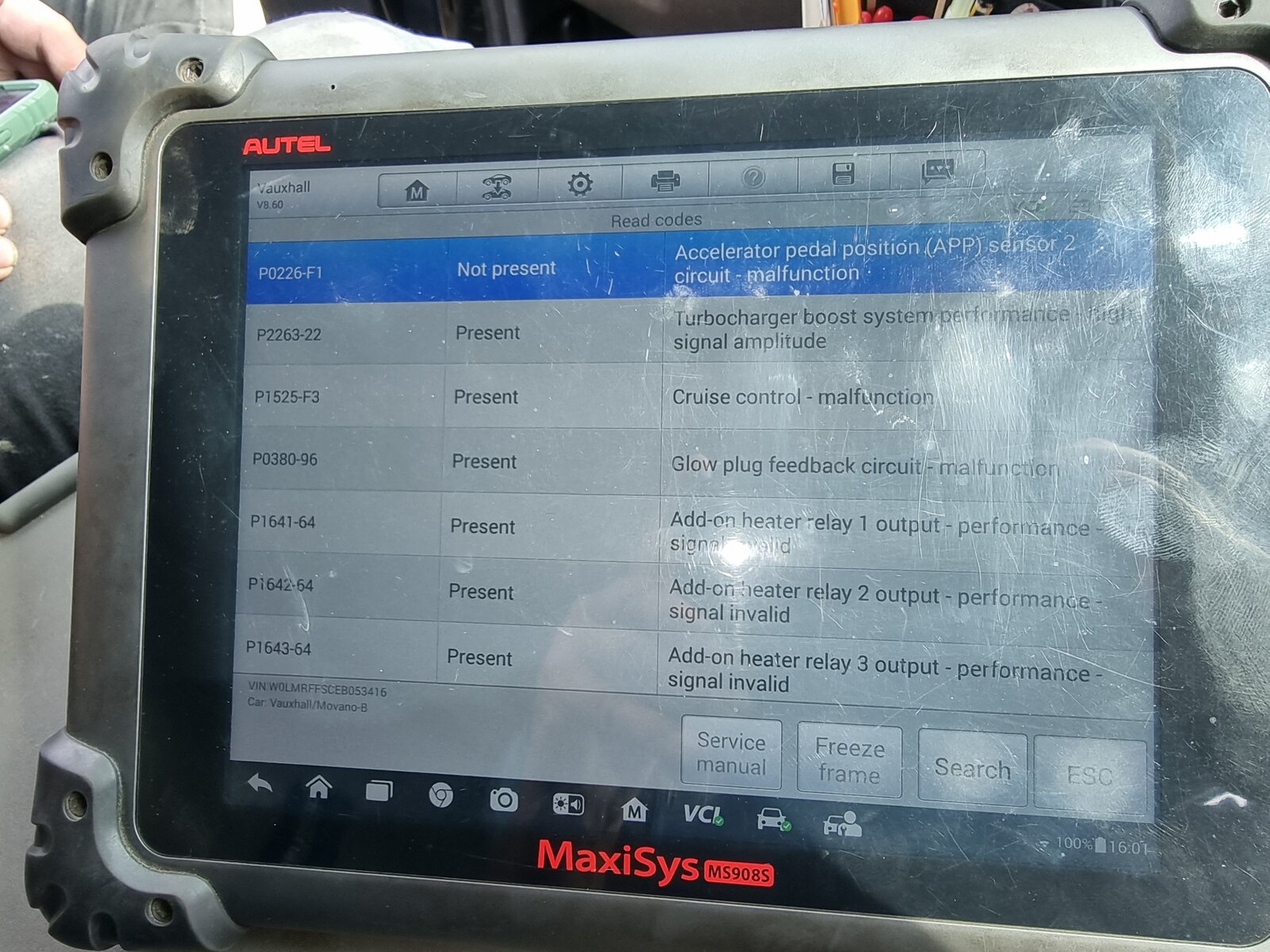

Hello John
It starts and runs OK. Going down a duel carriage way it will do 50mph no problem. Just no real power it's a bit gutless

Need to read fault codes. But I had a problem similar. Running on cruse control variable veins on turbo stayed stuck open as when on cruse control and more speed is needed ie up a incline you are given full throttle by cruse control module and this fully loads turbo causing veins to open fully and with the heat from turbo and ambient causes them to stay stuck open(carbon on veins)
Moving veins to free off and a turbo cleaner used in fuel, fault has not returned for a couple of years now .
Fault code should read low boast pressure if its this problem

Surely the technician could read the scanner???
If they cleared the dtc faults and they came back immediately (before starting engine) it's in the wiring or ecu... or not cleared properly. If the fault code returned when engine was running they could then go on to diagnose the issue. I'm not saying this could be a 5 min fix but a scanner needs to be used and understood correctly (without ripping off the customer)

I've had this on a customers turbo... I cleaned the vanes with Mr muscle... Worked a treat
Does this tell us anything

This was done as a favour. Thus garage could not fit me in. The readings I got are above. He was hoping it would reset faults , but it didn't work.
