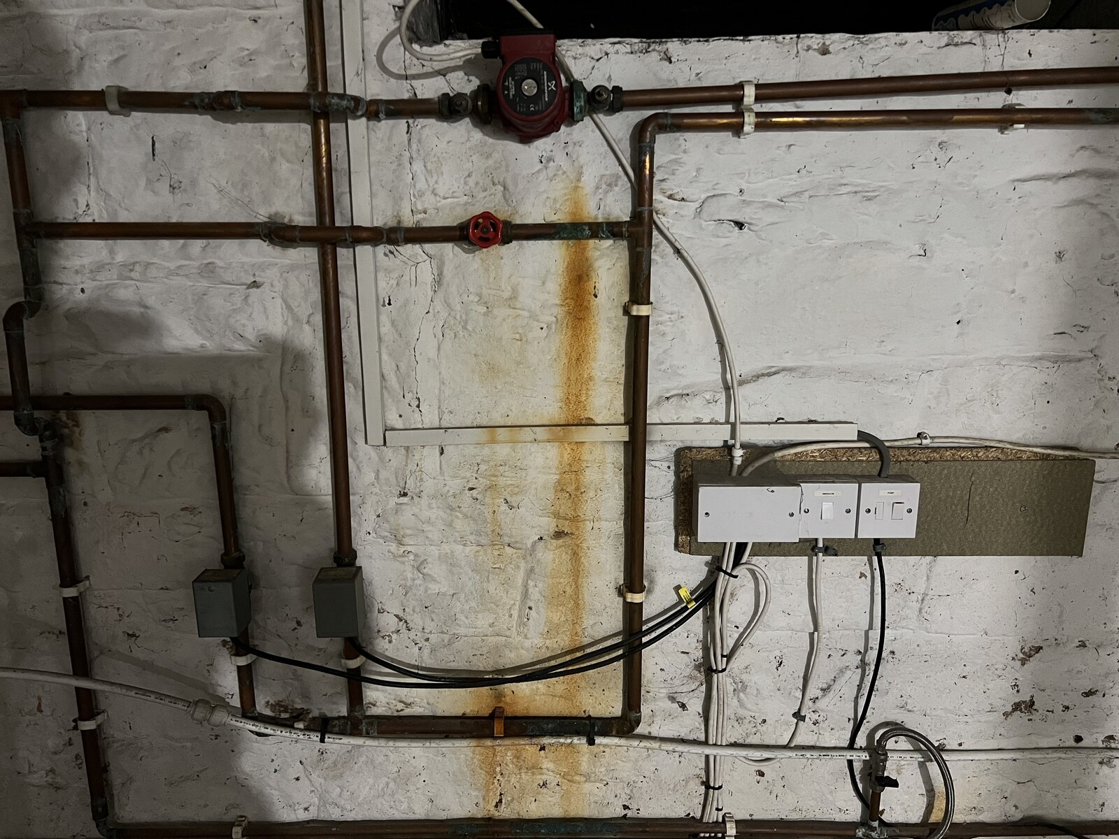

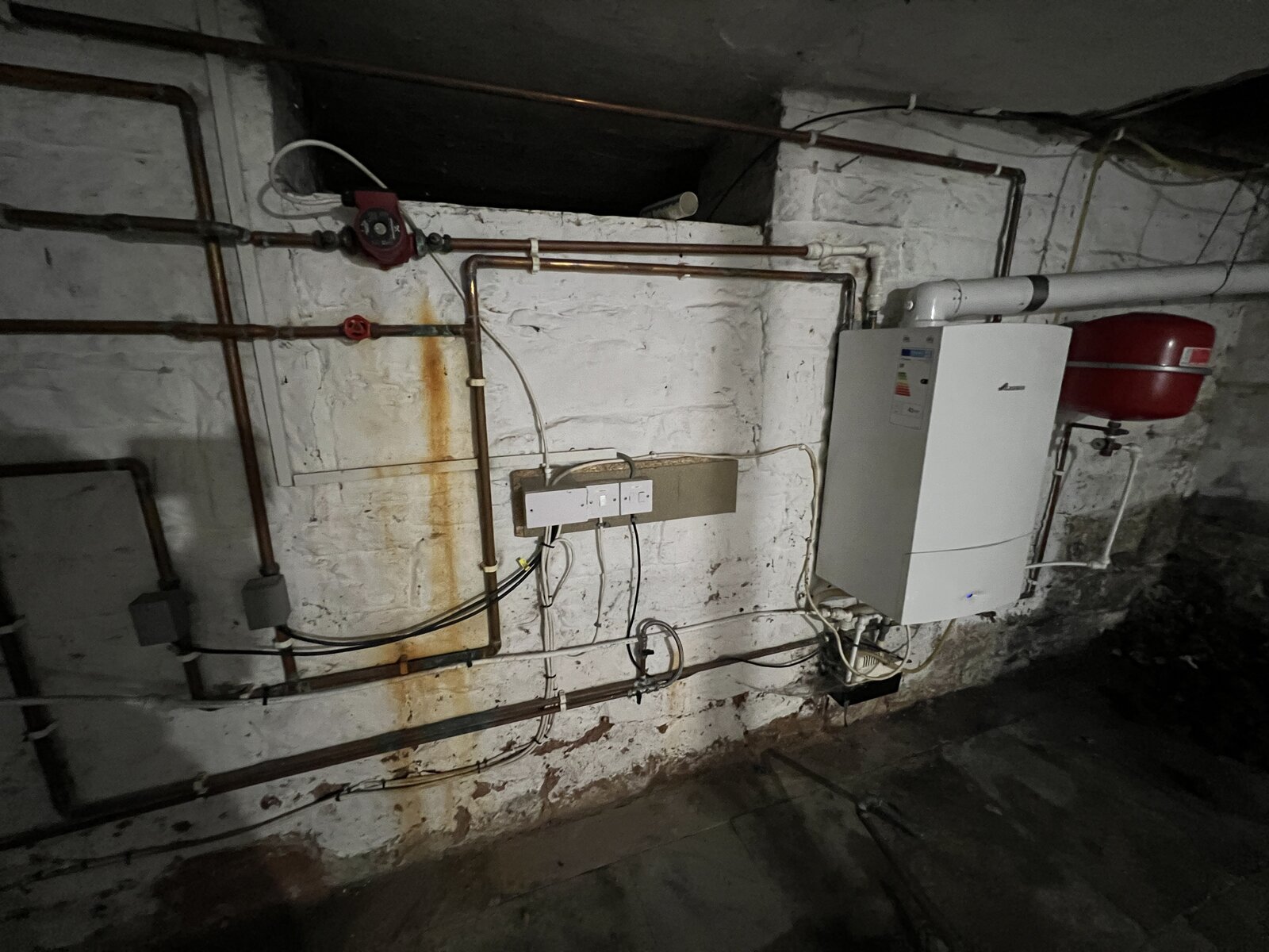

Finally had more time to investigate and follow up on this... Been and taken some pictures of the delights of my installation. I particularly like the wiring centre... :rolleyes:
The lovely plumbing coming out of the system boiler. Can see the 2 motorised valves for what I'm assuming is an S-Plan set-up:

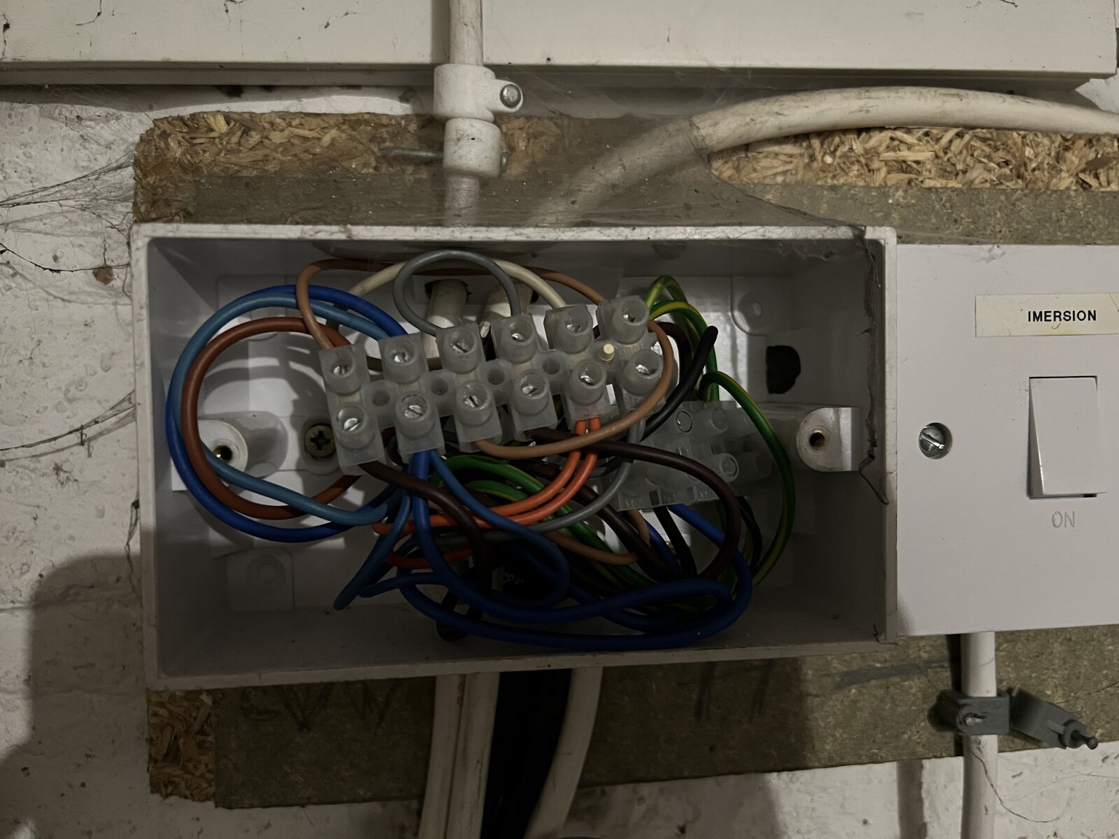

Fantastic wiring centre:

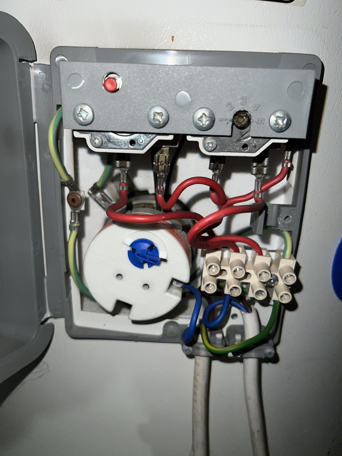

And finally, the inside of the grey cover on the cylinder:
Do I have any control of the temp the cylinder is set to? The system boiler is set to ~63degrees.
I can't find any room thermostat anywhere in the house, I'll start a different thread on that shortly but am I basically correct to assume I could have an updated 2-channel programmer added to manage both schedule and temperate set-point?

First the central heating, I am an electrician not a heating engineer, but basic way gas (not oil) central heating works, is hot water is pumped around the system, through thermostatic radiator valves (TRV) on every radiator, and as these close the by-pass valve opens allowing hot water to return to the water heater, which then modulates (turns down output) to match the demand, until it can't turn down any more, then it starts a mark/space ratio, turning boiler off/on slowly increasing the off time.
The problem is, it would never turn fully off, you could do that manually, but better if automated, best is for the TRV heads to be linked to the controller, so when all satisfied boiler is turned off. However that tends to be expensive, so we are told to select a ground floor room, as heat raises, normally kept cool, as we want heating to turn off as ambient temperature raises, with no outside doors, or alternative heating, and not fit a TRV in that room, but use a wall thermostat. And use the lock shield valve on the radiator to adjust heating speed so that room is slowest to heat up.

Now onto domestic hot water, if stored needs to be over 60ºC to stop legionnaires. 65ºC is normal, in winter warming up pipe work does not matter, as that heat will go into the house, summer however different story. Gas is cheaper than electric, but you have more losses with gas, so all down to how much DHW is used. My wife and I use an instant electric shower, so DHW is only for washing hands, and the odd dish which can't go into the dish washer, we have no thermostat on the DHW tank except for the immersion heater, so only control was time, our Nest Gen 3 allows us to set how long what time and what day of week heated in half hour increments, so set 4 times a week ½ hour at a time, but after 20 minutes return water too hot so boiler would turn off, so 20 kW boiler, oil so always at 20 kW when running so 80 hours per week = approx 25 kWh to heat domestic hot water, when solar fitted started using the immersion heater with an iboost+ which uses excess solar, and logs how much used per week, approx 2.5 kWh, oil and gas are cheaper, but not a tenth of the price of electric, so for us, using electric is cheaper in summer, winter no option, if central heating running DHW is heated, no way to turn it off.

Anyway, a bit more digging through the manual for the cylinder and I now understand how to set the temp for the water.
