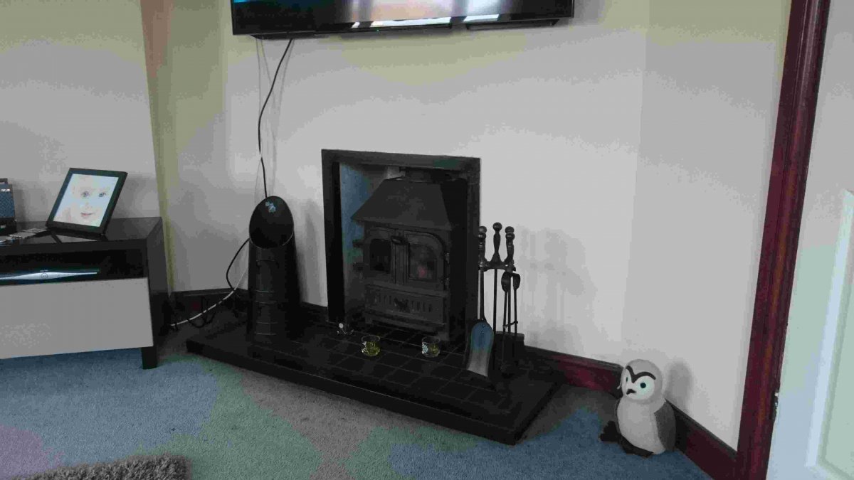

Hi,
I have moved house and we have a very small log burner. I really don't know what I'm doing with it so have some stupid questions!
  • Will the chimney need sweeping?
  • Why Doesn't it kick out any heat (the chimney is direct above, I assume all the heat is dissipating out of the top).
  • What can I burn in there, is it safe to put Coals in (would this put out more heat).
  • Should glowing hot embers be seen coming out the chimney, there are some coming out, is this dangerous?
  • Is it worth upgrading the stove, are they any rules I should be aware of. is it best to take some dimensions and ask at a stove shop.
Most log burner heat comes from heating the air around the hot stove. With too little space around the stove the air movement is limited.
Having a TV above am active fire is not a good idea. Heat and dust ( fine soot particles ) from the fire can be harmful to the TV

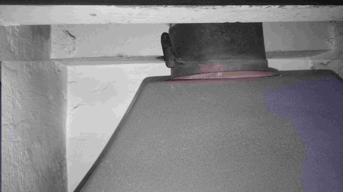

If there are embers coming out of the chimney - and the baffle plate is in place - I'd say the chimney should be swept as soon as possible.
The chimney needs to be closed off with a register plate to prevent heat simply vanishing up the lum. I can't see if there is one there or not.

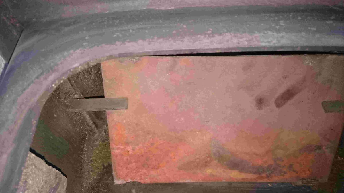

When I first cleaned it out I removed a large metal plate that sits just in the exit to the flume, and a carrier bags worth of brown soot came out with it. I did wonder if chimney sweeping was still a thing!

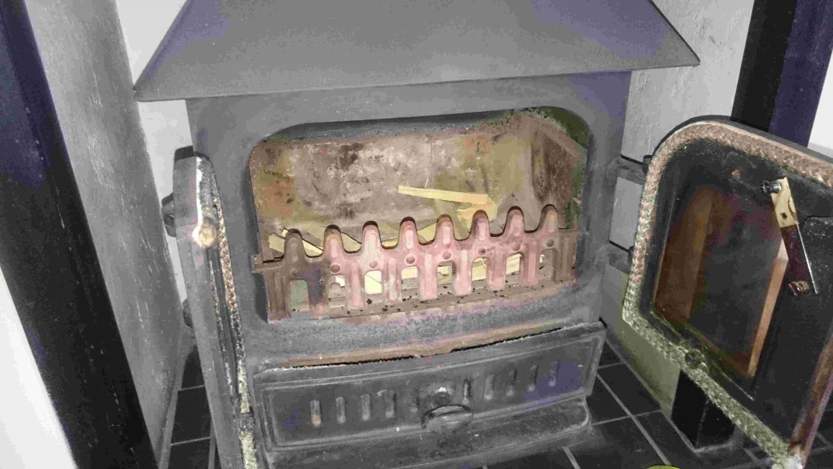

Looking at the third picture down, it looks like you've got a gap at the top of the bottom door? If so - you would generally expect to burn more fuel and send the heat up the chimney.
...and probably a silly question but I hope you did put the baffle plate back in after cleaning out the stove?
I'd seriously consider some sort of heat barrier between the telly and the stove. I have a fairly modern stove and it belts out heat. I have a 3" x 7" oak shelf and the TV is totally isolated from the rising heat.
Never understood mounting a tv so high, pain in the neck, literally.[Terrible posture, similar to riding a racing motorcycle for hours]
