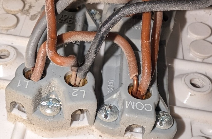

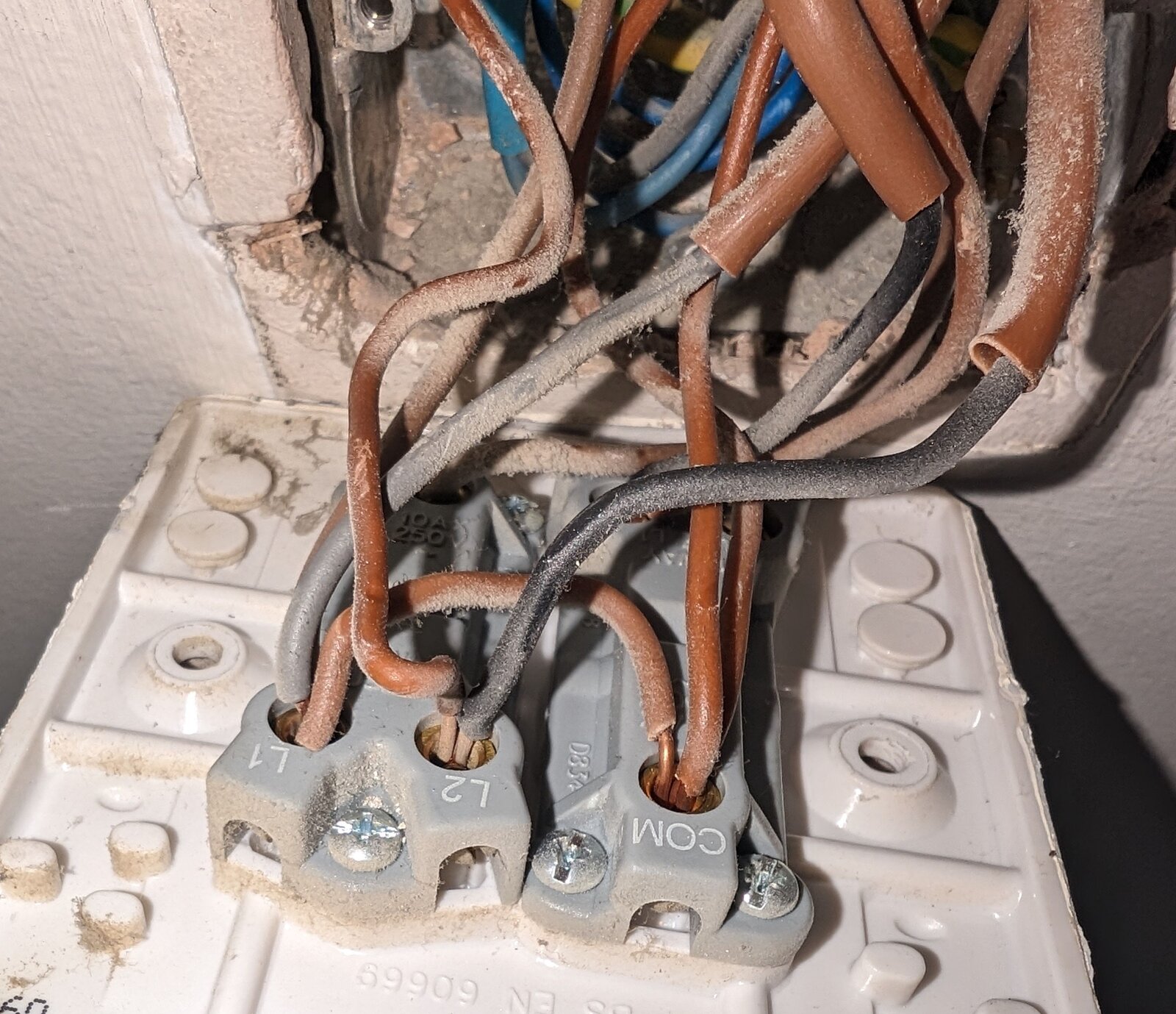

I have a Envirovent Sil100HT Humidistat Extractor in the bathroom with L N and Ls connections in the unit. It has its own isolator switch above the door but only seems to come on with the light switch.
I want to change it so that the fan can be controlled independently from the light switch or basically on all the time due to being humidistat.
There is currently a 2 gang switch in place and I have a spare 3 gang switch that I can use, can I do it that way to give it its own switch? or is there another way?
The 2 way connection is for another light in the room outside thats controlled by 2 switches.

Actually thinking about this again, I think I will go down the 3 switch route as it may be useful to have the manual mode. So on the 3 gang switch I move the LS wire over to L1 on the 'new' switch? What about the other wire for perm live?
Just continue the link that connects the two existing switches.
It would be better to rearrange all those wires but if you are not sure which is which just add another link.
Ok so from COM on the 'existing' one to the 'L1' with LS in it on the new one or COM>COM?
Don't think so.
The wire which goes to LS on the fan - move it to L1 on the new switch.
A link wire from COM on the right hand switch in the picture to COM on the new switch.
That's all.
Don't think so.
That's all.
Ok and the L wire on the fan still remains in its 'original' position back in one of the other switches or does that move too?
Well, it can stay where it is - but if you are certain which one it is you could move it into COM with the link wire
Moving it would make the terminal it is in now less congested.
