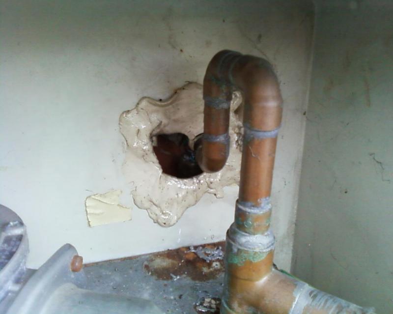

I got a second quote today from a ex BG engineer who suggested a different approach.
He said that instead of feeding the service pipe through the back of the meter box, that it is brought through the cavity in a liner 100mm below the box, and is elbowed up through the standard entry hole, and to the ECV.
This sounds a neater solution, and would look a lot better than using a wodge of sealant at the back of the box.
I found this photo on the internet earlier of what 'plan A' could have looked like!!!
