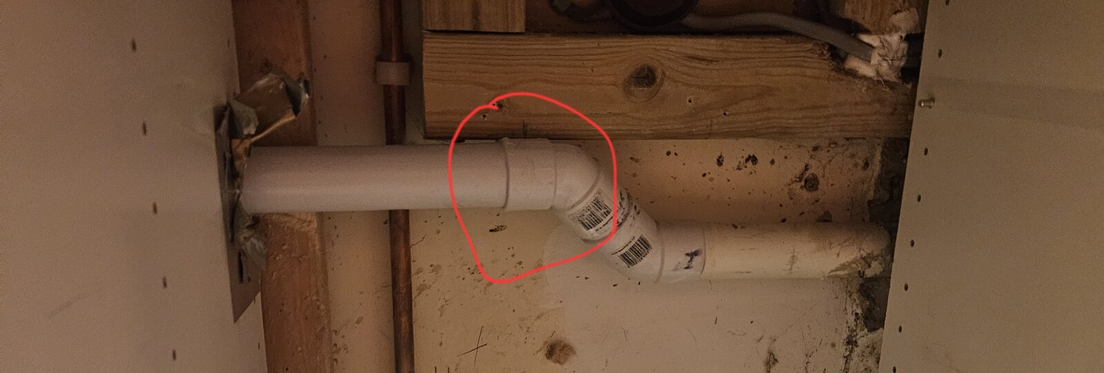

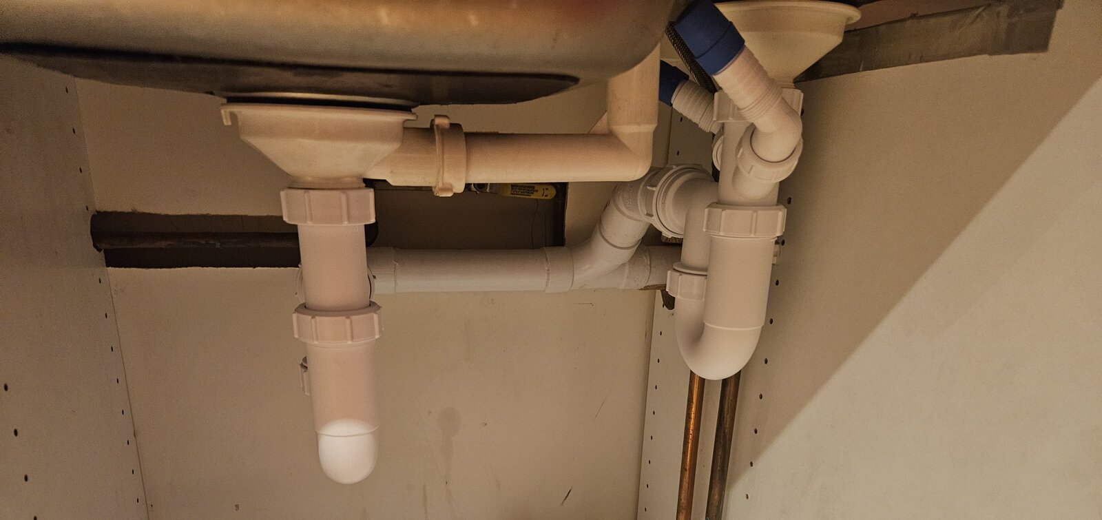

Great! I managed to get it done (waste pipes) - thanks for all your help! I've attached some pictures. Only thing is, one of the pipes was a little too short and I only realised this when it had been cemented in (I've circled it on the picture). One other was at a slight downward angle.
The depth to push the pipe into the joints appears to be 30mm and I think I managed to get it in maybe 15mm. It's fully sealed and there are no leaks. I'm just wondering if this is going to cause any big issues in terms of blockages etc.
Unlikely - just keep good waste pipe maintenance - once a month run a basin full of boiling water with vinegar/bicarb/jeyes or similar down it to flush the pipework out.

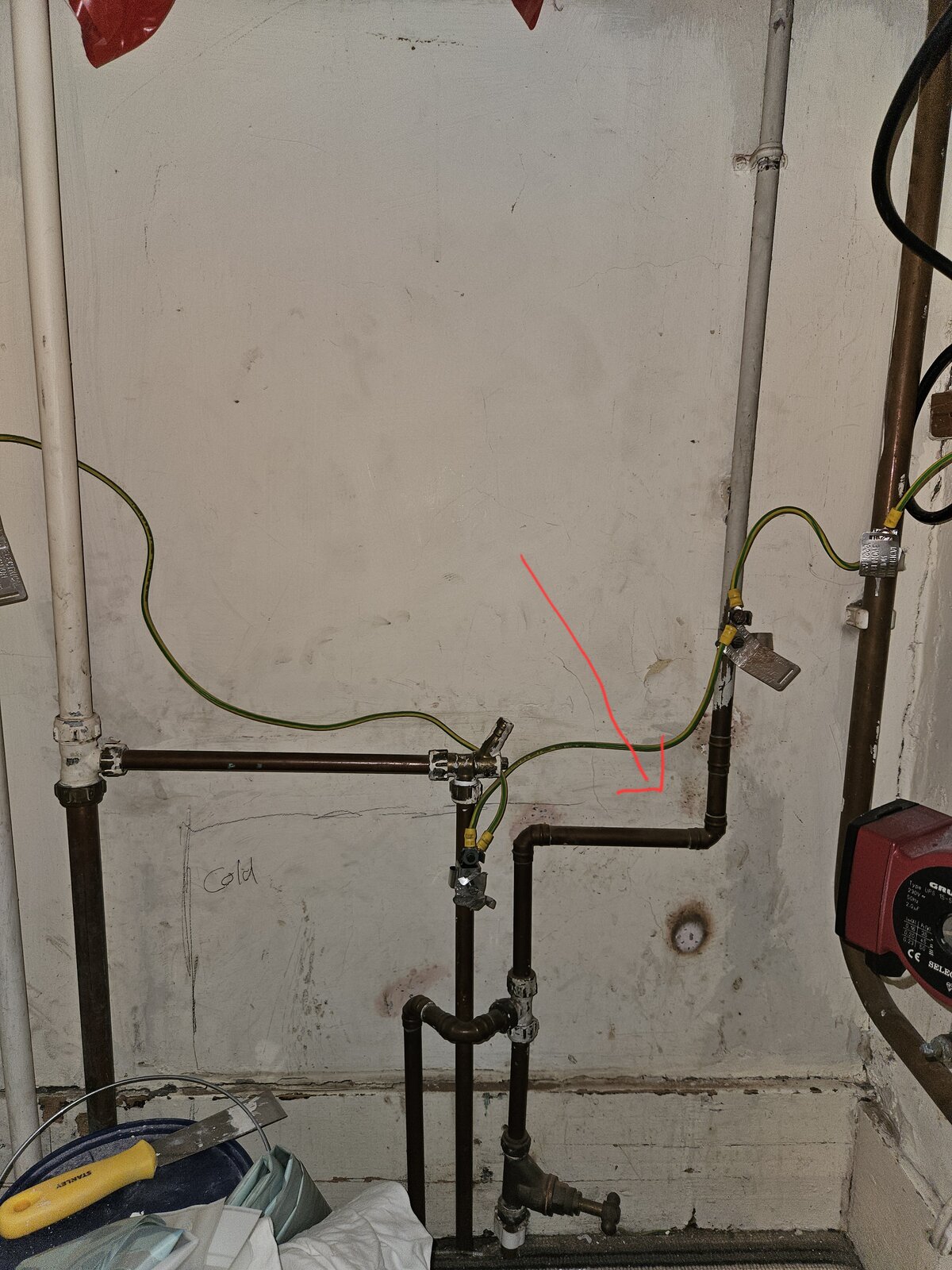

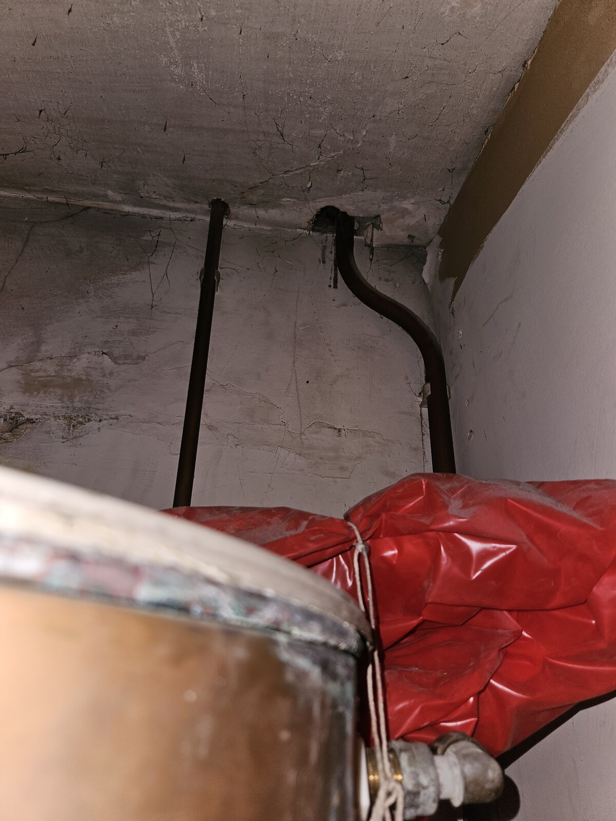

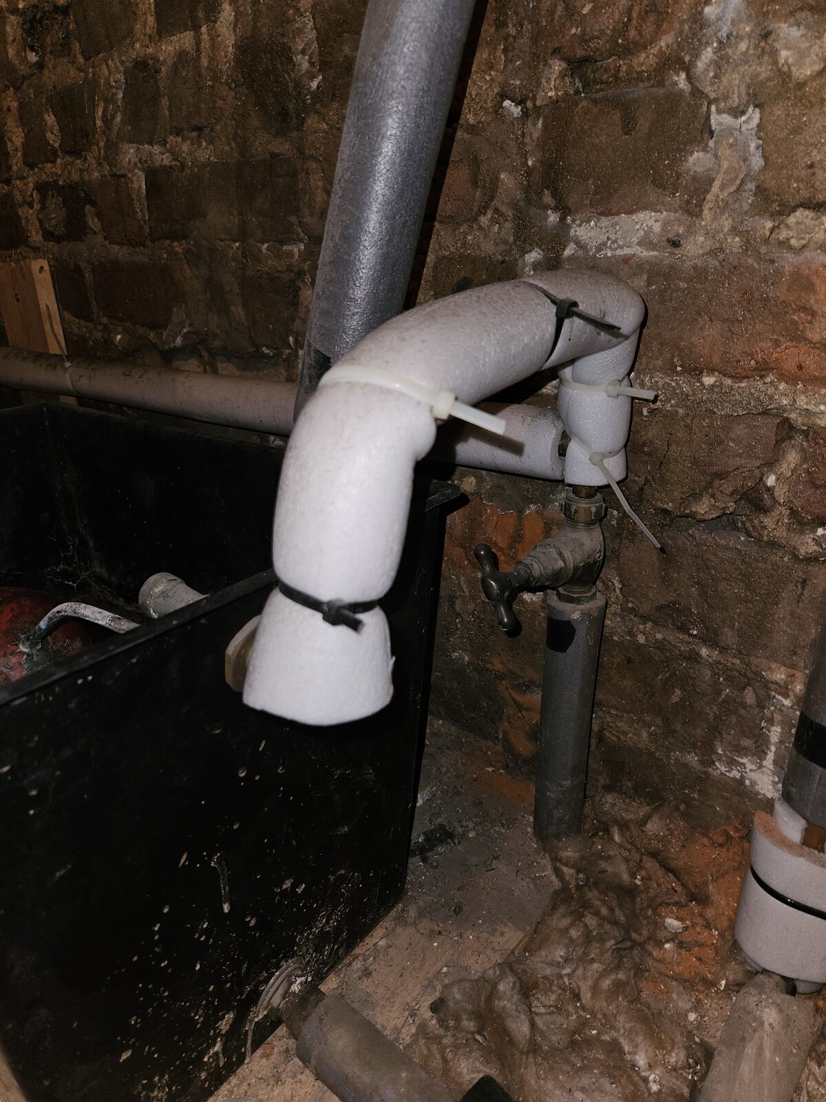

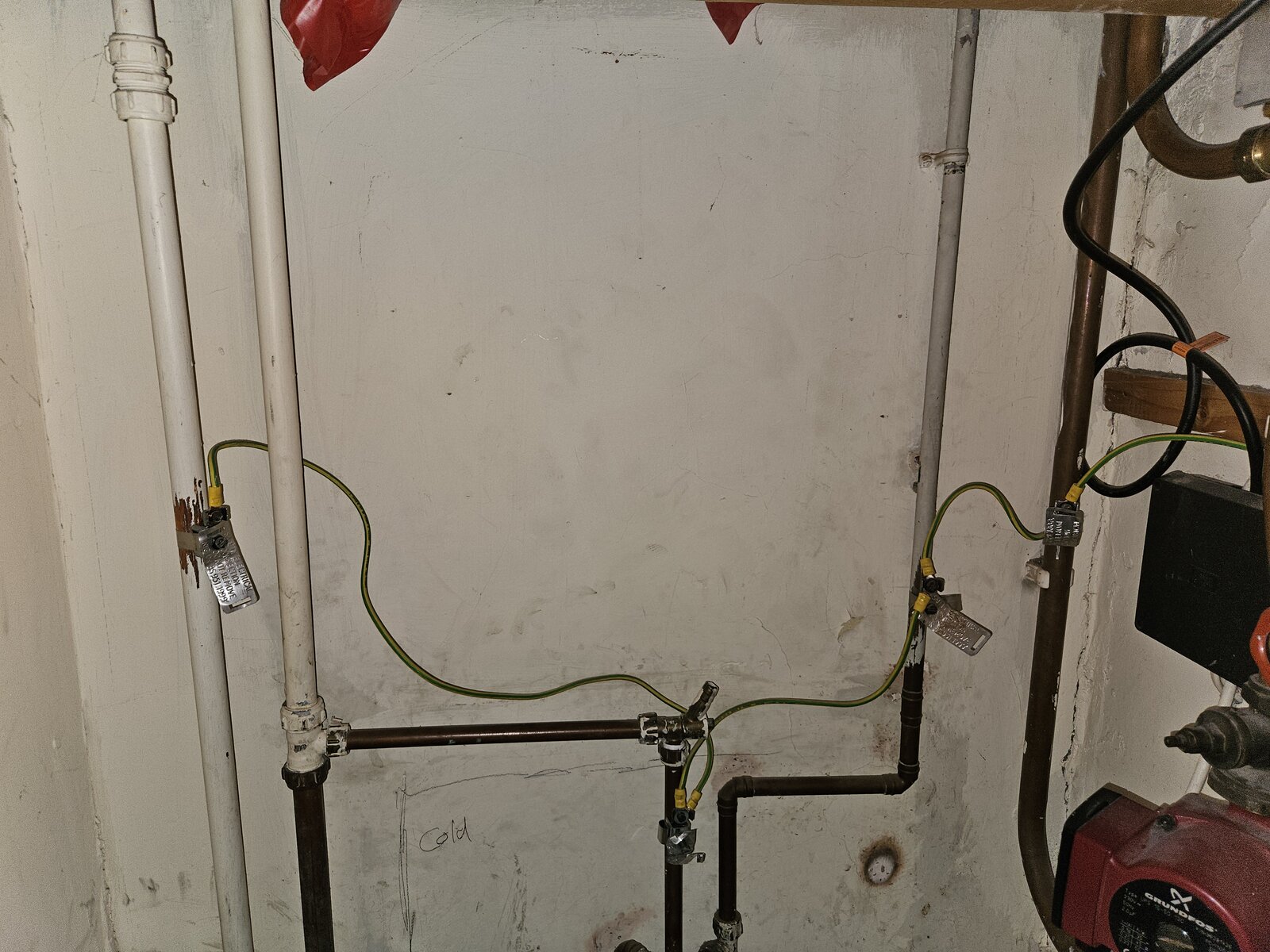

In terms of the noise, it does particularly appear to be coming from the pipes upstairs in the cupboard with the tank (though, it doesn't appear to be coming from the tank). The pipes lead into the loft (pictures attached).
I've subsequently touched each of the pipes as the knock happens and the only one I feel any vibration in is marked with an arrow in the picture. The tap at the bottom of the pipe turns off the water for upstairs (doesn't appear to be for the whole house, which is downstairs).
