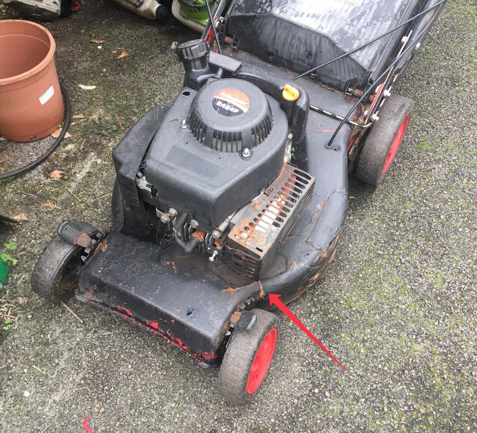

Towards the end of the cutting season my deck on the mower decided to split a good 4 to 5 inches & in the past ive welded a plate on i thought it was time to stop due to now the weight of it etc.

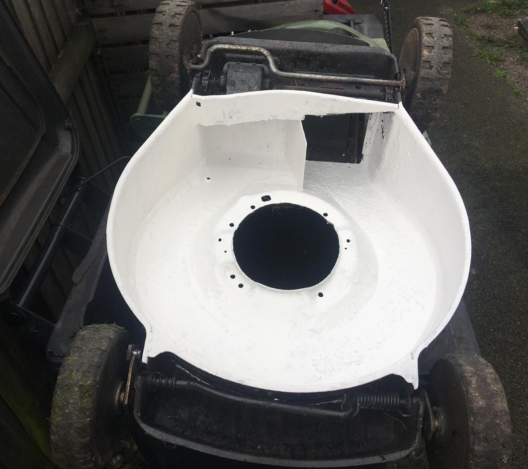

Bars & Engine off ive turned it upside down & given it a good scrap & painted with metal rust paint.
My plan now is to fit the Bars & Engine from the other mower.
Measuring the widest part of the deck its say 21 inch & my old one around 19 inch.

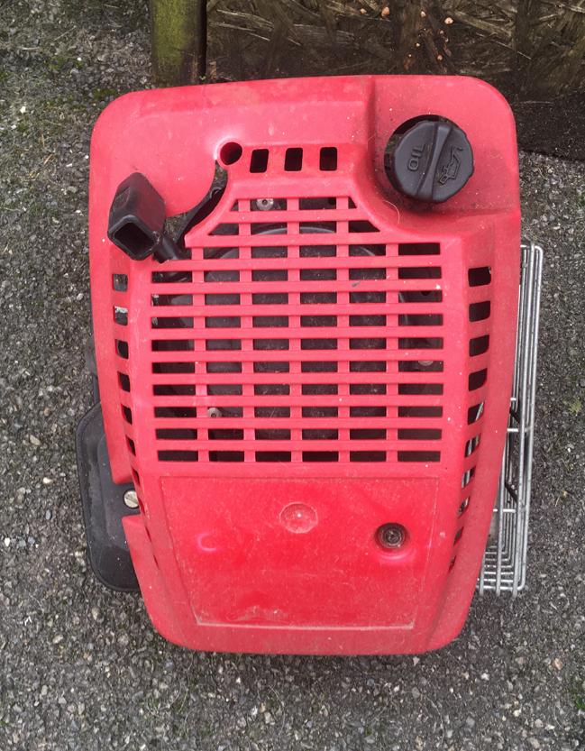

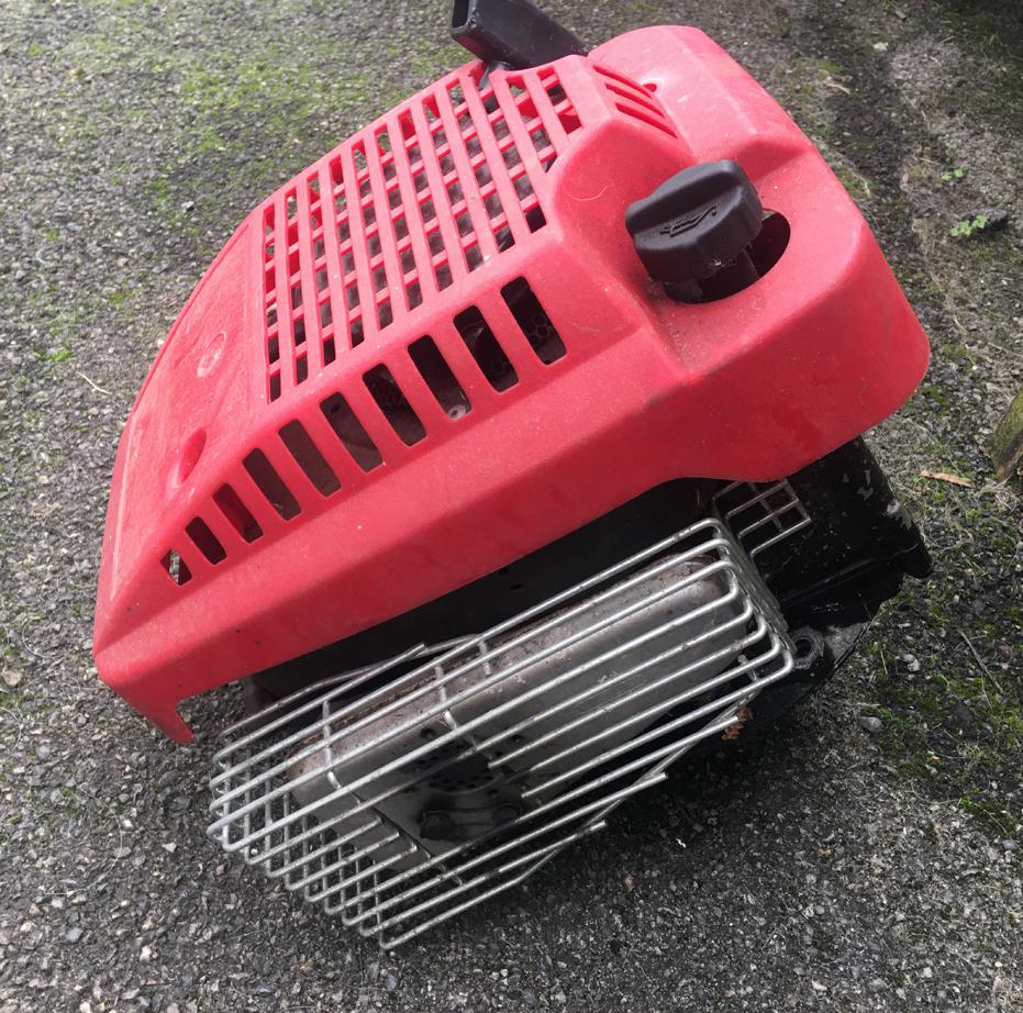

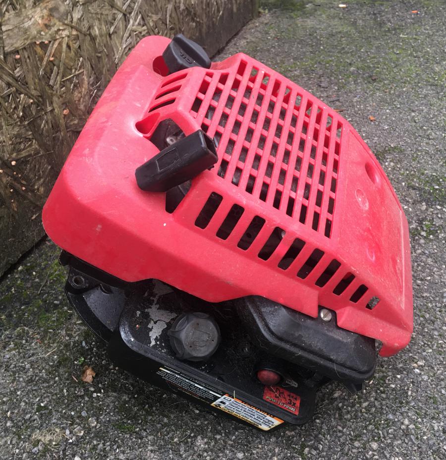

I attach engine from new mower.
Deck size.
Old mower showing crack & width of deck
Inside diameter old new deck is just oevr 20 inches

I’ve little experience of this, however I did change a Kawasaki engine for a Briggs V twin, and I was happy to see the mounting holes were the same.
No reason for you not to redrill the deck if you need to, of course!

Both decks are mountfield so i suppose i was asking Do Mountfield use the same hole pattern in decks as we know many decks are different but engines the same & vice versa ?
If you intend to cut a blade you’ll need to be very accurate indeed or it will be heavily out of balance......this includes grinding the cutting edge too.
I’d be surprised if the engine mounting holes weren’t identical.

So as i have nothing to go buy the inside distance side to side is 20 inches
So i was asking do i just buy an 18 inch blade.
If you know the model of the “new” deck just buy a blade for that model.
I don’t.
The blade boss looks the same so I’m thinking the blades are the same just length is different.
Turn your deck over and check the clearance then make sure you achieve at least the same amount.
So deck is over & measured at 20 inches side to side.My old deck to blade is about an inch gap either side so i wil think i will order up an 18 inch blade for this
Ho can you tell that.The boss that it fits onto look the same so other than the length of the blade i dont see any di9fference unless you can advise
I’m pretty sure that 19” blades are available, so many are interchangeable......Mountfield, Stiga, GGP and some Honda seem to fit the same boss.
