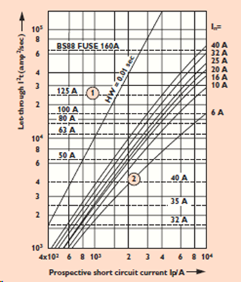

Perhaps it would be simplest if you showed us the 'working' of your adiabatic calculation?
Well I was thinking the fuse would be a 1361 type 2 - But these are not listed in 7671 time current graphs. So I went with the BS 88-3, which is a 63 A fuse.
Though in the old switch fuses they were 60A.
With a Zdb of 0.21Ω I calculated a fault current of 1095A As this is the Zs reading I am taking this as the PEFC
To cause a 63A BS 88-3 fuse to trip in 0.1 seconds takes 820A (600A for 0.4 seconds)
So (Square root) 1095 x 1095 x 0.1 / 115 = 3.01 mm So that would be 4mm2 Protective conductor required.

Well I was thinking the fuse would be a 1361 type 2 - But these are not listed in 7671 time current graphs. So I went with the BS 88-3, which is a 63 A fuse. Though in the old switch fuses they were 60A.
[I had forgotten that we're talking about fuses, but that does make it a little easier than with MCBs, because of the shape of the curves ]
What you've done will give a 'safe' estimate of the minimum required CSA, but it will probably be a considerable over-estimate of what is actually needed.
The BS7671 curve for a 63A BS88-3 fuse stops at 0.1s but, if one assumes that the curve continues down in the way it is going at that point, by extrapolation it looks as if the disconnection time at 1,095A would be around 0.01 sec, probably a bit less. If one repeats your calculation for 0.01s it would become:
[ √(1095 x 1095 x 0.01) ] /115 = 0.95 mm²
So I went with 0.1 for disconnection time rather than 0.4 as the PEFC suggested a fault current greater than the 820A value in Fig 3A1 7671
The required CSA of the protective conductor depends upon the actual I²t (given the actual PEFC and disconnection time at that current for the OPD concerned), not the 'regulatory maximum disconnection time' you are designing for. Hence, as above, a 'proper' calculation of required protective conductor size would use a figure of around 0.01s for your PEFC and fuse, not "0.1s" (or "0.4s").

I could, perhaps, have expanded a little on my comment that determining I²t (for an adiabatic calculation) is easier with fuses than with MCBs.
As I said, the I²t one needs for an adiabatic calculation is the actual I²t figure for the actual PEFC and the actual OPD protecting it.
The (t/I) curves (as those in BS7671) for fuses change fairly 'gradually' - so that, as I illustrated, one can ascertain (if necessarily by extrapolation, if the curves are 'cut off') the actual disconnection time for the PEFC one has - hence a fairly 'correct' value of I²t (at that current) can be determined.
However, for MCBs the presented (t/I) curve (as in BS7671) is essentially 'vertical' for disconnection times below about 12 seconds (corresponding to, say, a current of 5 x In, for a B-curve MCB) in other words, those curves give no real clue as to what current will result in what disconnection time below that point (i.e. when PEFC is greater than 5 x In, for a B-curve MCB). One is therefore reliant on data published by the MCB manufacturer to indicate what the actual I²t will be for any particular PEFC - curves such as (rather complicated and confusing!) this one for Wylex B-curve MCBs:
I hope that might clarify a little!
