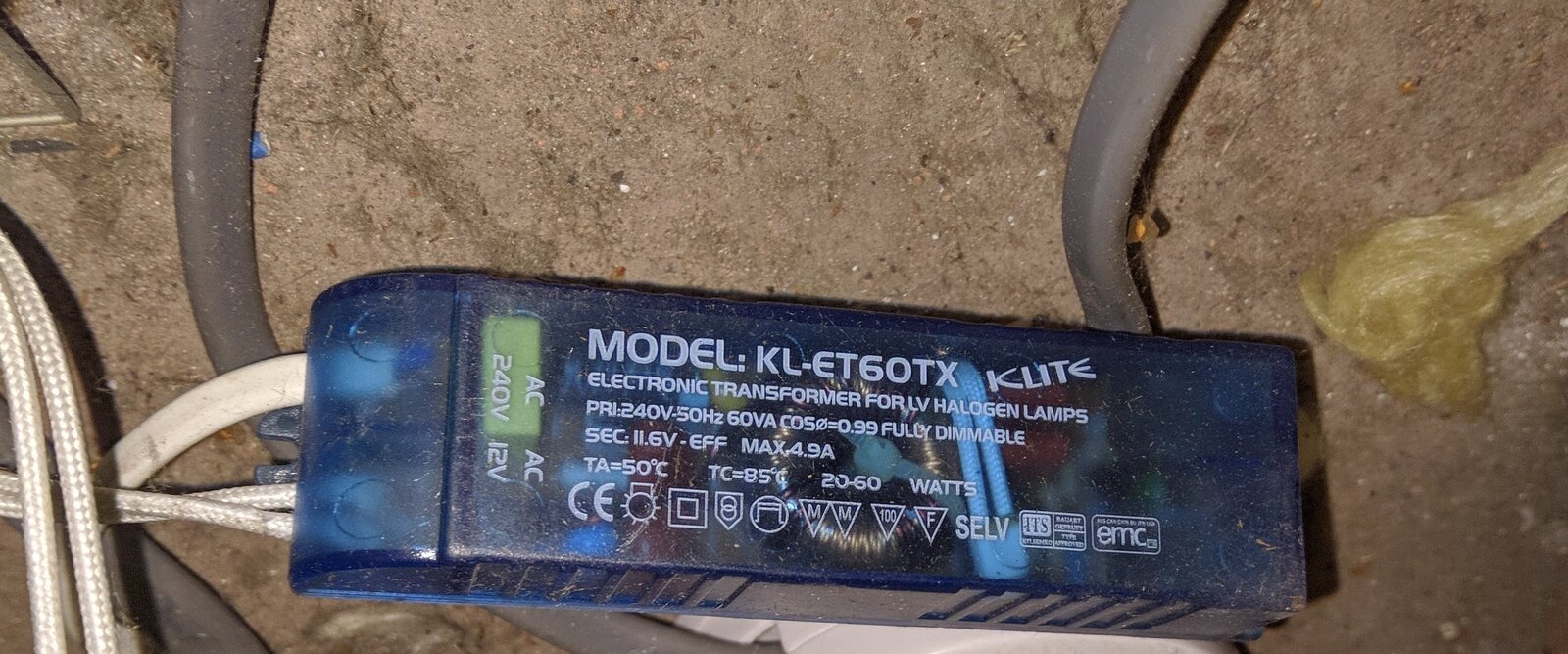

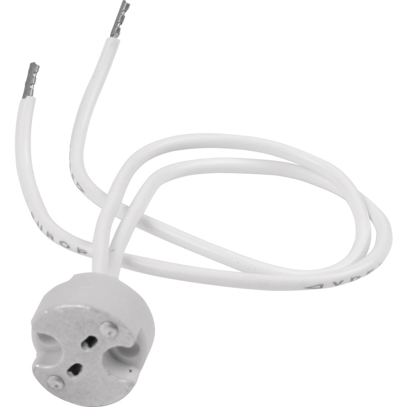

I’ve been into the loft and looked at the set-up and each one is arranged as follows:
Mains -> Transformer (A) -> MR16 lampholder (B)
I’ve changed the MR16 lampholder on both of the problematic ones but the issue still exists, I haven't changed the transformer yet.

Get shot of the trannies and change the lamp holder to a GU10
Then fit GU10 LED lamps. Make sure (if you have them) that any dimmers are compatible with the loads.

No such thing as an MR 16 lamp holder. What you show is G5.3 lamp holder. MR16 lamps can come with all types of lampholder.
There is no requirement and never has been for 12 volt lamps in a bathroom. Where did you get that idea from?
To change to GU10 get a sparks to remove the 12v power supplies and change the lamp holders.

You do not need an electrician. Just get a bunch of GU10 lamp bases. Remove the transformers and connect the 230v cabling to the lamp holders.
Fit GU10 LED lamps.

In theory 230 volt lamps need an earth to the lamp even if not used, but it would clearly work with out an earth, so GU10 would seem a good option, the other one is to swap the electronic transformer for a toroidal transformer then you can use extra low voltage LED lamps. I was lucky I already had toroidal transformers.
These transformers will work with tungsten or LED and is the easy option saving running new cables with an earth.
there are electronic transformers now which are 0 - 50 watt rather than 20 - 60 watt which you have, This is an example they are lighter and cheaper than the toroidal one shown but output is in kHz range and I have noted many 12 volt G5.3 LED lamps marked 50 Hz, I think marked 50 Hz to show they need a transformer rated from zero, so would work with the one shown, but never tried them.
