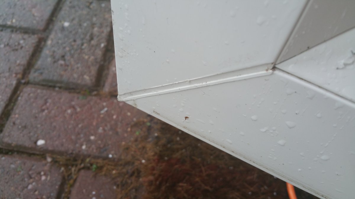

I've seen window where the groover has missed the weld completely and grooved down the side of it or they've had 3 attempts at it
Here's a job I've been to today and it's rehau, it does make me smile when I see this, the fabricator must of thought sod it be alright and just leaves it, shocking really
