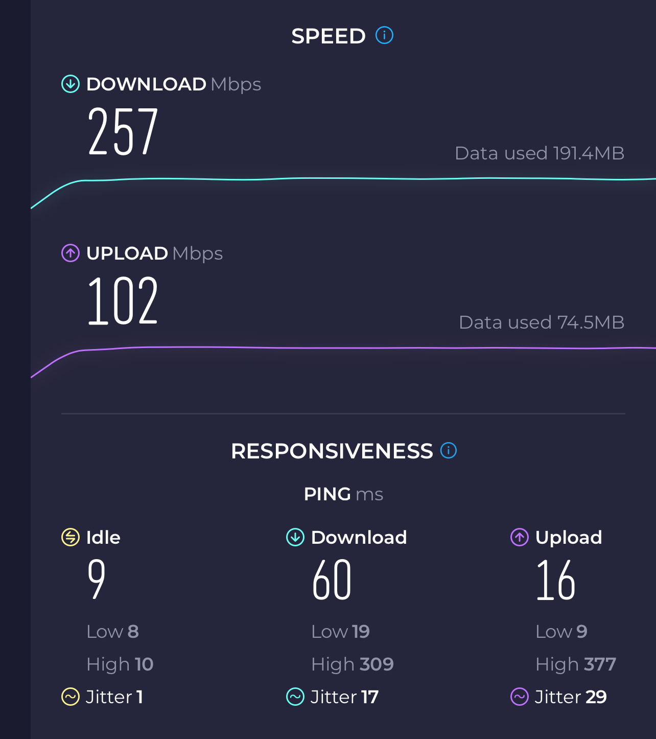

A lot of this comes down to what you want out of your network. For most, one AP would be enough but as I am in IT, guess my home is over engineered for the average person and it all comes at a cost too.
For me, consistency across my house under load was important; so this is speed on my mobile along with both TV’s streaming Netflix, work laptop doing some work stuff, wife working and the Ps5 downloading an update for a game.
