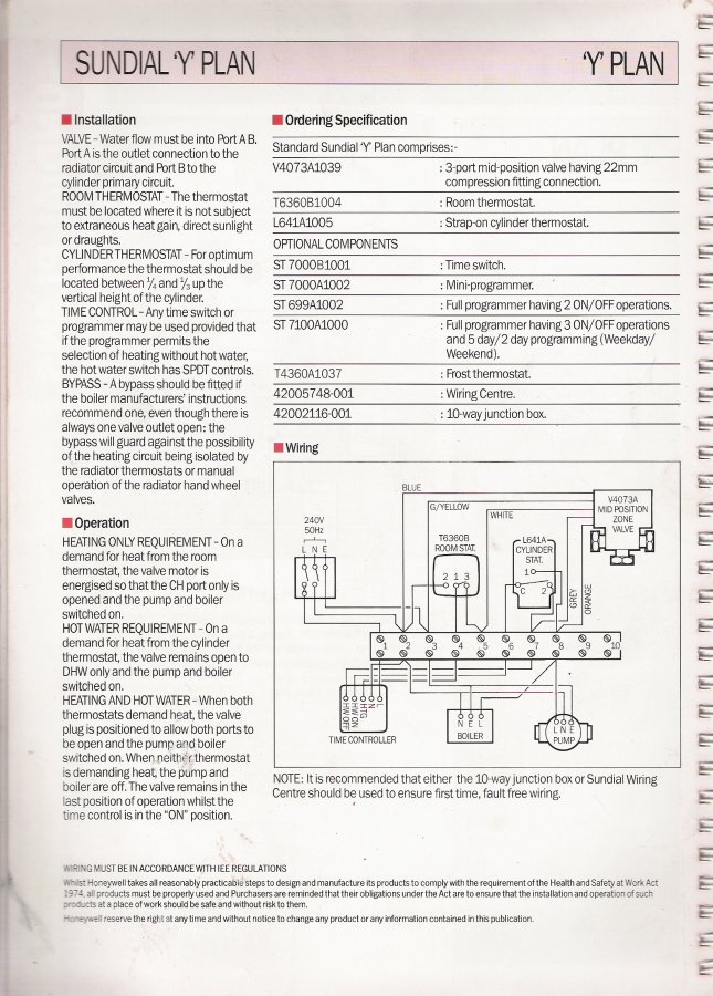

I recently had a Nest thermostat, and am having one small issue...
When it was first installed, it was connected to a live that was only live when the heating was off, this resulted in it the heating constantly going on and off in a loop.
The installer then used another live which appeared to be live all of the time, the result that the heating came on as normal when the thermostat clicked on. All good, or so I thought.
It now appears that this second live is only live when the hot water is off. When the hot water comes on it cuts all power to the Nest and I get a warning to say there's no power.
Is this to stop the heating and hot water coming on at the same time? And if so, is it likely that there is a permanent live in there somewhere to use as power only for the Nest?
Thanks for your help but the junction box is a mess and not labelled at all.

If you have a 3-Port Valve (Y-Plan System) then there is often a HW Off Live from the clock to the Cylinder stat and then onto the 3Port Valve to allow power signal through Valve to activate boiler, depending on the set up some 3port setups will demand that the HW is activated With the heating demand (although generally you will see this on the programmer (turn heating on and HW lights up at same time)
If its just for the heating then there should be a signal wire from the Programmer, that will only be live when the heating on the programmer is on, when you turn the heating at programer off this signal wire should go dead, thats the one that Should be feeding the common on the nest. (not the power to the nest but the common)
But if its set on all the time, it really doesnt matter, any permanant live to the Nest should be fine to bridge to common as full control of the CH will be taken care of by the nest anyway

I suspect that, in the first instance, the installer used the existing programmer's CH OFF terminal; and in the second case he used the HW OFF terminal.
Your pic has just confirmed my second guess - the grey wire from the motorized valve connects to the same terminal. It's impossible to say from the pic which wire will be permanently live. If you have a multimeter you will be able to find one easily,
If the existing programmer has been set to CH permanently on then you can use the CH ON terminal as the permanent supply to the Nest.
Is the Nest a replacement for an older stat? if so the wire from programmer CH ON will have been connected to one terminal of the old stat and the valve's white wire to the other terminal of the old stat.

There is a switched live in the top block on the connector block, which connects to nothing.
Although I will test with a multimeter, is it pretty certain that is the live is the top one?
Having looked at an old photo before Nest was installed, there is a red going into the top connector which does appear to be the one that went to the old thermostat.
What you're saying is the old thermostat would have been connected to a live and the white call for heat? In which case the top one is live when the controller heating is on.
If the terminal you mention is live when CH is ON at the programmer and not live when CH is OFF, you have found your live supply for the Nest. It would be sensible to bridge the L and CH ON terminals at the existing programmer to negate the effect of someone accidentally turning CH off.
Thanks again everyone, it's now all working properly.
