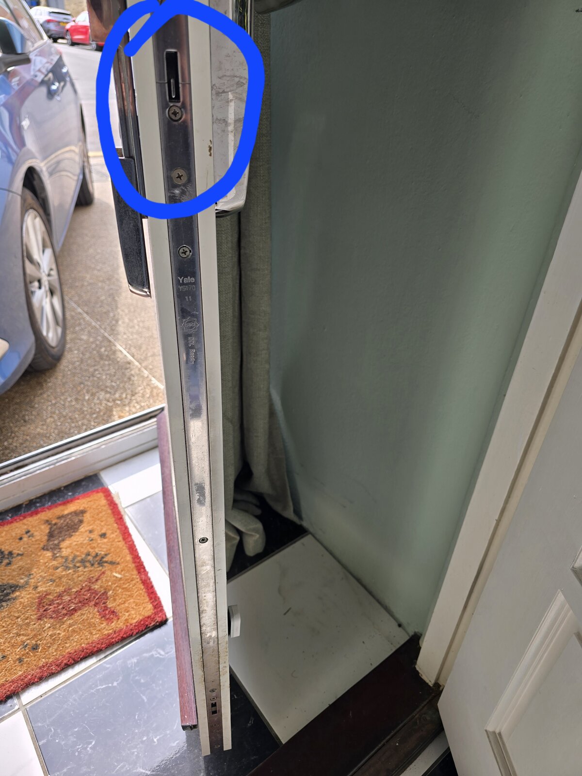

I have the same issue when the door is open so I'm pretty sure it's not alignment.
The handle lifts and the multipoint mechanism moves to lock. It will, however not unlock unless I gently push the latch in 2-3mm (door open) and then the handle will lower and unlock. I am suspecting the gearbox of the multipoint lock but any thoughts welcome.
Video attached to help explain.

No problem - i did think it may be an issue but there wasn't another option - will look at uploading to Youtube or similar. this evening.
That was easier than I thought - video on Youtube ..

I suspect thats the begining of the gearbox failing, notice the hook falls down as you push the handle down, theres probably too much slop in the internals. Luckily the Yale YS170 gearbox can be replaced and is pretty cheap
