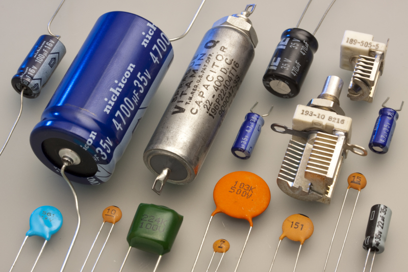

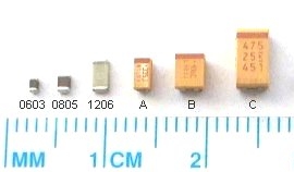

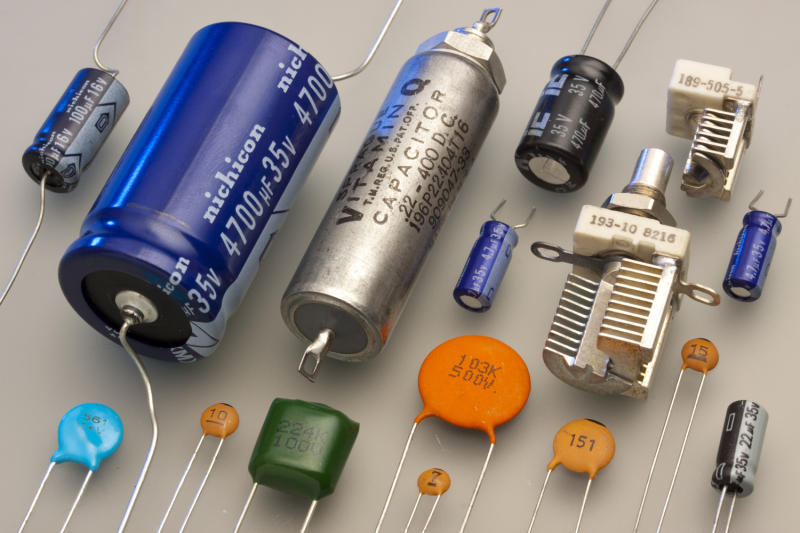

There's a certain type of component that follows the same 'works when warm, fails when cold' pattern. That's a capacitor.
Capacitors are used all over bits of consumer electronics, and that includes the power regulation circuits for laser diodes. The laser is very sensitive to how much power it receives. Too much or too little will cause it to stop working. The capacitors are part of the circuit that governs how much power the diode receives, so if one or more of the capacitors go out of whack then the diode won't run right.
Capacitors come in lots of different sizes (see image below)
...and even some that are smaller than the tip of a ball point pen
... so finding the right one can be tricky even with the short cuts used by bench engineers.
If you want to have the Daewoo fixed, then this would be a start, but IMO it wouldn't be cost-effective compared to replacing the unit with a used Denon DAB 40 or similar.
Warming the disc probably adds enough heat energy to kickstart the failing capacitor(s).
