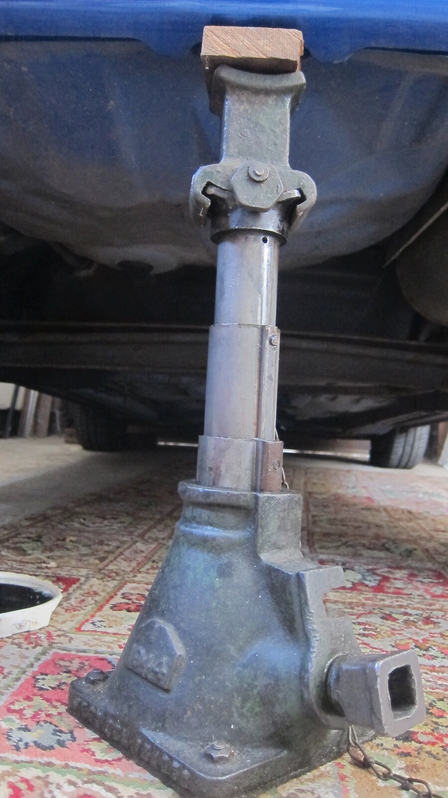

Here is one I did earlier. There are axle stands but they are out of vision. No disparaging remarks about carpet, thank you.
Family heirloom. Despite that I am thinking of placing it in the dustbin as it curls up in the most inelegant way whenever I drive in or out of the garage. Yes, vinyl is much more practical, though, for anything a bit mucky I sometimes use those tarpaulin covers obtainable from that world-renowned epicentre of quality merchandise: The Poundshop.
