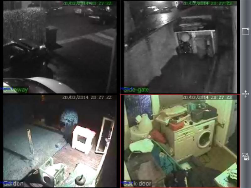

Quick snap I've just taken of the new and better iPhone App:
The only downside is quite a stupid one as you have to use the default password in the DVR leaving me open to having my cameras hacked. Luckily I don't really care as they're not in my bedroom or bathroom!
Will add an iPad picture too.

iPhone (5) picture taken over 4G, iPad (Mini gen 1) over WiFi.
