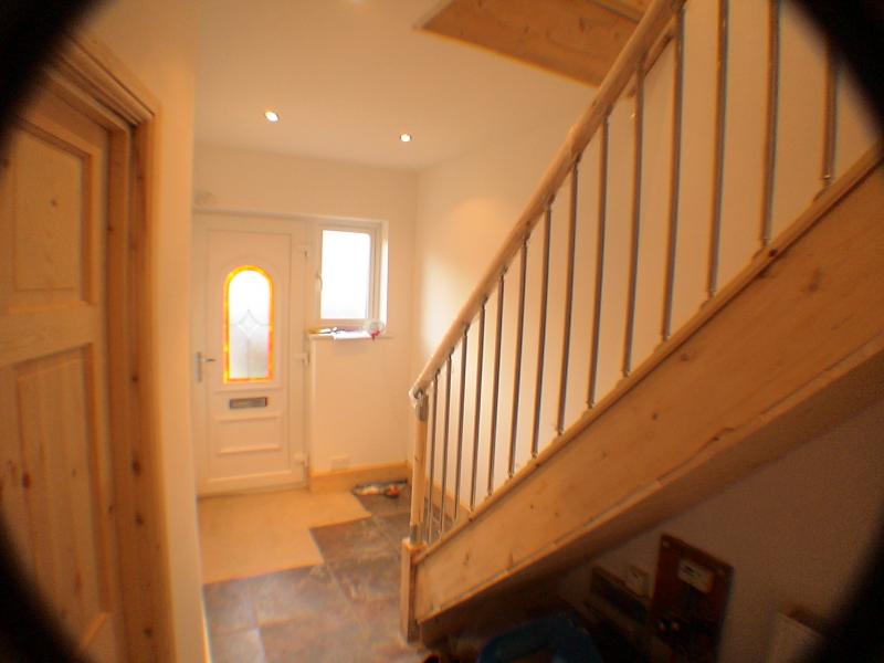

Great wide angle. How do you achieve that? :)
I take it you mean the pictures...
I used a wide angle lens...
There really not that expensive, I think I got mine for abou £30 a few years ago, they really make the picture's go further...

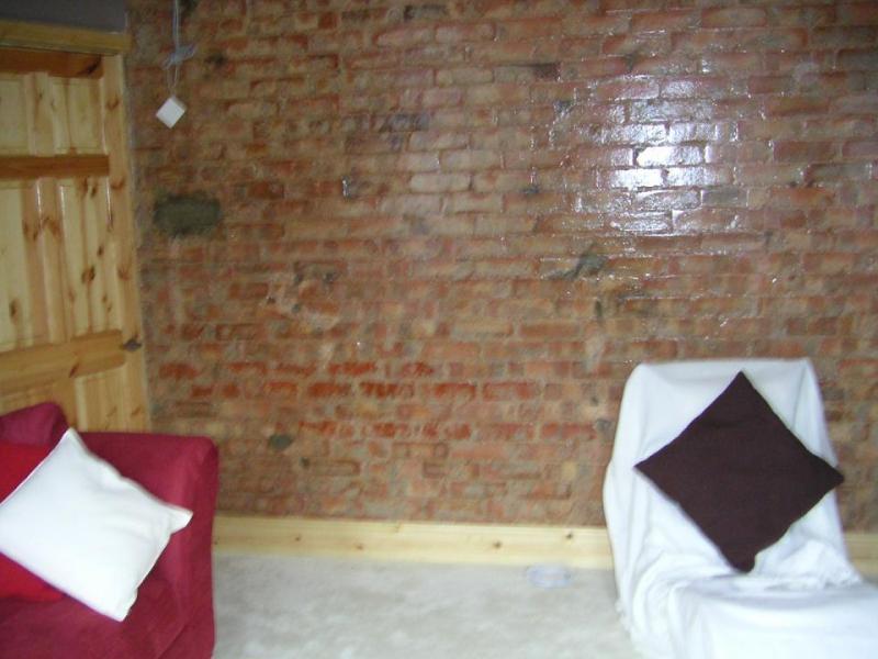

This is the brick wall in my house...
It was covered on plaster, then layers of paint and wallpaper over the years...
I took all the plaster off, sanded down the wall, washed it down too, then varnished it...
Hi, The wall, was that your own original idea,or something you have seen.

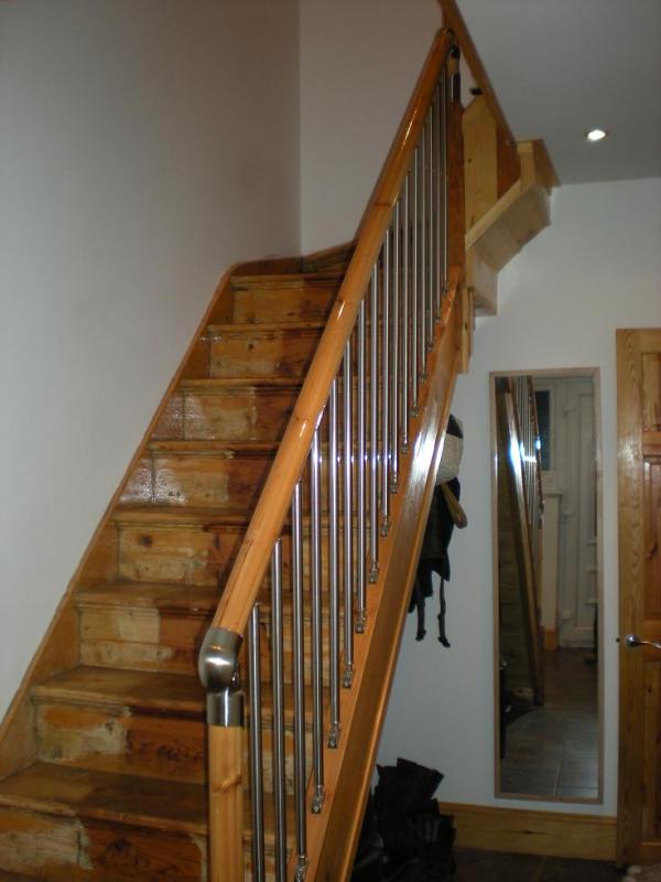

Regarding the stairs, are they the old ones stripped, if so how did you get the wood to look so new, well done.

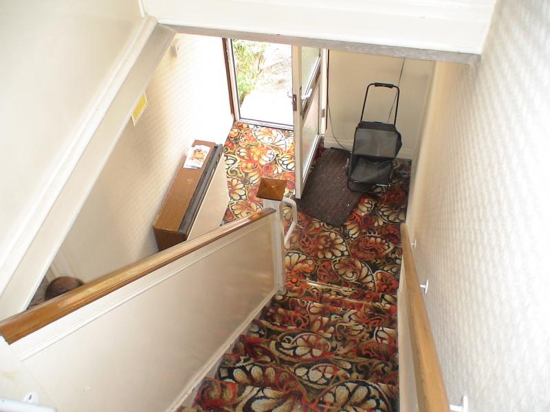

The stairs are old...
They were covered in carpet, they also had several coats of paint on them over the years by the previous owner...
I took the carpet off and sanded down the stairs, sanding took ages...
once the sanding was done I used batons on the underneath of the stairs to give the stairs more strengh...
Once this was done I sprayed the entire staircase with linseed oil, this was to stop the stairs creeking so much and to also put some oil back in the wood...
Once that was done I varnished the stair case and put knew bannisters on...
The wall was an idea I had in mind...
I have seen walls like this in show rooms and thought it looked really good...
I was going to do the whole room with the walls but I think it would have looked tacky, so i only did the one wall in contrast...
