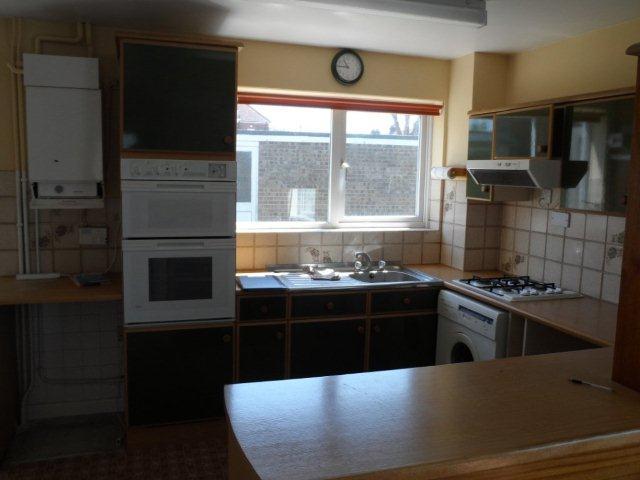

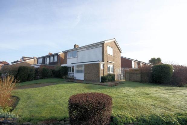

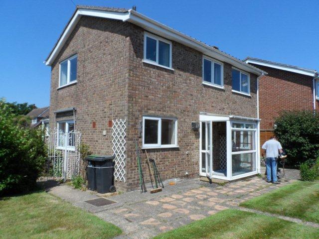

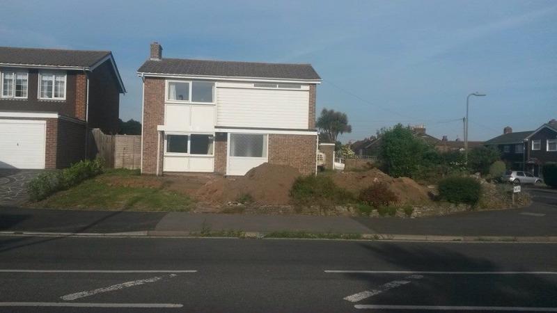

the before pictures. as you can see the front garden is quite big in comparison to the rear garden. I have applied to the council to put a dropped kerb in front of the house as currently there is only 1 parking space which is to the rear of the property in front of the garage.
The dropped kerb application was very borderline as the property in on the corner of a junction and they will not allow a dropped kerb within 10 meters of the junction. Although there was not quite enough room for a new dropped kerb and still allowing the 10 meters the council have agreed to extend my neighbours dropped kerb which will still leave me with about 4 meters of dropped kerb to access the property.
All a bit complicated but the main thing is the council have agreed it which feels like a good start to the project. They want £990 for it though which seems high so I may get some other authorised company to give a quote to see how they compare. Has anyone else had experience in doing this?

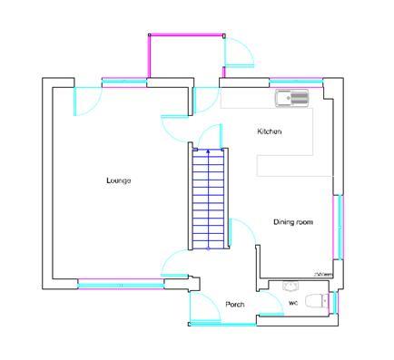

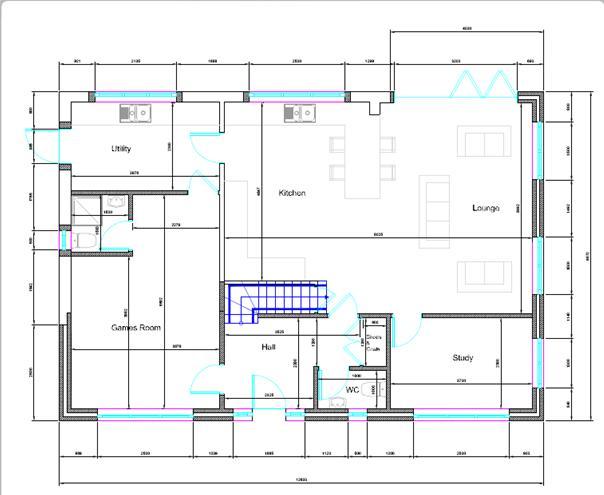

Here is the initial layout downstairs
And the proposed new layout

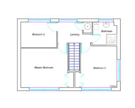

This is the current upstairs layout

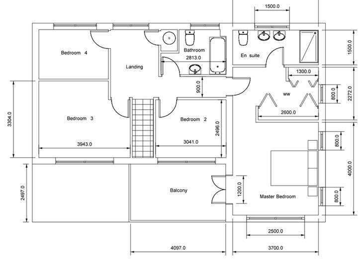

This is the initial design they came back with.
To be honest I wasnt very happy with it. It is a low cost option as doesnt involve moving too many walls however I just felt that the hallway didnt work and I was left with 2 small bedrooms, 1 medium size and 1 which would just be gigantic.

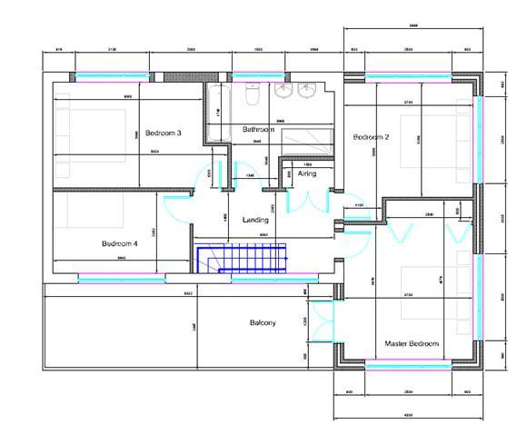

I set about using floorplanner and came up with the following design which is what we are going to go with. It does mean we loose an en suite however we get 4 big bedrooms and a big bathroom.

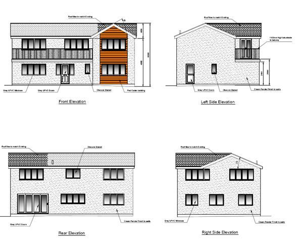

Lastly here are a few pictures of the elivations.
We are hoping to go for a light render, some red cedar cladding and grey windows. It is currently in for pre planning and it looks like its just a waiting game now which is really frustrating as we just want the go ahead.
Any comments / thoughts / suggestions are welcome

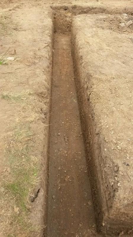

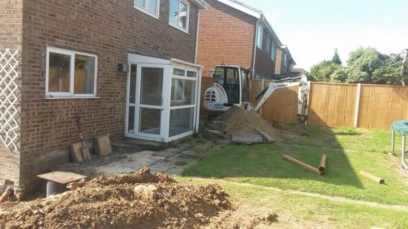

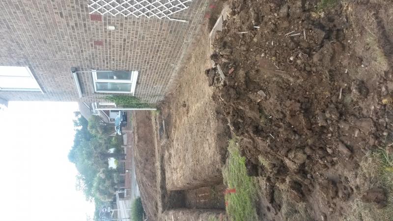

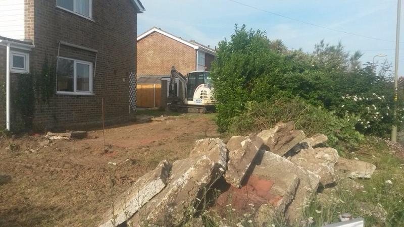

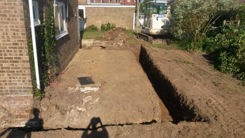

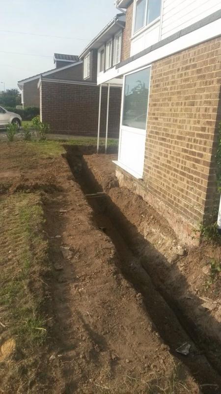

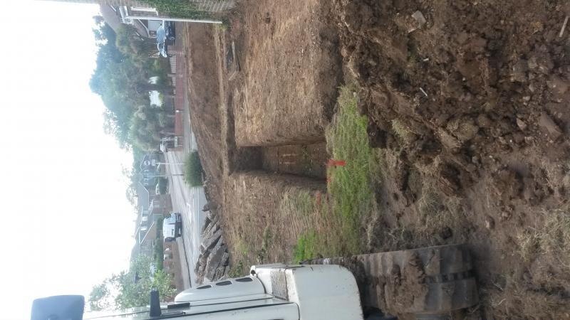

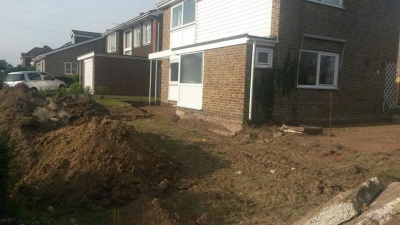

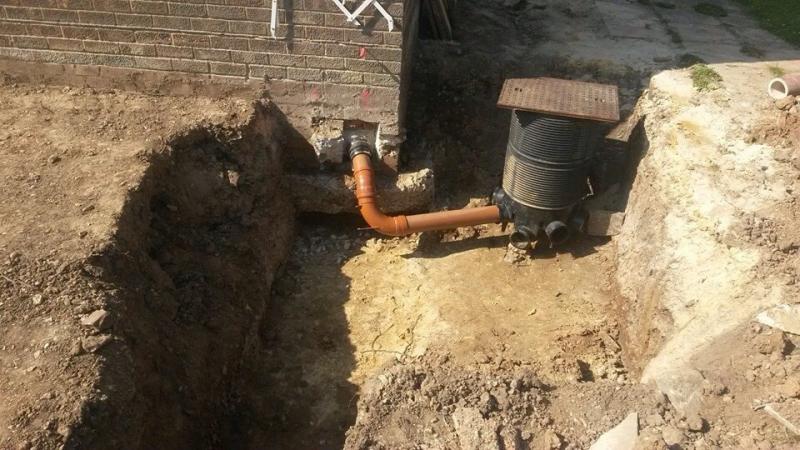

It's the end of week 1 and the digger has been busy. All the trenches have been dug and a couple of manholes have been removed.
Today we had the first inspection from the building inspector. I ended up going with a private company rather than the council. This was partly due to research on here, partly because the company I wanted to use came with a good recommendation and partly because I would a lot rather a private company got my money than the council. This is nothing personal to the council just that they managed to take forever and a day to agree my application, and with lots of mess ups I wouldn't trust a quick and reliable service from any department in the council.
To cut a long story short the builders called the inspector up on Thursday to inspect the trenches. He couldn't get out until Monday as had something up country booked for Friday. Needless to say the builders weren't too happy and neither was I as I had been promised they would come out within 24 hours. After a chat with the inspector he rearranged his diary and came out this morning (Friday). As it turns out a really nice guy who sounded like he knew what he was on about. - a good start. He is happy with the trenches, have guidance on the drainage etc and the builders were able to crack on.
I'm not able to say if the private company was a good option or not as I have not used the council before. Maybe the council might have got out quicker, maybe the wouldn't. Overall I'm really happy with the guy we have so I'm happy with the decision. I guess it all depends on the person you get allocated, some will be great and some won't.
Here is some pics of where we are up to. Hopefully next week will be filling the trenches and finishing the drainage. Very happy so far.

[3] how will you rod out that pipe if it blocks on the first bend in the brown after the black pipe ends

3/ I'm not certain about this one as the builders were talking about drilling up the floor in the kitchen to replace this pipe. So I'm not sure if what they have done is a temporary solution or not. Either way the building inspector has said he wants an internal rodding eye just inside the house. Would that suffice?
If the local council have "approved" the company then all should be OK.
It probably will suffice.
A "funny" story. The house we DIY built in 1980 had a short run of soil pipe that could only be rodded by removing the downstairs toilet. The chance of it blocking was so remote this rodding access was considered OK by the inspector.
It was sold 3 years ago and the new owners ( friends ) made alterations including moving the downstairs toilet. I got a call "Help the toilets overflowing. "
During the work someone had been dumping plaster waste down the toilets. The short section was clogged. Moving the toilet meant there was no longer the rodding access.
The solution was two sets of rods end to end and put into the vent pipe above the roof working on a ladder..
