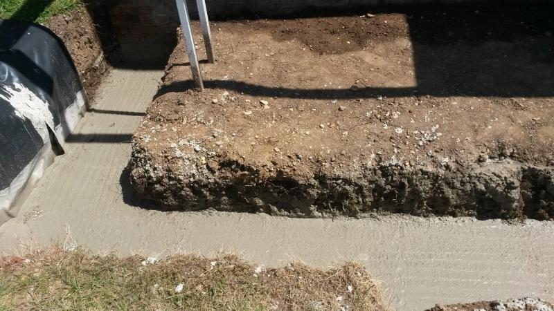

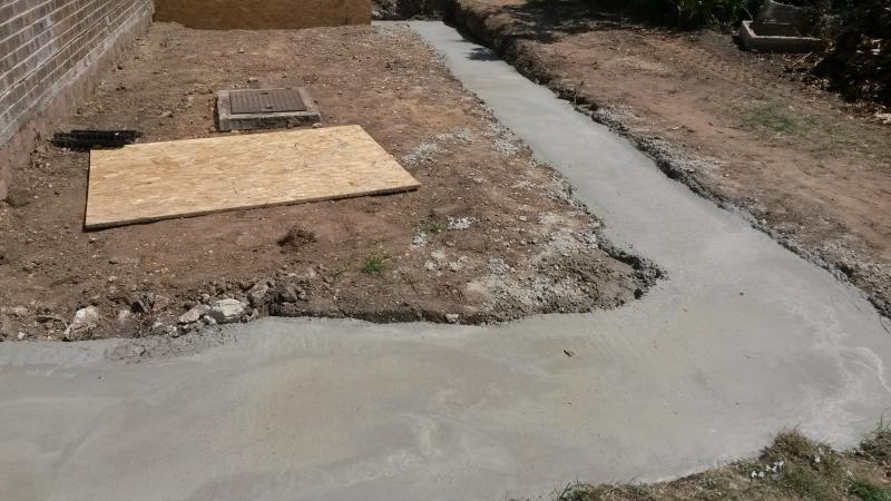

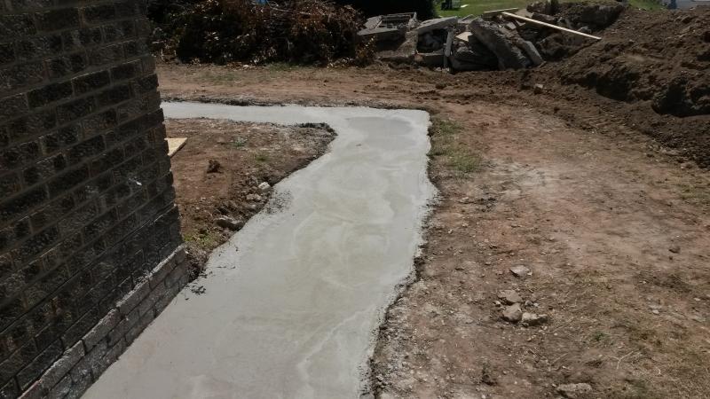

Monday - The concrete for the foundations arrived. The builders put it a bit higher on the part where it would be 2 story than they did on the 1 story section.

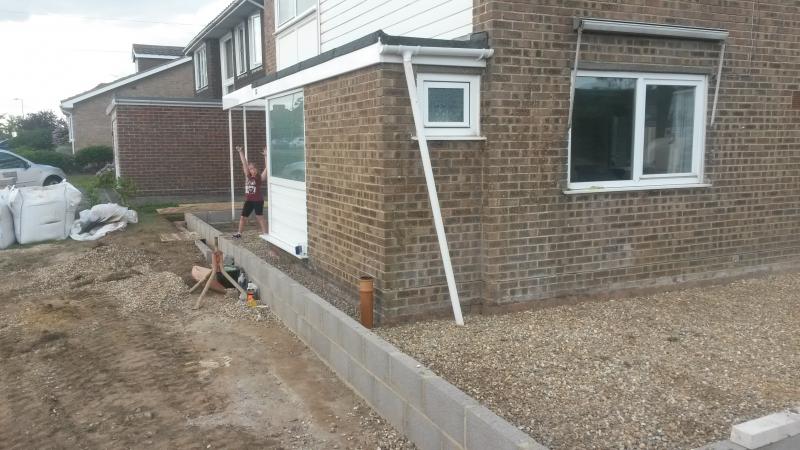

Tuesday, Wednesday and Thursday - The brickie arrived on site and started doing some of the blockwork. The exterior face of this will be done in bricks where it is above ground level as you cant render below DPC and then from there up it will be in blocks and rendered with the rest of the house.

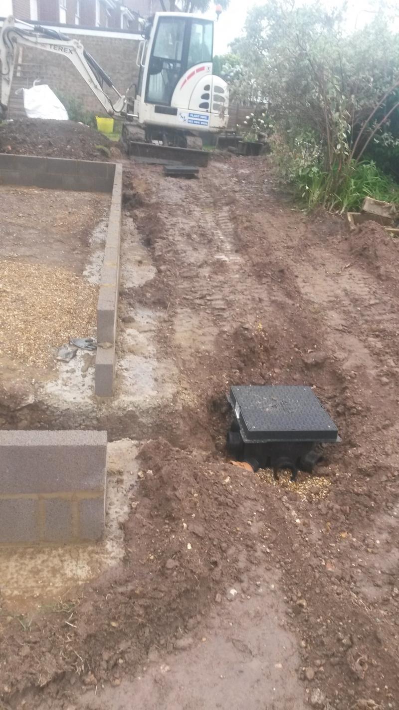

The drainage has been installed and now comes out to the side and goes right around the house, it involved putting in a total of 3 manholes and obviously connecting them all up.

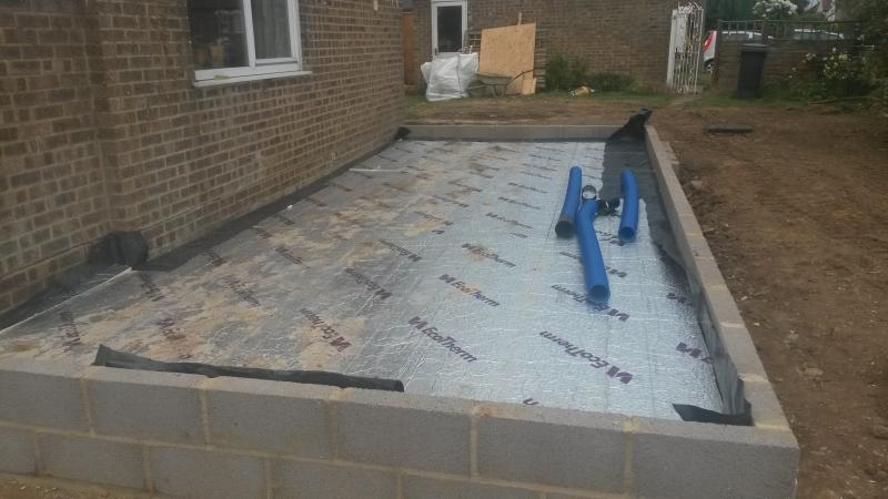

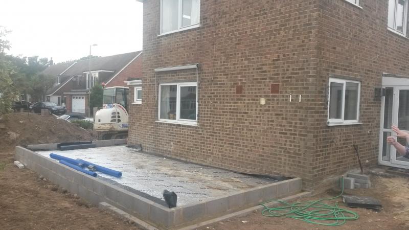

Friday - The flooring now is starting to take shape. From memory it went something like this, Stones, compacted sand, plastic membrain, 100mm insulation. I think from here there is another layer of membrain, concrete and then the final screed (which is done right at the end of the build).
I'm feeling pretty pleased with this weeks progress. Next Monday we have the building inspector coming out for the second inspection which will be up to DPC. At DPC my first payment is due to the builders and we have tried to time the instalments in with the building inspections. I the building inspector is happy with the work upto DPC then the concrete should be poured on Tuesday and then its upwards on onwards. Its really exciting to see this all take shape but is still very hard to get a good idea on how much space we will have and if it will be sufficient. I certainly hope so.

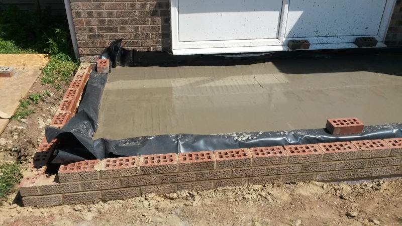

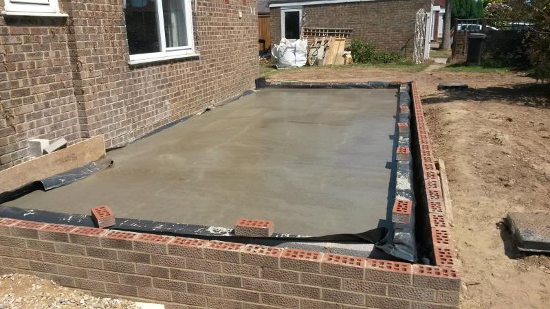

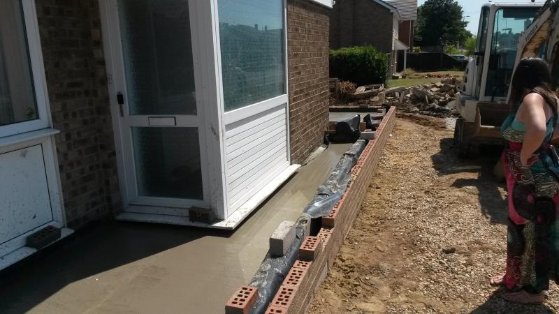

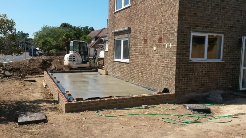

The weather this week has been fantastic and it has allowed the guys to crack on. We had the building inspector out on Monday and he was happy with the foundations and gave the go ahead with the concrete pour. The drawings from the architects which I think I have mentioned before were very poor and unfortunately this left some confusion on exactly where the main RSJ would sit. Fortunately I noticed before the concrete was done that there should be another supporting wall which has not been put in yet (the foundations fortunately were there). The builders shuttered off this section so it can be built later and the concrete floor was poured on Tuesday.

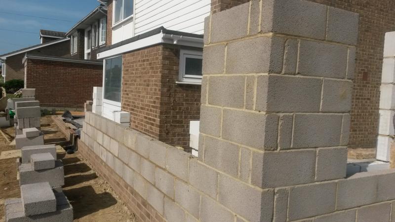

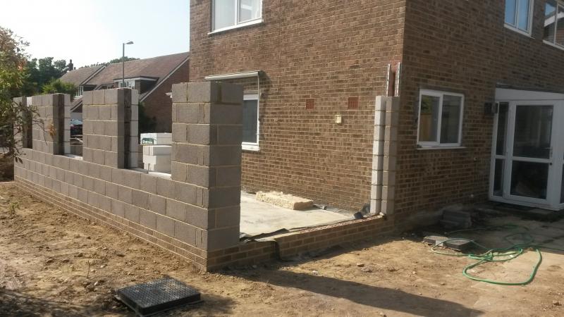

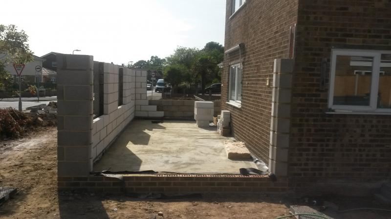

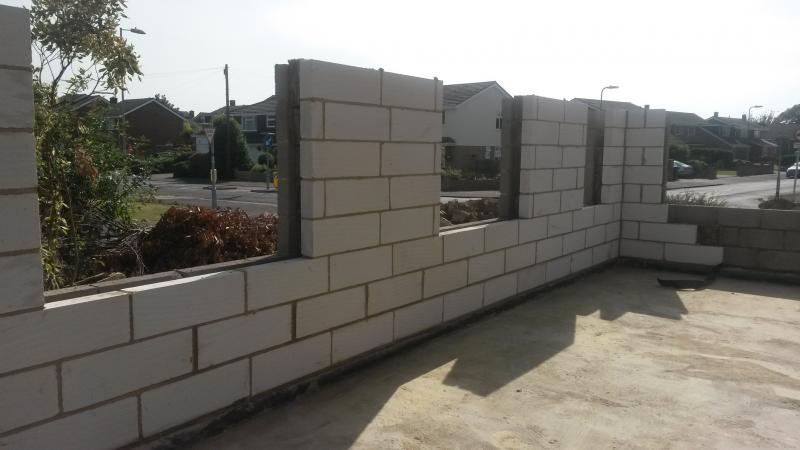

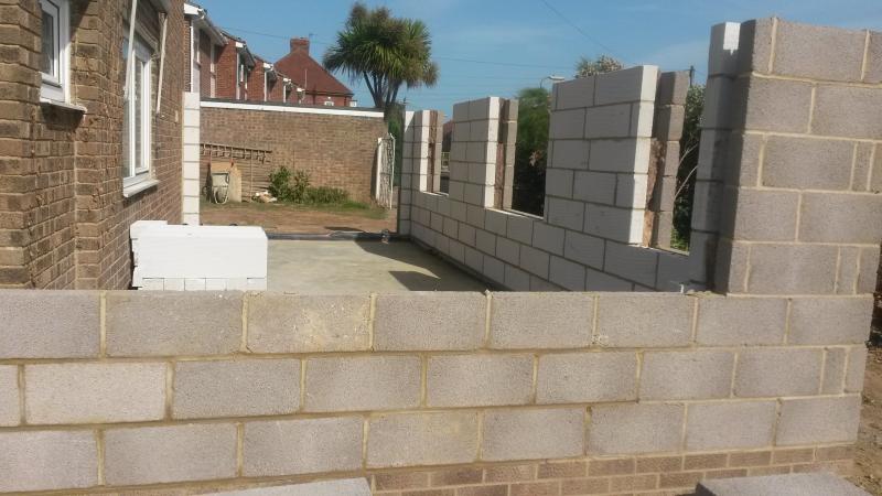

Thursday and Friday. - The buiders did tell me that when the blockwork starts it doesnt take too long before it really starts taking shape. They were right. In 2 days it now looks like this
So far it has been a really fun experiance. It isnt without its problems though and I am fortunate enough that I can be on site within 10 mins at any point to sort out any issues. The main one we have had this week has been again down to the drawings. The plan drawers seem to have drawn the plans but some of the measurements are off and they have had no regard to how the structural side will work. What this meant is out back doors will not be a maximum of 2.8m rather than 3.2m. Not a massive issue but since I thought 3.2 was a little on the small side I didnt want to lose any more.
THe other issue we have had this week is that the structural engineers have mis calculated a RSJ (it wasnt big enough to hold both internal and external walls). This meant the beam allowing us to put in the back doors has to be re designed which in turn will cost me more. The structural engineers dont seem to want to take any responsibility for the mis calculation.
Anyway before I sent everyone to sleep, that is where we are as of today. Im really excited to see what it will look like after next

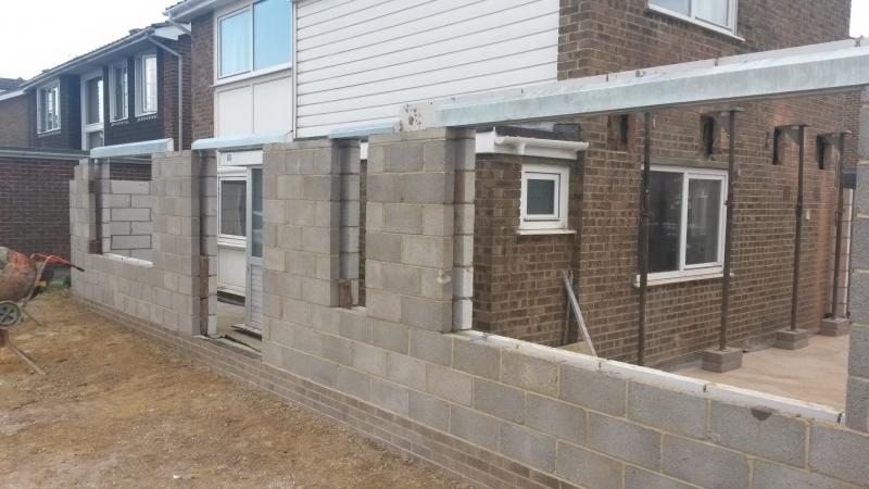

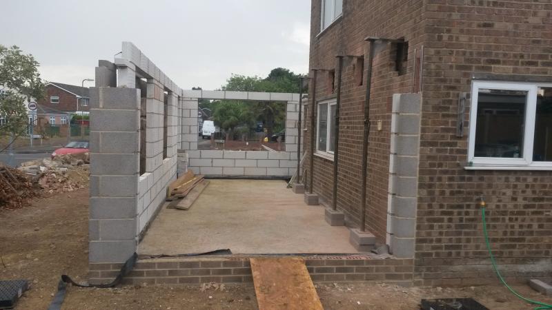

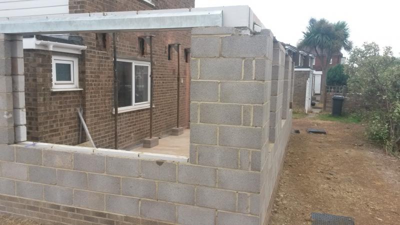

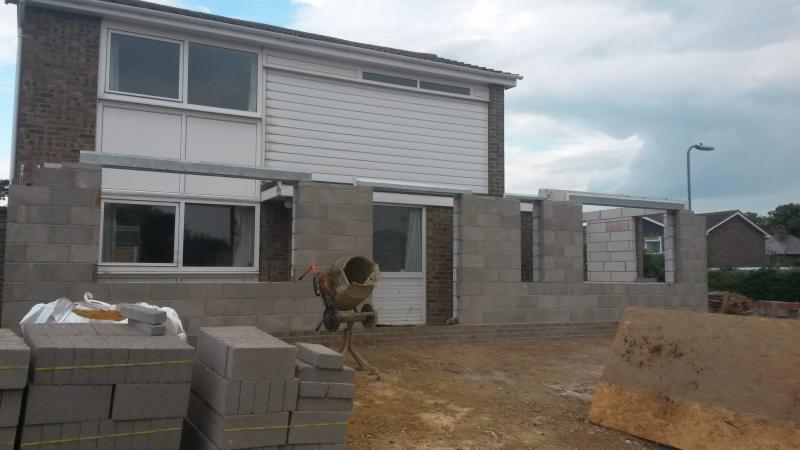

Week 6 has seen reasonable progress. The kitchen inside has been removed and a few holes have been made in the outer wall. We have come across a few issues with the structural calcs which are still trying to be resolved.
The block work has continued and now the front has been nearly completed. The scaffolding was supposed to have arrived by Thursday however they we're let down at the last minute and now I believe there may be a slight delay as they frantically try and find another supplier. I don't know how quick this will be as my dad only last week had some scaffolding which he had to wait ages for.
Anyway here are some pick of where we are up to.
You are determined and you are getting there. What a clean and tidy site - brilliant, clean sites cut down on mental wear and tear.
What eventually happened to the drainage and manholes within the footprint? I can see two manholes outside the footprint at the rear of the property but presume that they are historical?
Could you perhaps post pics of where you've opened the main house cavity, and pics of views along the main extension wall at lintel height?
Hi Ree

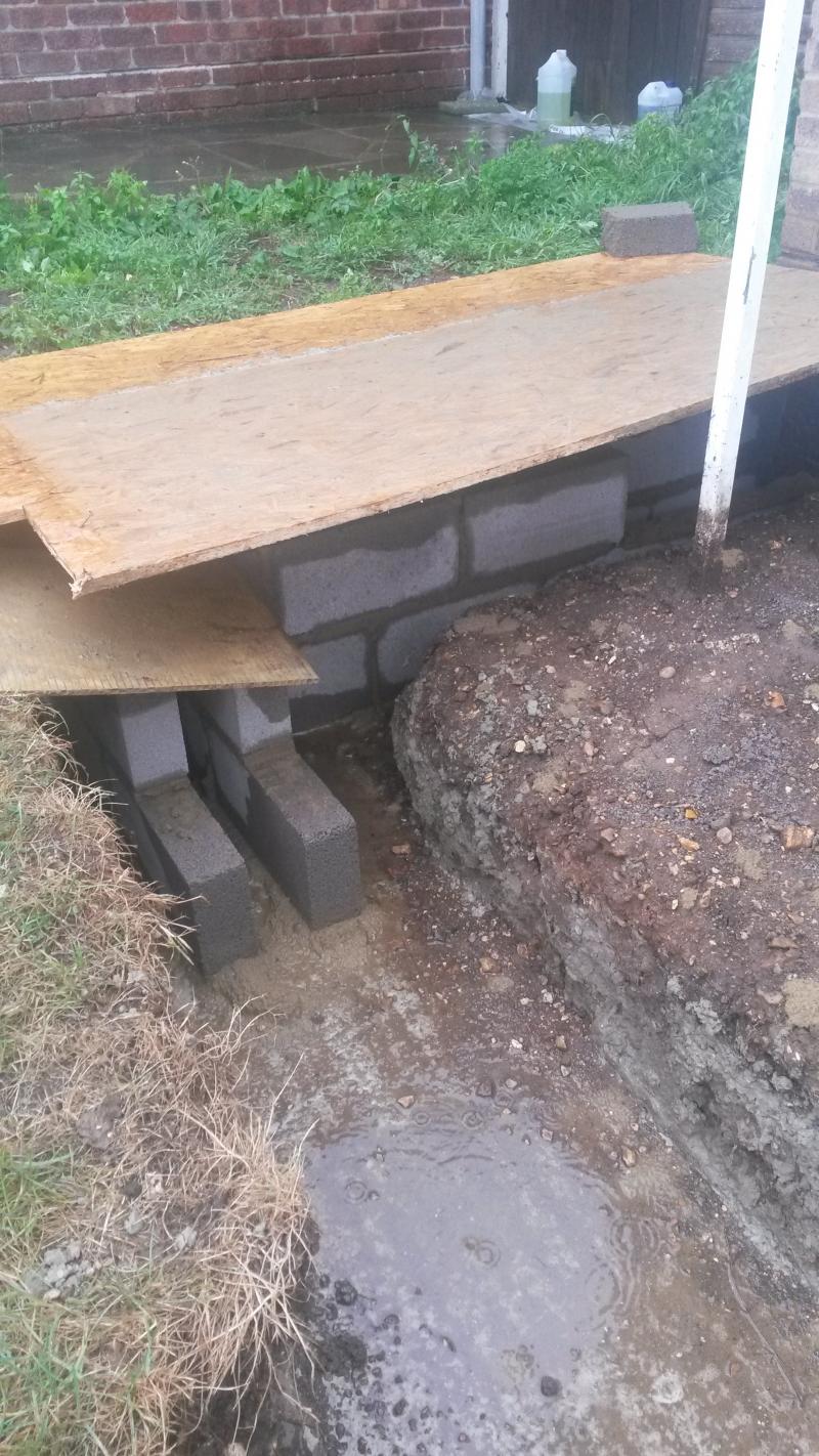

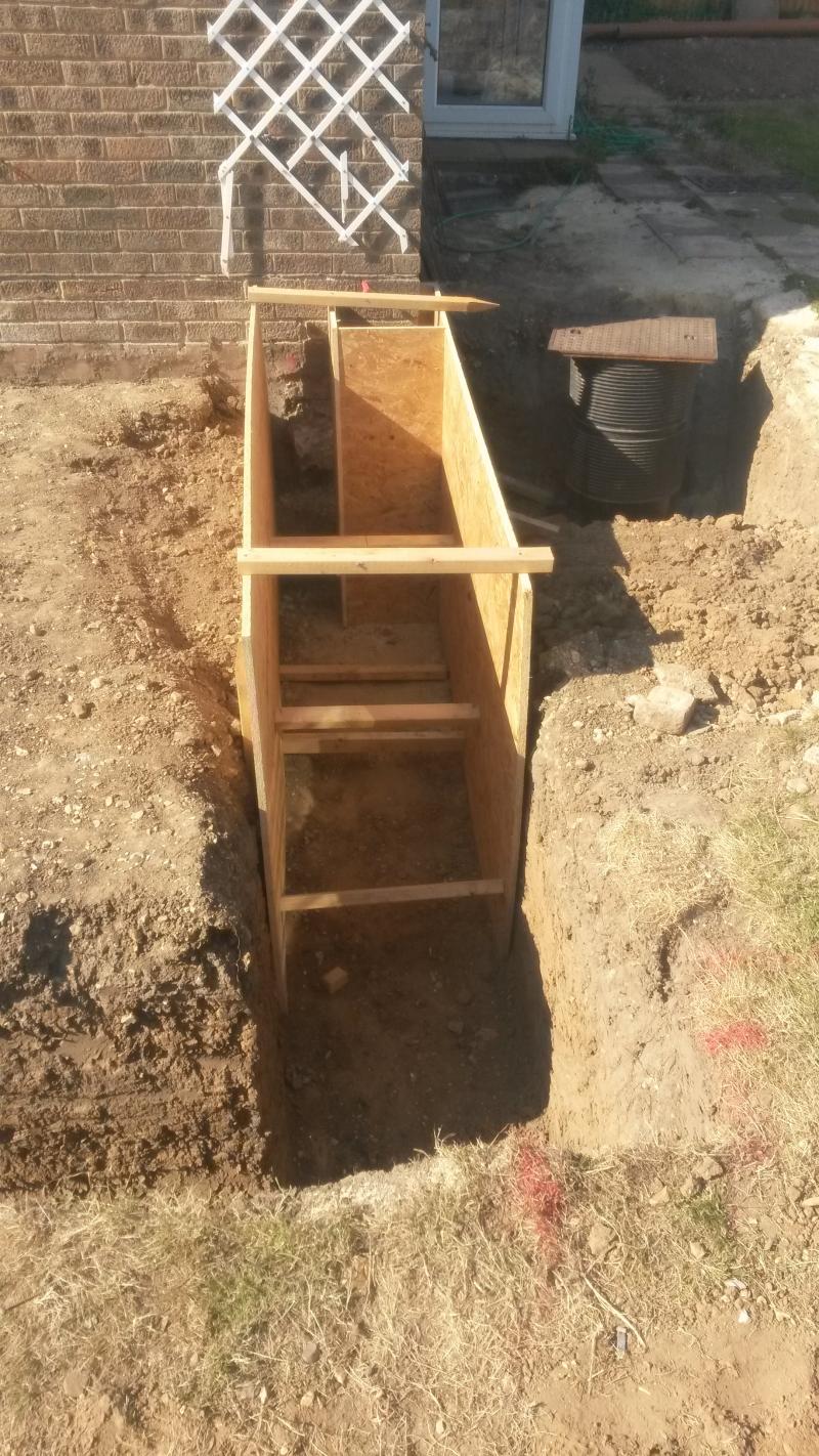

There was originally 1 manhole which was where the foundations for the new extension was to go. If you check back through the previous posts you will see where this was removed. It was then shuttered up prior to pouring the foundations.
There was another manhole which was removed which was under where the floor of the side extension currently is. It was only being used for a downstairs toilet.
On my last post in picture 1 and 2 you will see all of the new manholes (just). There is 3 in total and all have black tops. I will get some pics of the cavity holes and top of the lintels when I'm next on site.

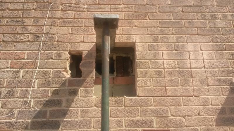

Hi Ree
As requested here are some pics of the holes in the main wall to expose the floorjoists. As I am writing this I think I may have misunderstood - were you after a view into the cavity of the existing house??
Unfortunately I cant quite reach high enough to get a pic along lintel height. Is there anything I need to watch out for?
