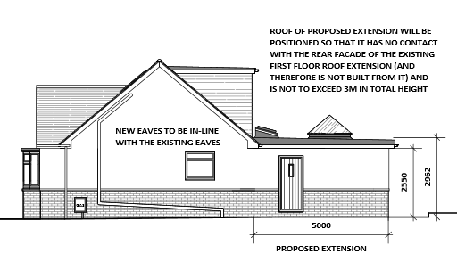

Our draughtsman has suggested the below submission, so a flat roof design with no contact with the rear facade of the dormer
However i have a concern regarding eaves height. He has said in the draft application that he sent me that the document will be submitted with an eaves height of 2.962m (the top of the flat roof) instead of 2.55m (the underside of the soffit). The reason being is that per the PD technical guidance the top of a flat roof is considered the eaves (i have checked and the guidance confirmed it). I therefore think we are back to the same issue as before, ie the eaves of the extension will be considered higher than the existing eaves, even though visually the soffit is visually in line with the original building.
Anyone have any experience of flat roofs and PD and how the eaves will be interpreted.. Obviously from a visual and practical aspect if we have to reduce the ceiling height to accommodate the top of the flat roof as 2.55m it's going to be ridiculously low and look out of step with the eaves of the existing property.

The drawing looks incorrect as a flat roof never lines up with the soffits of a pitch roof. If it did, the flat roof fascia will be about 500mm deep if ceilings heights are kept the same, or the ceiling height will be about 2100mm if you have a fascia depth as drawn

Flat roof eaves is the top of the flat roof, and house eaves is the underside of the tiles - the soffits or fascias are not considered. So that new design fails on that. Your plan drawer should have known that if he was supposedly working on a PD compliant design.
You need to have lower eaves, and a part hipped roof as in the original design.

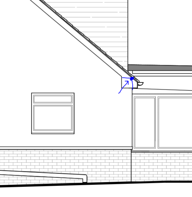

Per the guidance the existing eaves would be 'the point where the extenal wall would meet (if projected upwards) the upper surface of the roof slope'. I think the top of the flat roof would only need to come down approximately 10 cm or so if we deemed the point below as the existing eaves.(Note snip below is from existing)
You could move that blue dot upwards to the top of the roof tiles as that is the point the eaves is deemed to be for this purpose IIRC.
Has your designer actually worked out the roof construction? That's a long span and it will probably need 220mm joists. With insulation and whether vented or not, then the roof could be quite deep. So if eaves (and ceiling) height is crucial, then you need to be certain that the roof can be built exactly as drawn.
Woody, just checked the guidance and yes you are correct, so yes slightly higher is allowed.
To be honest we've not even looked at the technical aspects re building yet, this whole process of applying and waiting is enough for now. I see little point in investing more cash on techinical drawings if we're not even sure we can get approval. But taken your points on board re the roof construction. With the large roof lantern I think that will open the room height up quite a bit, even if the rest of the ceiling is fairly low. Also, what the drawings show (which i haven't uploaded) is there is a step down to the extension floor as its a bit lower than rest of the house (not massively but enough to provide a bit more ceiling height).
