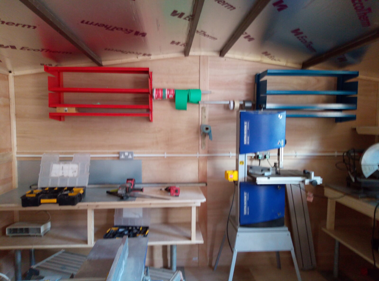

The shelving proved too high and awkward, so cut them down to below working height. Recylcled them and fitted to the wall. Then fitted some metal sheeting for extra protection.

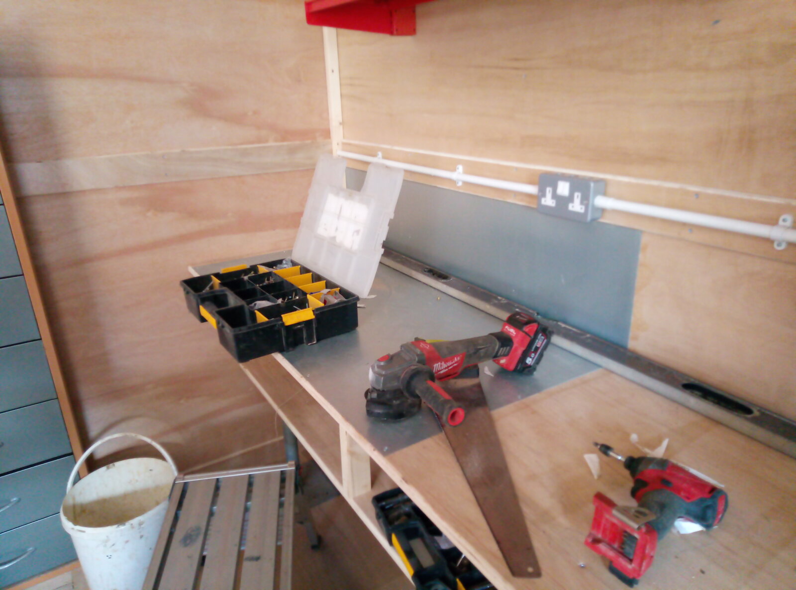

Sheeting also worked well here. Got socket power up and running but still need to sort out actual supply cable. Have consumer unit running off fly lead at the moment.

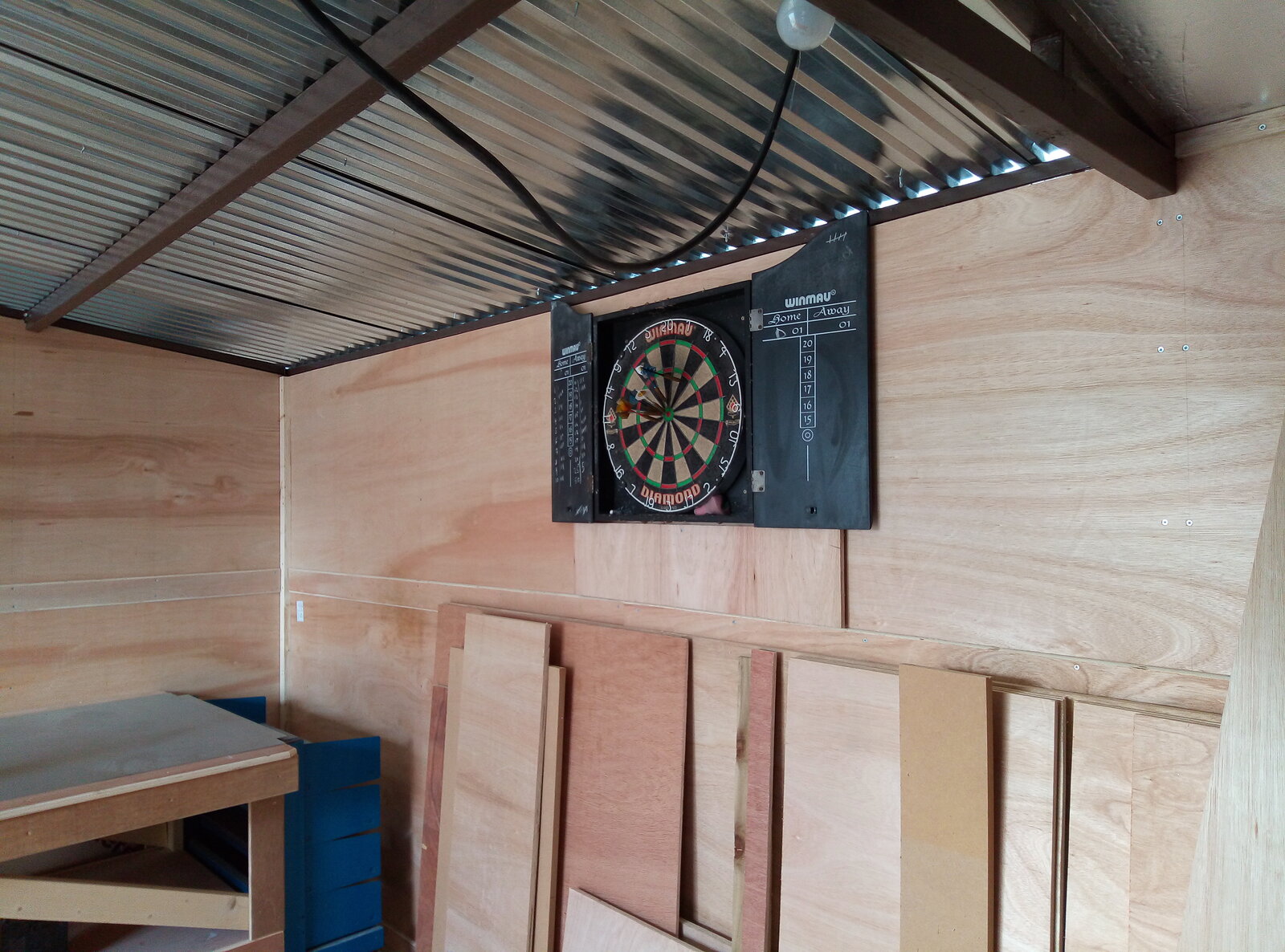

be very very careful hanging anything heavy off the walls as metal sheds will be more like to deflect as the actual frame is taking the full load where as a clad wooden shed spreads the load a bit better
also avoid heavy wall loads near door openings
