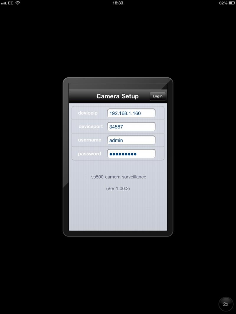

The DVR itself is made by 'Sentient' who are a Chinese company from what I can see. It is easy enough to set up, which is convenient as the manual is not really worth the paper its pigeon English is written on! You must set up port forwarding on your router if you want to view remotely - this DVR works on port 34567.

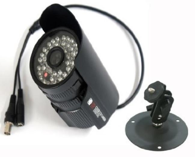

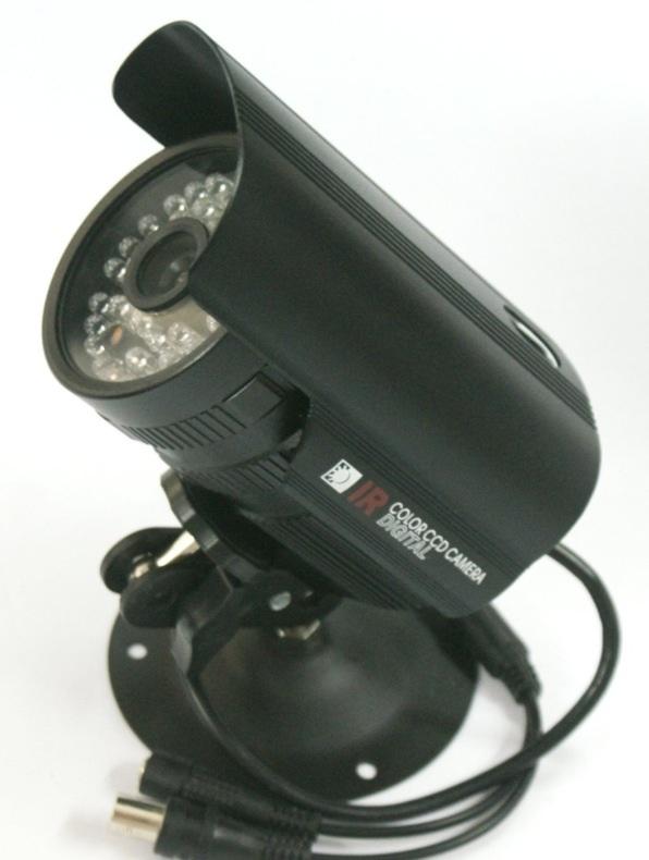

The IR camera is OK, picture quality could be better though. I purchased a 1/3" Sony 48IR LED camera from EBay too and the picture quality on this is very good for the £20.99 price!

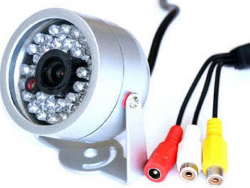

To finish it off I have now ordered another Sony camera at £20.99 and a smaller camera for £9 as the range on this only needs to be short to look down from above the back door.

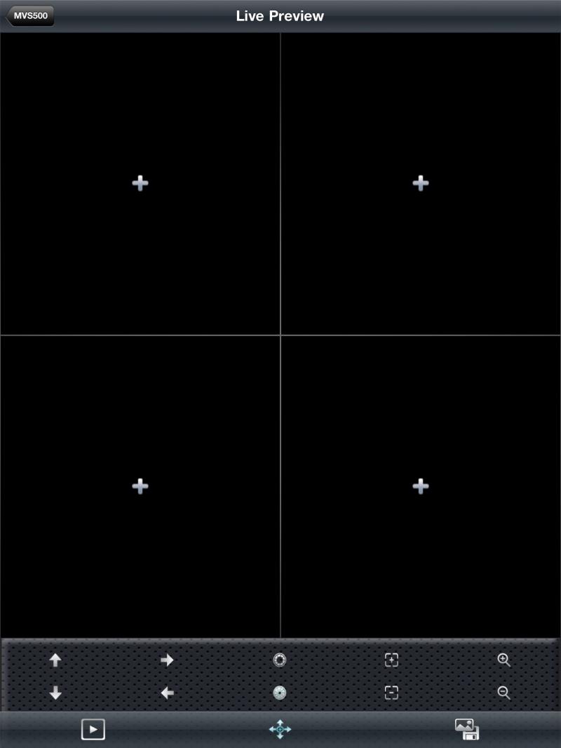

- limited to two Apps currently, both leave a bit to be desired if I'm being fussy as the official App VS500 on iPhone does not have an ipad version, can only view one camera at a time and only saves one DVR setting. There is a new App that I'm playing email tennis with the Chinese manufacturer about at the moment. This is MVS500 and has all the missing features, I just cannot get it working at the mo; will update when I do as they are waiting for their developers to return from Chinese New Year
