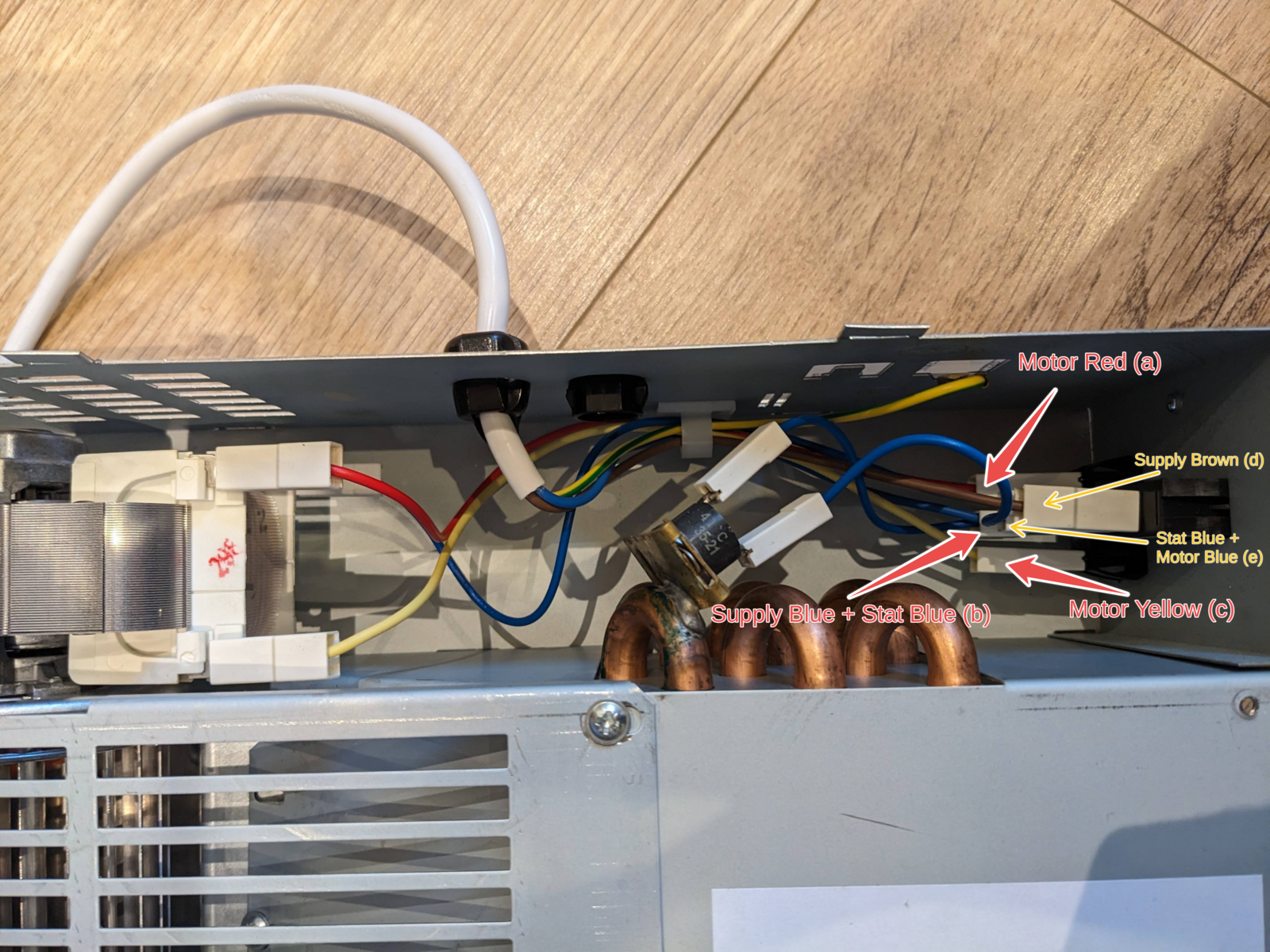

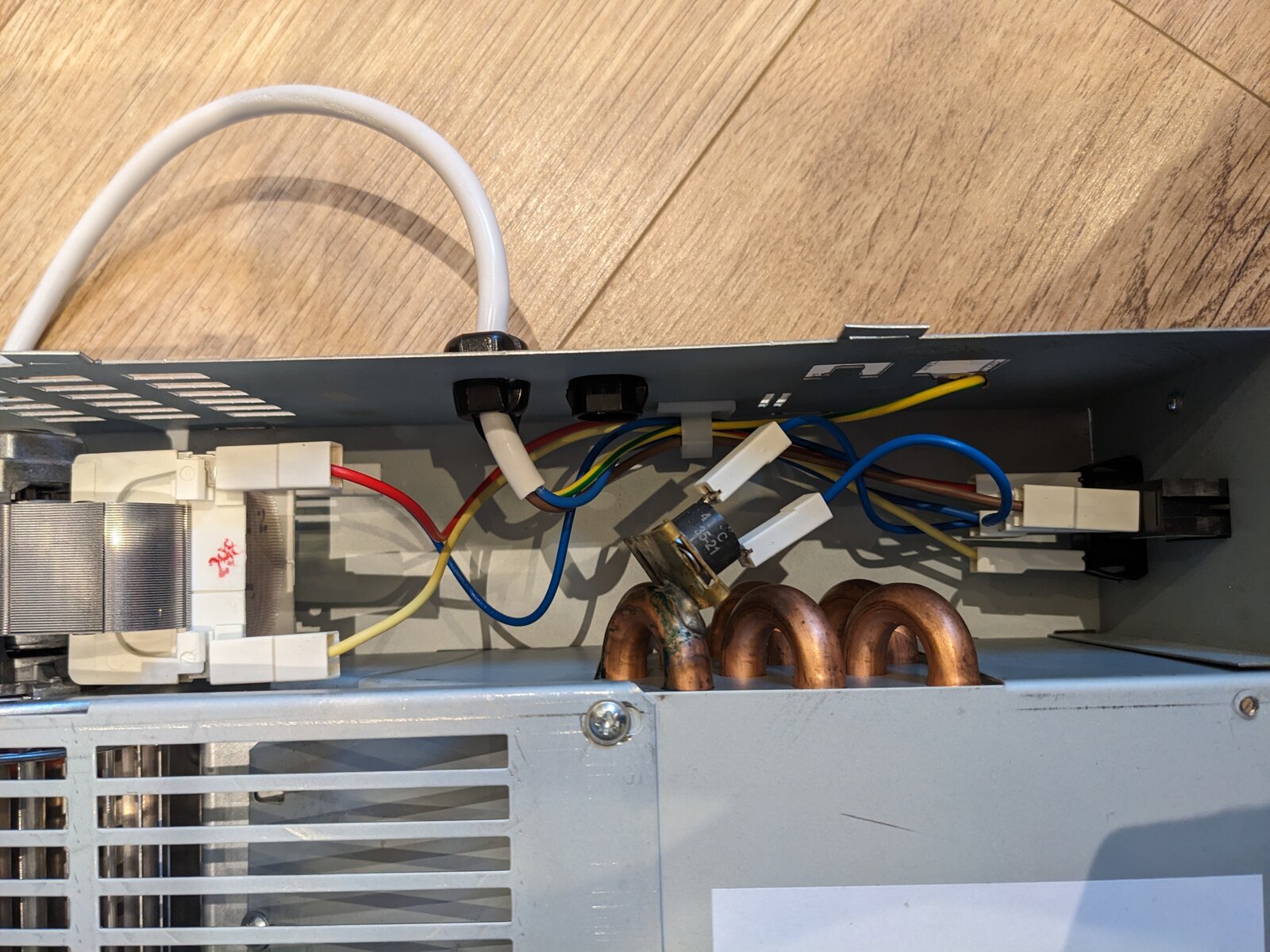

I've just installed a new Myson Kickspace 600 plinth heater. The heating side of it is working fine - gets good and hot throughout all the pipes. In terms of the electrical connection, it works fine before I turn the heating on. In Summer mode, the fan switches on successfully. However, after a bit of trial and error, it seems that when switched to Winter mode and the heating is turned on, the fuse blows when the heater reaches temperature and the fan never turns on.
I've tried both hardwiring it to a switched FCU as well as putting a 3 pin plug on the flex (with a 3A fuse). Peeking inside the unit, I can't see any damaged wires or any obvious damage.
What can I do to further isolate the problem and go about fixing it?

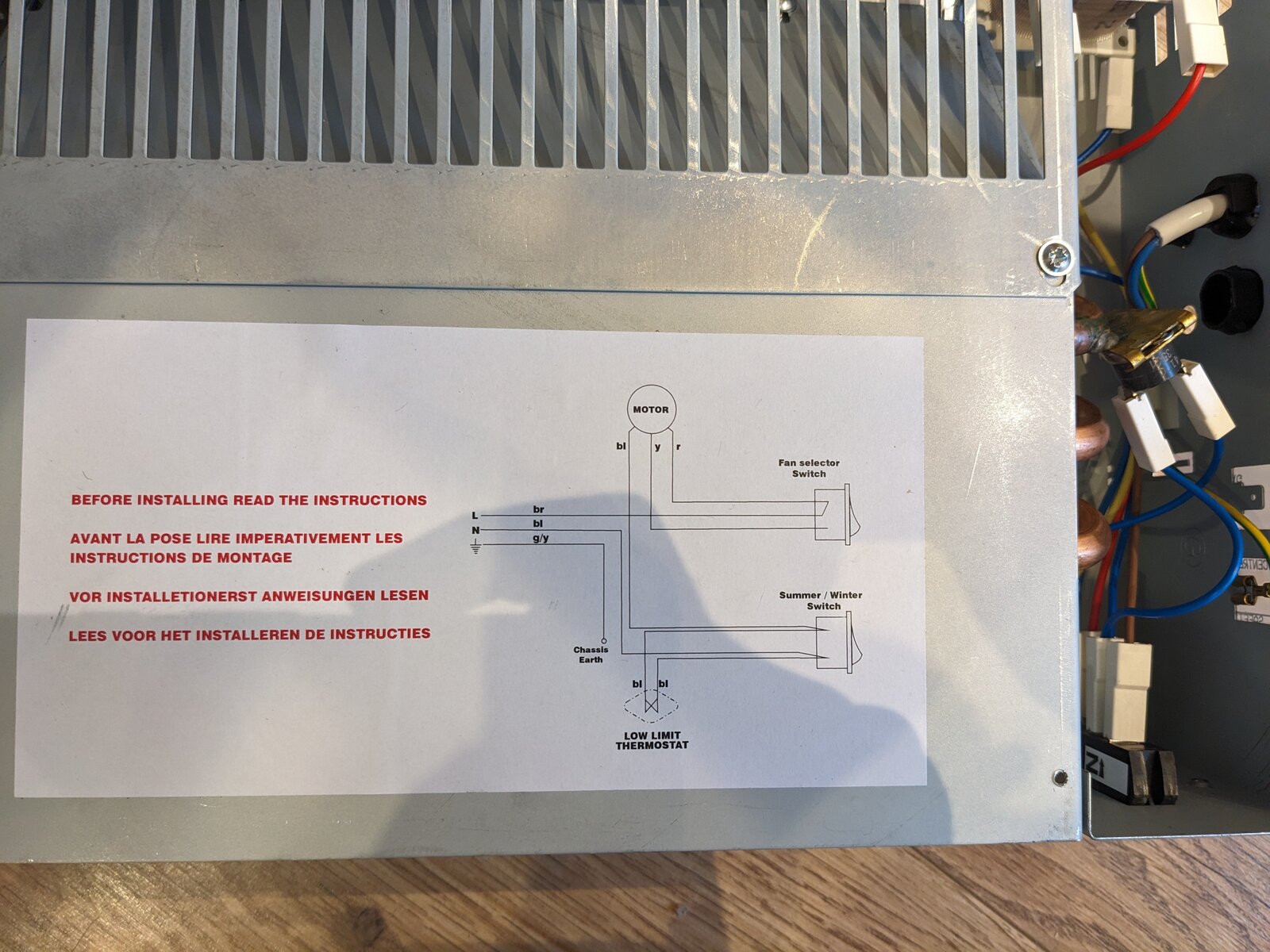

As Eric said, & according to the circuit diagram, it would appear to be the stat or the wires leading to it. Try disconnecting it & shorting the leads together. If it still blows try disconnecting the black lead to the fan & if it's then OK it would suggest the fan is faulty

@michael123123 The wiring looks differnt from the drawing, but I can't properly see what goes where, particualy the blue cores and the layout of terminals on the switches, could you annotate to show where conductors are connected, and take a pic with the camara above the motor looking at the back of the switches.

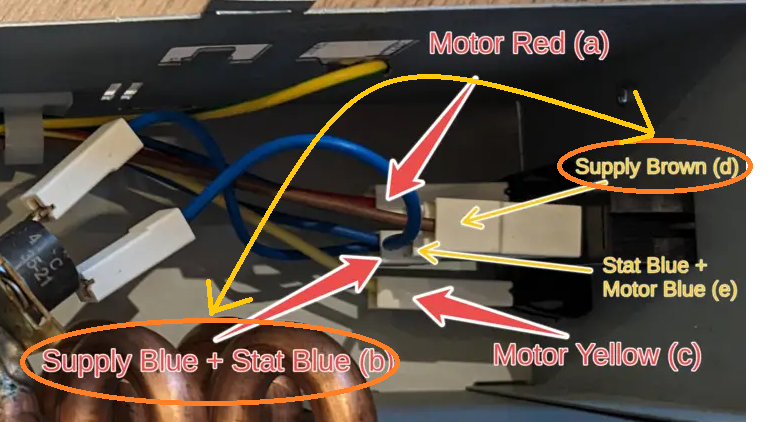

That's an interesting observation... I've labelled the wiring in the attached photo. For reference, the red arrows correspond to the fan selector switch and the yellow arrows correspond to the summer/winter switch.
It looks like connectors (b) and (d) are swapped! In its current configuration, when it's set to winter and the thermostat switch is closed (i.e. up to temperature), the thermostat loop connects the supply live and neutral. If my understanding is correct, then that would cause the fuse to blow.

Another thing I just noticed is the is an "N" with an arrow labelled on the summer/winter switch visible in the wiring diagram photo. This label appears to be pointing to stat/motor blue wires, but I wonder if the supply (neutral)/stat blue wires should be attached to that terminal.

If the unit is wired according to that diagram I see nothing that can give the symptoms you describe other than component failure and the only component I can envisage doing that is the thermostat. I imagine it may be shorting to the metal case when it operates. It's a bit tricky from the photo but are you able to verify it is all correct?

Thank you again for your Brilliant annotation and Adam (now that I've checked more of the thread). What has happenned is a silly 'schoolboy error' during manufacturer; the connectors on the supply cable are on the wrong terminals, the whole of Supply Blue + Stat Blue (b) needs to be exchanged with Supply Brown (d).
