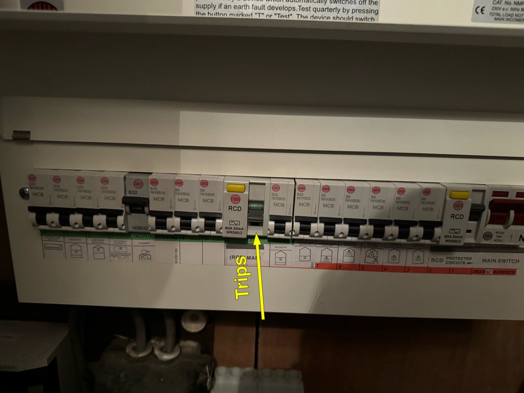

I had electric underfloor heating cable and thermostat installed many years ago. It was a loose cable with Heatmiser thermostat. It’s been working fine all these years until September last year when I had issues with it whereby the fuse would trip if I tried to switch-on the the underfloor heating. I recently called an electrician over to take a look and all the cabling from switch to the thermostat was fine and whilst the thermostat was off the wall he tried switching it on and by magic the heating was working fine and it did not cause the fuse the trip. After, about 20 mins of running the heating it was switched off and everything put back together as the electrician had other work to get on with. At the end of the day, he tried switch on the heating using the thermostat and the fuse tripped again. The assumption after some diagnosing was that the thermostat had a fault so it was swapped with the thermostat from another room (this wasn’t a Heatmiser thermostat). This worked for 2 months and now I have exactly the same fault causing the fuse to trip if I switch on the floor heating.
I called the electrician and he is very confused that it worked for 2 months and the same fault re-appeared again. Could it be that this thermostat has also blown?
Are thermostat specific to type of cable or power etc?
I’ve run out of ideas as everything that you can physically see is fine (according to the electrician) and if the heating has worked for two months after replacing the thermostat so it can’t be the cable itself.
Any one come across this or has any pointers or ideas?
Thanks v much

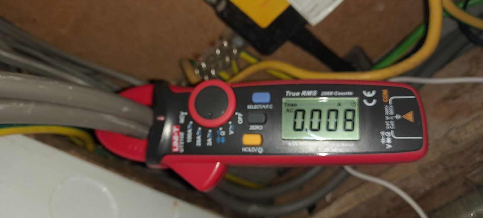

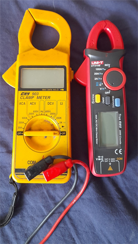

If it is the RCD tripping, an electrician should have one of these 20221008_131741.jpg the top one will measure in 1 mA increments, the bottom one is rather old, so 10 mA increments, so he should have been able to see how much each circuit is leaking.
The main problem is neutral - earth leakage, earth with no load will be the same voltage to neutral, so even with a short circuit it will not trip the RCD, but as the load increases voltage between neutral and earth will increase, so a fault on a toaster may trip the RCD when the kettle is used, which means we need to test with 500 volt earth to neutral clearly with main switch off, with a meter like this VC60B.jpgagain an electrician will have these instruments, years ago we would

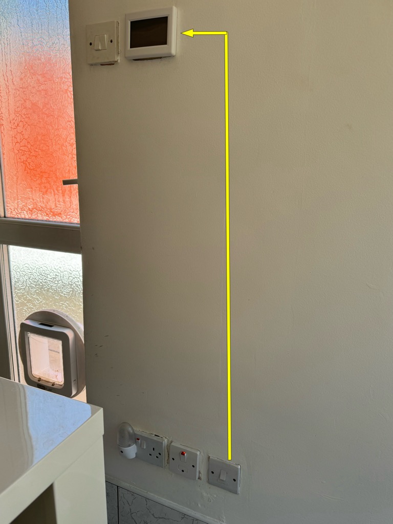

Hiya and apologies- have added these pictures and can add more if needed
The arrow shows the switch from where the power cable is going to the thermostat and the other picture is the RCD that is tripping.

Yesterday morning the RCD tripped only after trying to put the UFH on using the Thermostat. As soon as I did that the RCD tripped. To reset the RCD I had to switch-off the switch that’s powering up to and beyond the thermostat.
After resetting the RCD, if I flick the switch to on then the RCD trips.
What I am trying to explain is that the RCD tripped for the first time when I used the thermostat to switch the heating on and after resetting it- the RCD trips as soon as I flick the switch back to on position.
The electrician that came over to look had removed the thermostat and tested the cables in there and they all tested fine and soon after he put it all back together it worked fine. Few hours later, he tried to switch it on again and the fault reappeared which is what prompted us to change the thermostat and in doing so it worked for best part of two months only for the same symptoms to reappear.
Does this help?

You could be suffering from accumulated leakage. One of the huge down sides of dual RCD or single RCD boards
This happens when more items are switched in that contain electronics
You need somebody with an earth leakage clamp meter
Next time this happens, switch off all the MCBs to the left of the RCD which has tripped, then turn back on the circuit with the underfloor heating
Also and very importantly what test results did the RCD give when it was tested? It could be over sensitive too

Thanks @Murdochcat
I don’t know about the test results for RCD will need to check with the electrician.
I will try out what you have suggested but this has been the setup for best part of 10 years with underfloor heating being in place for as long as that but I will try it out. When I took the pictures to create the fault none of the appliances or switches controlled by those MCBs were in use.
One thing I did struggle with when I took the pictures was that I could not put the RCD back on - it just wouldn’t stay put and after 10 or 15 attempts it decided to stay put. The heating switch that caused it trip was off so it had no reason to not stay put.
Earth Leakage Clamp Meter , what defines the "earth leakage" part of the name compared to a Clamp Meter ?
I just thought that a clamp meter is a clamp meter and depending upon its range, resolution and accuracy then it can be used as the user decides
By definition a clamp meter which measures accurately a low enough current so that it may be used to measure what we call earth leakage in connection with RCDs.
Clamp-meter-small.jpg Both are clamp on ammeters, neither has earth leakage in its name, one on the left will also measure frequency, but AC amps only in 10 mA increments, one on the right will measure both AC and DC amps, in 1 mA increments, and also non-contact AC volts. In theory the limit for background leakage is 30% of the RCD rating, so with a 30 mA RCD that's 9 mA, so would need to use one on the right to show if within limits. However, 10 mA is not far off 9 mA, but it can't show the 3.5 mA limit before special plugs and sockets are required. So the yellow one would not show the 8 mA shown here. Diffrence line neutral 8 Feb 24.jpg But it seems many electricians think the insulation tester is good enough, but this meter VC60B.jpg only measures DC and our mains is AC at 50 Hz, so leakage due to capacitive or inductive linking will not show up. When the RCD will not hold in, then no option but use the insulation tester with 250, 500, or 1000 volt DC, but when at a stage when it only trips every so often, what we are looking for is the cumulative leakage from many items.
