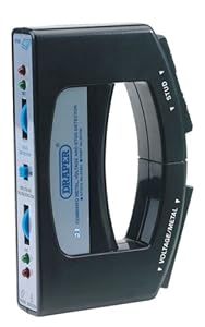

What wonder methods do you recommend then for finding plastic pipes hid behind plaster board?
No chippy is gonna start faffing around with one of those to find pipes.
Not unless someone points out to him that a pipe run is behind the plaster board and even then he'll probably just get the glue out.
I have that thing in the image and its useless.
Try this mebbe.. http://www.youtube.com/watch?v=QNHZH0egIfU
I use miniature neodymium magnets to find studs.

A bit of a debatable point, but if he was a chippy I would have thought he would have had a stud/metal detector in his tool bag, (they are cheap enough these days )
The GMS 120 in drywall mode will detect a plastic pipe behind plaster board but gives the same indication on the screen as for a stud.
It will pin point the centre accurately.
So the nailer can then nail straight through the pipe . :LOL:
When the pipe is within 70mm of the stud it then becomes invisible and only the stud is detected.
When foil is on the plasterboard then all the readings go up the left.
