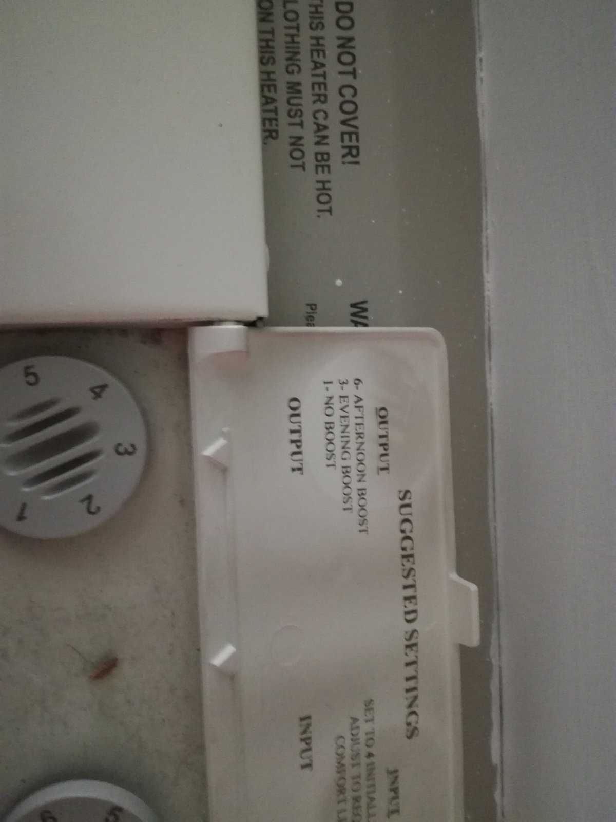

My daughter has moved into a flat with 4 storage heaters and economy 7. They are all NC xxxx auto and one also has a convection heater built in to it. I understand that the input control is simply a thermostat that controls the temperature of the core and therefore the amount of stored heat. The output control is marked 1 to 6 with 1 being No Boost, 3 being evening boost and 6 afternoon boost. I do not know what this control is actually doing and whether any kind of timer is involved. Can anyone explain it to me please or possibly point me to a user manual or exploded diagram? Thanks Dave

Thanks for that info. I will get her to do the turn them all up full to test all elements. Still not quite clear, presumably the bimetal strip is in the air inlet so opens closes vents according to room temperature. 1, being no boost means flaps are fully open and heat is soon lost. 3 partly open therefore some heat remaining for the afternoon. 6 fully closed therefore some heat remaining for the evening. The problem with that is that 3 is shown as evening boost and 6 is afternoon boost which is the reverse of the logic above. Sorry if I am being dim here. Cheers
1 = fully closed and will never open. This is what you want. Mechanically inside it is the strip not being used at all and the flap held closed by gravity.
On the other settings the strip will operate the flap, it will be closed when the heater is hot, but will open at some point as the temperature falls, usually when you don't want it to. When open, heat is lost very quickly.
6 is intended for use in offices and similar, and will result in all of the heat being output during working hours so there is little or nothing left by about 6pm.
Thanks very much. Now I get it. 1 is fully closed no boost means no heat allowed out ever rather than no heat left for a boost. All makes perfect sense. Cheers
