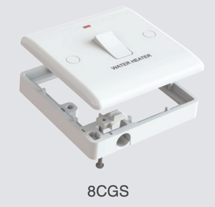

Hi all,
I'm wiring a bedside wall light that comes with a standard plug into two way switching. I want the most unobtrusive solution as it will be right next to the bed.
Would this be okay to go behind an MK double grid switch and an MK double switch as it says it's designed for FCU/20A switches?
https://www.bgelectrical.uk/wiring-devices/moulded/surface-boxes-blank-plates#8CGS
My main concern at the moment is whether it would foul the mechanism but there may be other reasons not to do this.

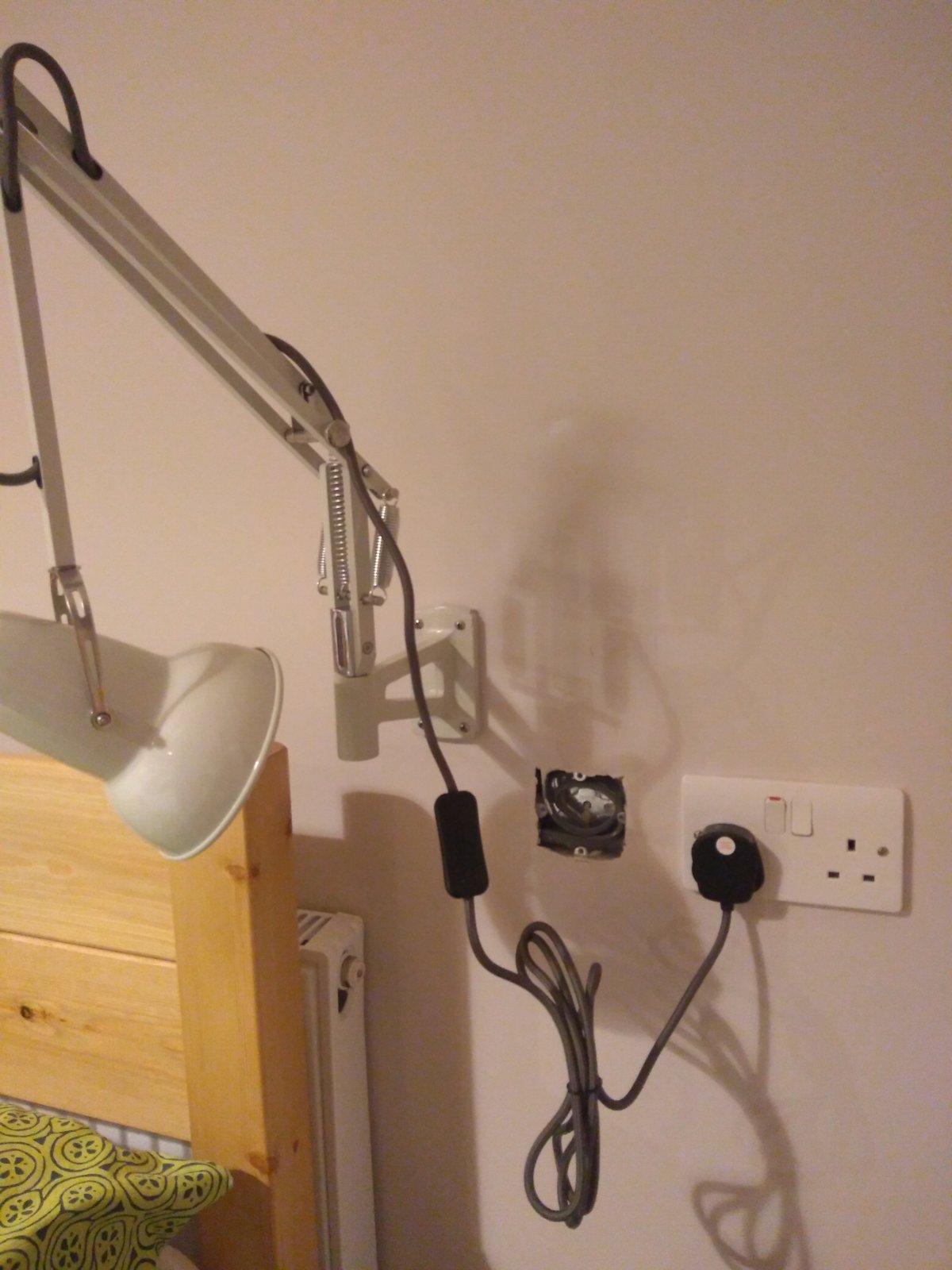

show us a picture of your lamp please.
I understand you to mean there is no cable or outlet in the wall so you want to fix the lamp to the wall and have the lamp flex dangle down and plug into a socket. Is that right?
Se above. There are cables ready in a backbox in the wall, there's no need for the lamp to be unpluggable, and I'd rather not have the flex dangling more than is necessary. I'm looking for the neatest way to get the connection into the backbox (that is safe).

A switched fused flex outlet would be suitable, if the wall box is spurred off the socket circuit. There is no need for a torpedo switch.
Buy some white flex.
Drill a hole in the lamp base for cable.
Would that be okay with no specific strain relief? That would be the best solution assuming heavy cast iron is easy enough to drill.

I am indeed struggling as you correctly observe! A plain wall is the least ugly in theory.
Actually it's going to be on the lighting circuit, the socket is on a different circuit although the wiring is all in the same chases.
Then a simple flex outlet would do, but has no switch, so I prefer the SFCU
Yes it would have been simpler but that wouldn't work with the two way switching. The other switch will be by the door. I'm wondering whether one of those fancy WiFi enabled bulbs and smart switches might have been the answer!
Interesting, not seen that before. I'd suggest it would be better behind a BG switch as the MK edge contour may not be identical.
