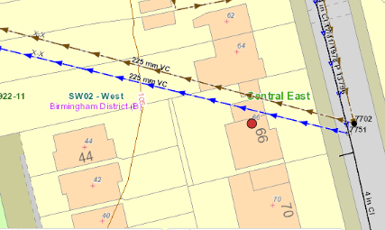

Hi guys, we bought a old 1930s detached property we knew that it would require work and we had the idea to build a double storey extension on the side.
I recently instructed a architect in this matter, we knew there was a sewer running but never knew how it would affect us (naivety..).
This is the reply ST Water gave to our architects query whether there were any public sewers running through our land:
Having reviewed our statutory sewer records, they demonstrate the following sewer with associated protective strip:
225mm foul sewer and 225mm surface water sewer
225mm diameter surface water sewer – with a protective strip of 3m either side of the pipe, thus providing 6m across the diameter to the pipe"
One of the architects team said it may be difficult to get STW to give me permission(they havent even asked!), after an email and phone call for a proper explanation he said he would contact me on Monday. I dont understand the flippant answer given by the architect.
From reading stuff on here and the internet it seems I need a Build Over agreement, is there any reason why this would not be granted?
I have attached a diagram. The property with red dot is mine. The foul drain runs under a existing neighbours extension and a previous garage which has now been demolished on my property. So I dont know how that would be a problem.
The surface water drain (in blue) seems to be the issue, however there may have been a building here in the past. Currently it is a semi permanent building (no sides just a temporary roof). According to there plans however there is a structure over it. This is where I wanted the double storey extension.
I am awaiting the phone call on Monday from the architect but it has put all my plans in disarray, from looking at my land it doesnt seem as if ever there has been any attempt to maintain the sewer from my land. The ground does not seem disturbed at all and is very old.
If I were to ask for a BOA would it be likely granted? And if not how much would I need to spend to divert the sewer so it runs parallel to the foul drain?
Really in a pickle here, unsure how to proceed.

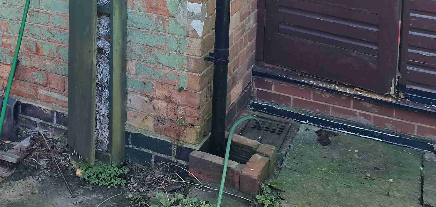

Yes its severn trent. No I cant see any drains on that side of my property where the pipes supposedly run.
However I did see one just outside my main house in my rear garden. I may take some pictures, as im not very good at these things.
I just noticed this from the surveyors report
"The rear extension and conservatory appear to have been built over a drain. The extension, however, appears to have
been built before the need for a Build Over Agreement with the local water company"
This is directly behind my house. Could the sewer infact be running under my house or is it a seperate drain? even more confused now.
Thats the rear conservatory and that wall to the left is where I want the extension. Is that drain where a green pipe is coming out of a manhole cover?
The 3-6m thing doesn't mean you can't build over a sewer - it just means anything within must be agreed before you start work. Buildover agreements aren't normally a problem but a lot depends on whether the sewer is classed as 'strategic'? These are normally 300mm and above but a 225 sewer can be strategic depending on the number of properties that rely on it. Overall this looks like standard build-over application to me.

You won't be able to see the drains they're underground! Some detective work is in order by whoever you employ.

Yes, I can see the option for 225mm sewer build over agreement. I think I'll have to contact ST water and find out if I need a class 2 or 3 application.

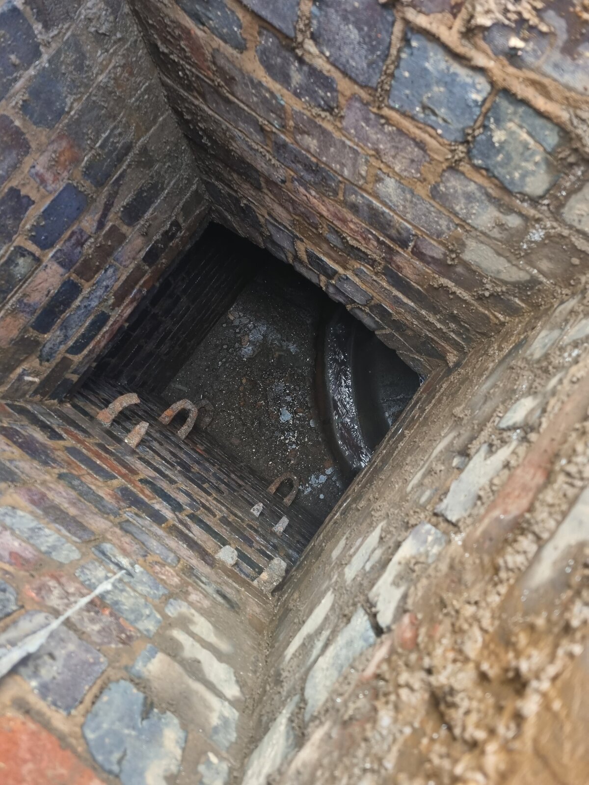

We opened the manhole in the road(3.3M Deep). From the direction of the flow of the water in the manhole it is difficult to ascertain exactly where it goes through my property. I initially thought it might have went in the neighbours, but I dont know how sewers work.
Ive attached a picture, is it possible for that sewer run to turn 45+ degrees to the right after say 5/6 metres?
Anyway water cant flow up, it only flows down or straight so that means if it does go under my proposed site of extension its 3.3M or more deep!
If that runs through my proposed site of extension I dont know what I can do to satisfy STW Build over team. I cant dig that deep right next to my house, it would put the foundations at risk.
So ive ordered a CCTV survey, another week of waiting till they arrive. All im doing is looking at pictures of the manhole all day and guessing where it goes..
