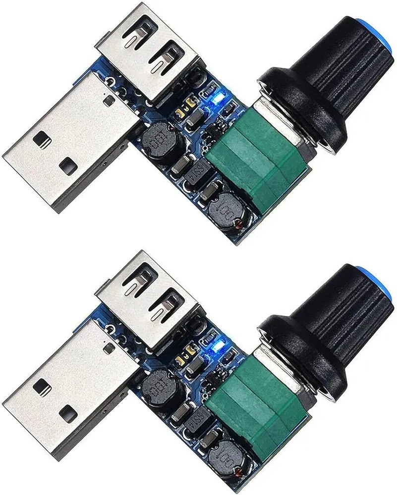

I've got some USB heated gloves
They're wired and you need to connect to a USB connection
They're brilliant!
Except they get too hot for my liking
There's no controls for turning heat up or down
Is there a device I can add tot he middle that varies the power or voltage going to the gloves?
I'm sure I've seen something like this before - i just can't remember where!
I was hoping on of you guys might know
What is the source providing power to the USB cable?
How much current to the gloves currently draw?
How much space do you have available for an adapter to go between the source and the cable?
Would you be able to build an adapter or are you dependent on hving to buy an off-the-shelf one?
Would a constant current driver work with a resistive heating element?
EDIT: no, probably not, because it varies the voltage to keep the current the same. Not really helpful here!
I was wondering if PWM would work?
It wouldn't take much to make up a simple circuit.
There are also USB fan speed controllers available...
I have no idea how well they would work.
But, it might help if the OP answered some of @Alec_t 's questions! :)
