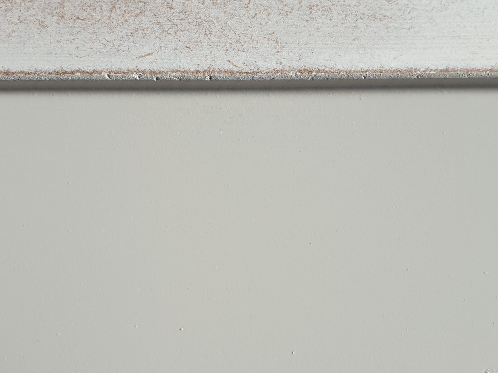

I specialised in painting MDF cabinets for about 20 years. Like the timber merchants, I used to use waterbased primer but I did so knowing that I would have to sand it back to the point where you could hardly see the primer anymore.
Contrary to popular belief, the surface of MDF is not smooth. It has a "grain", I assume, the result of wide drum sanders used in the final stages of manufacture. That grain and the fibres swell up when primed with waterbased paints.
I do not want to malign your decorator but it seems that we are trying to achieve very different standards of finish. I can only assume that we are working to different budgets and time constraints.
The following photo is an example of a worktop that I have primed with acrylic primer and then started to sand flat with 220 grit mesh. You can clearly see the "grain". -edit, it seems that this site compresses images- follow this link- https://1drv.ms/u/s!ApkFchP_5QLajd01fTLCNEh00jnibw zoom in to the left hand side of the sander and you will see evidence of parallel grooves
In the above, I used a roller to apply the primer, not something I like doing but I had run low on my supply of Anza paint pads and wanted to save them for the oil based eggshell.
The following image of a MDF shaker door shows the raised particle/grain after priming with waterbased primer. That is what the MDF architrave would look like if sanded first. -edit link- https://1drv.ms/u/s!ApkFchP_5QLajdo-BAnsuvtNOdfLbw
I am to achieve a hand painted finish that looks like it was sprayed and then someone brushed a very thin coat. You can't get tht kind of finish if you just apply one undercoat and one finish coat. I guess in theory you could apply 5 coats of oil based undercoat and sand that flat without going through the waterbased primer but that will take much longer.
If you (I) click on the small pic, it will open a large one.
Which will then enlarge further if you (I) click on the top right arrow, and then on the pic.

Sorry Johnny, I have often agreed with the advice that you have given on this site. I do not believe that you can obtain a high quality finish on an inferior product unless you either apply a lot of paint (and then sand the paint flat) or sand the original product flat.
I am stupidly busy at the moment but I would be willing, at some point in the future to post you some samples of painted MDF to compare and contrast. I will send you MDF that I am happy to sign off on and some that hadn't been sanded.
