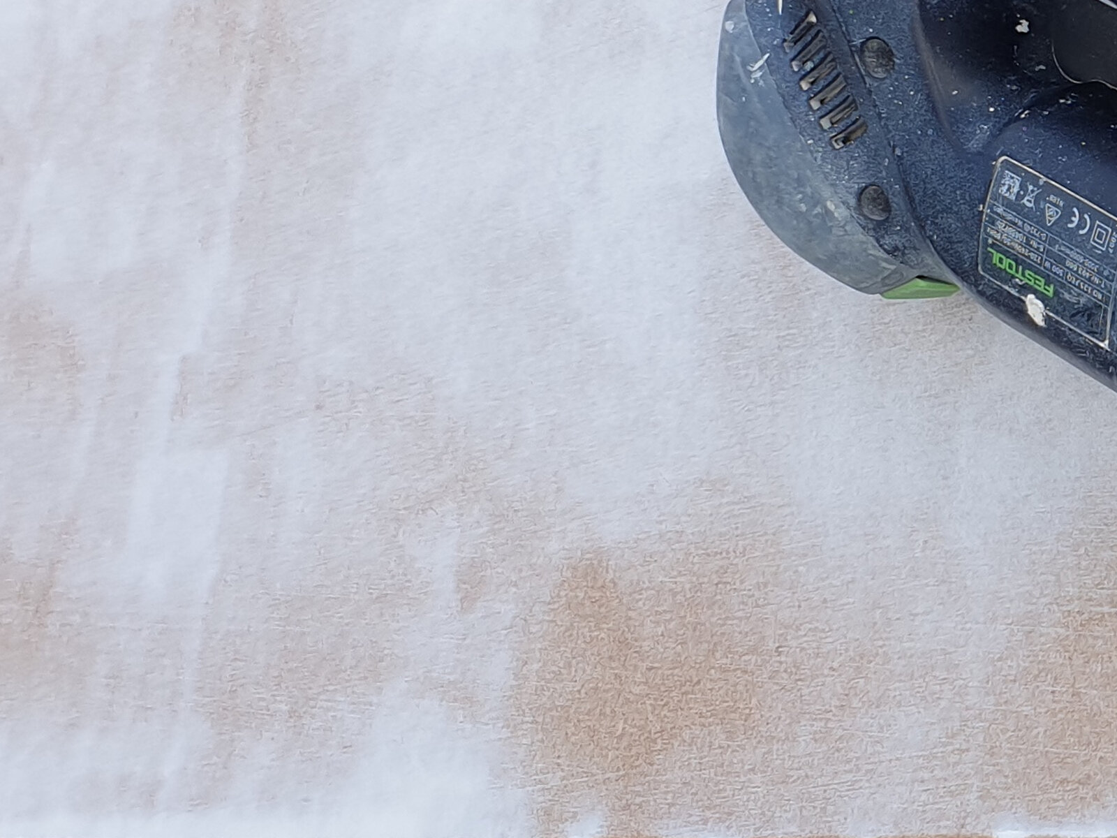

These days, I tend to (heavilly) brush on about 3 coats of Leyland Trade acrylic primer and sand back the paint build up with 180g silicone carbide paper. I use Leyland because it is one of the few acrylic primers that doesn't clog my abrasives. Silicone carbide paper is far more flexible than aluminium oxide paper. I sand until I have pretty much removed most of the paint.
Although not the edge of the MDF, the following image shows how much of the primer I sand away.
(As per the above image, it is a myth that MDF is perfectly flat- it has score marks in it from the manufacturing process. I guess the sheets run through a massive drum sander. Waterbased primer will raise the "grain" which I don't see as a problem, given that I am going to sand it flatter than when the MDF was manufactured.)
The finish (sanded edge) is absolutely fine for hand painted finishes. If spraying with 2K paints I normally hit the profiled sections with two coats and then sand flat with 220 grit Abranet.
