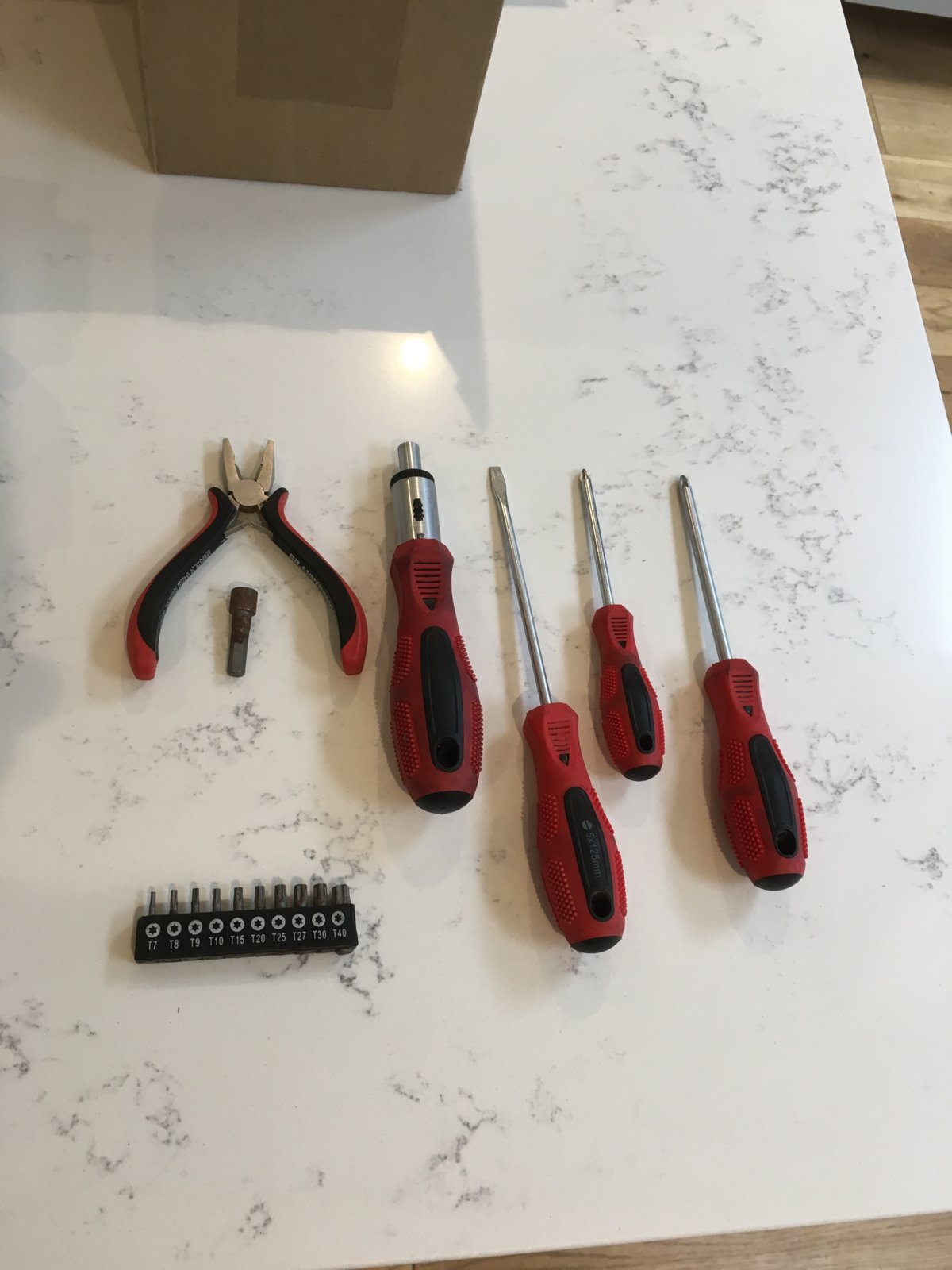

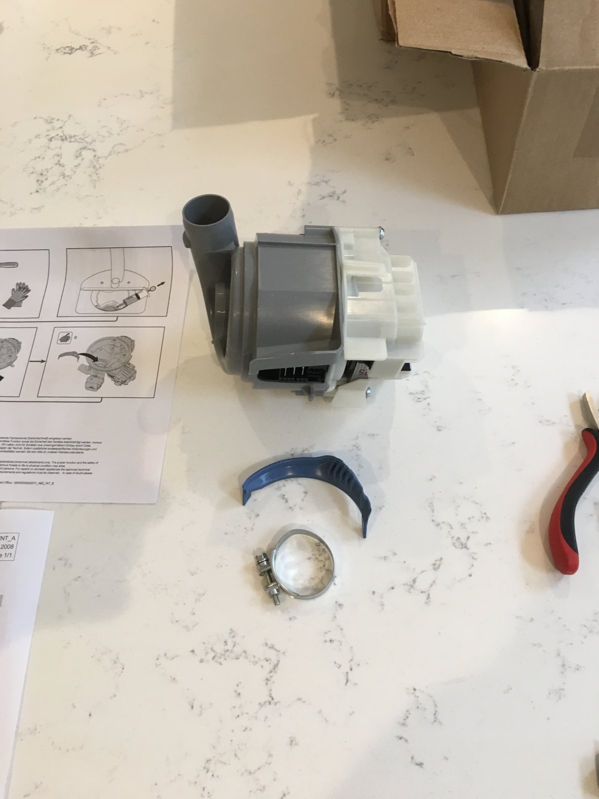

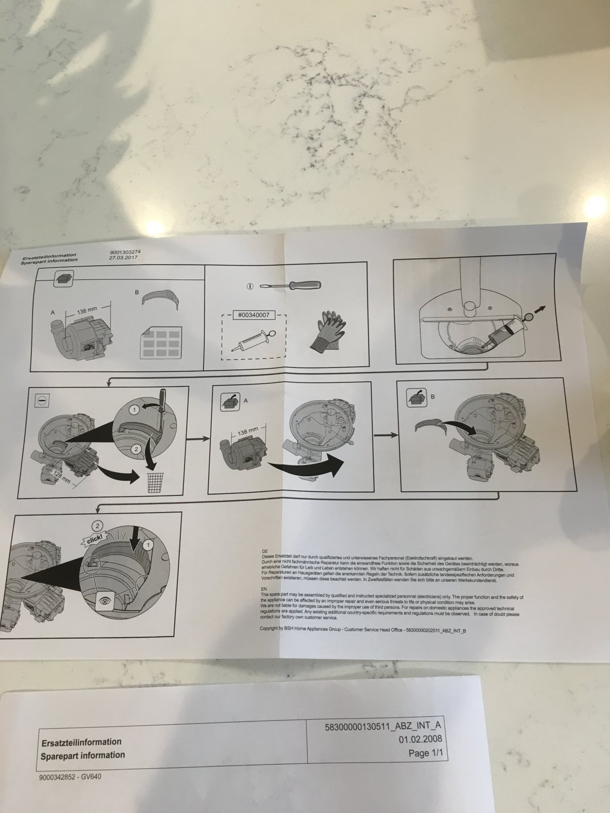

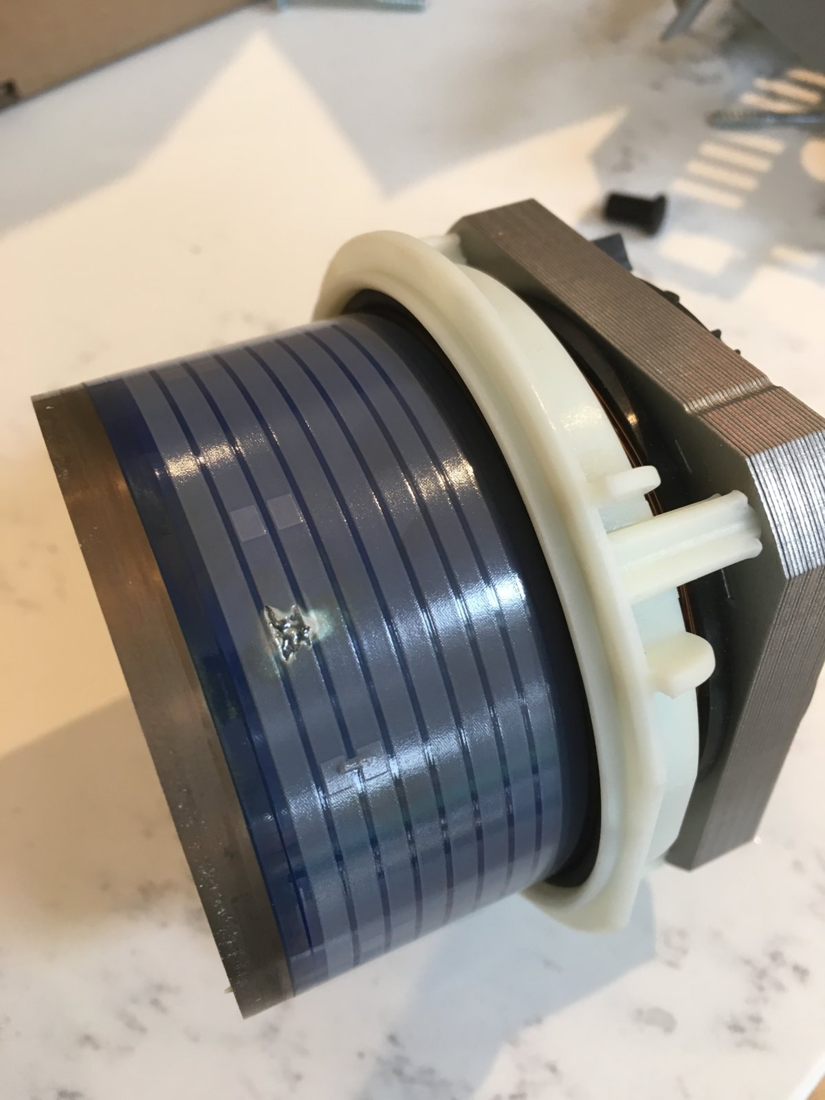

Ok , thanks again for you’re knowledge on this , parts ordered .
Hi ,
Part came in the week from neff £75ish .
Managed to have look today and do the swap over . E voila , piping hot again
Quite straight forward to replace, but could not of done it without you’re help , so many thanks .
I’ve run one cycle right through and no tap icon flashing .
I have posted a few pics of the parts , and there was a good you tube video to show the process on how to swap over .
There is also a picture of the damage on the faulty part .
